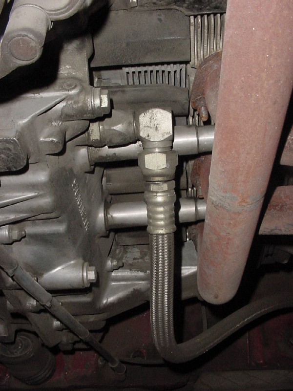

John
post Jan 20 2005, 12:39 AM
member? what's a member?
Posts: 3,393
Joined: 30-January 04
From: Evansville, IN (SIRPCA)
Member No.: 1,615
I said I would post a pic of an oil line with fittings. Here is the return line connected to the engine case.
It is a -12 (or 3/4") line.
The 90 degree swivel as well as the metric o-ring to hydraulic fitting (JIC) adapter were all supplied by the hydraulic hose shop.
They are all steel fittings.
