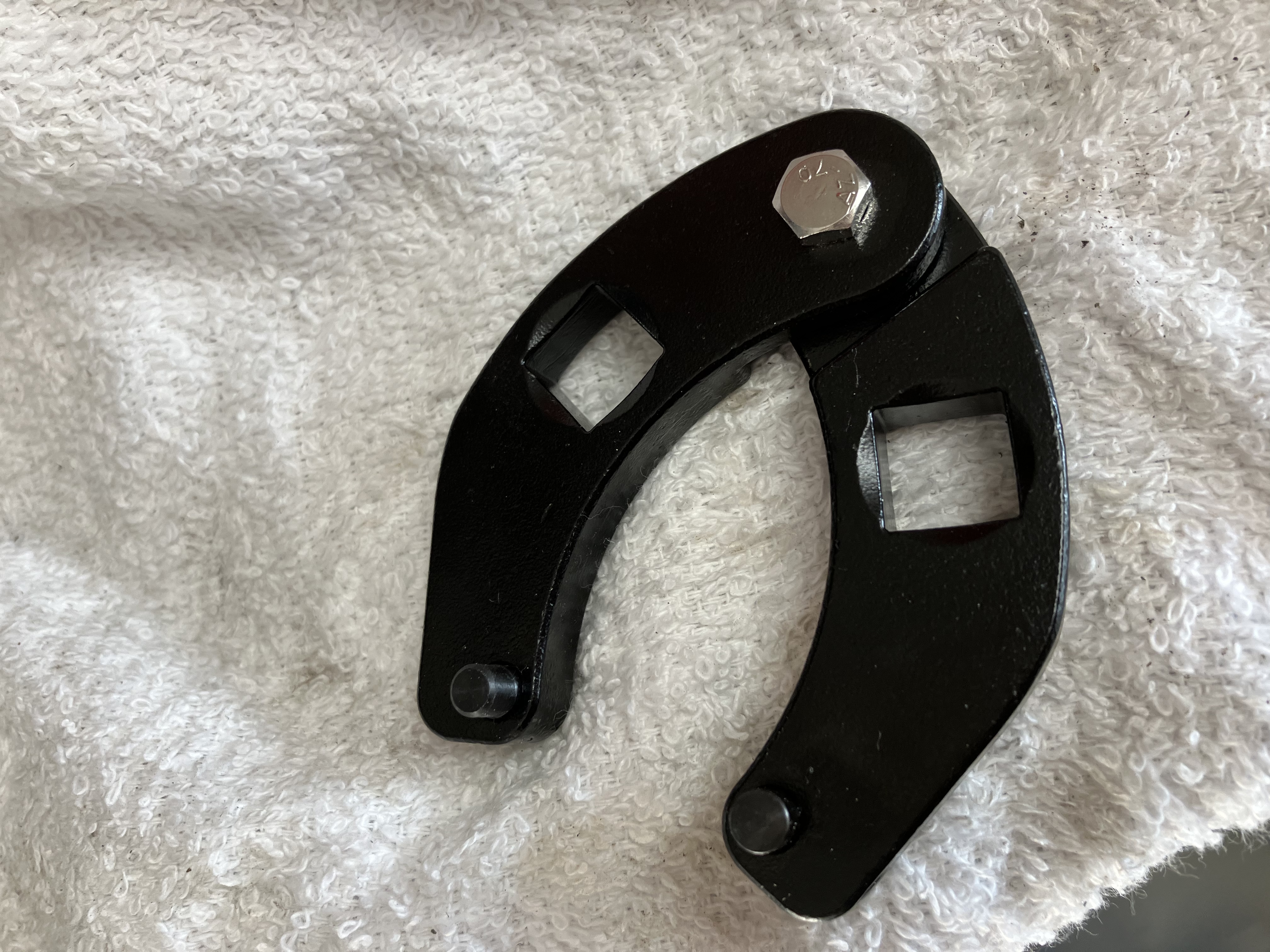

Got this adjustable gland nut wrench for $10.50 free shipping.

914 RZ-1   I bought both the tool from JimmyT and the wrench ...   Feb 13 2023, 10:16 PM
Van B   Thank you for posting that up! You just saved ...   Feb 13 2023, 10:19 PM
76-914   Got this adjustable gland nut wrench for $10....   Mar 13 2023, 08:54 AM
mepstein   Got this adjustable gland nut wrench for $10...   Mar 13 2023, 09:05 AM
76-914   Got this adjustable gland nut wrench for $1...   Mar 13 2023, 09:50 AM
