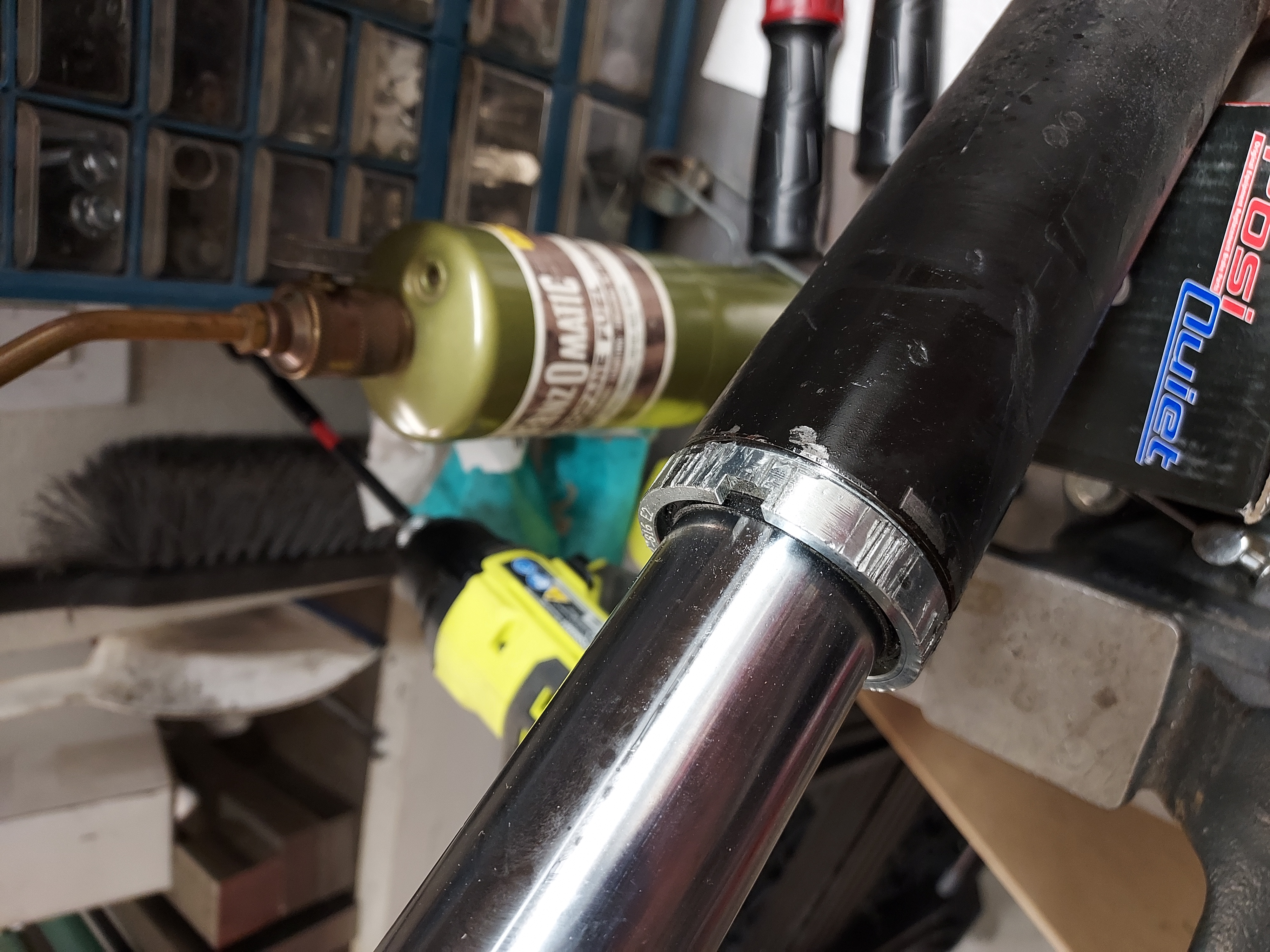

I'm trying to remove the nut that hold the shock in place. I need to replace the strut.
Click to view attachmentI've tried heat, but maybe it wasn't hot enough. How hot do I get it?
I'm using an 18" pipe wrench. It's the same one I put it on with. I changed the shocks about a year ago. It will not budge. It's hard to put leverage on when it's in the vise. I even hit the wrench with a dead blow hammer. It's currently soaking in penetrating oil.
I tried using a drift and hammer to break it loose. Didn't budge.
The next step would be to use a cheater bar on the wrench. However, I'm afraid I won't be able to hold it in the vice securely enough.
Does anyone have any other ideas?

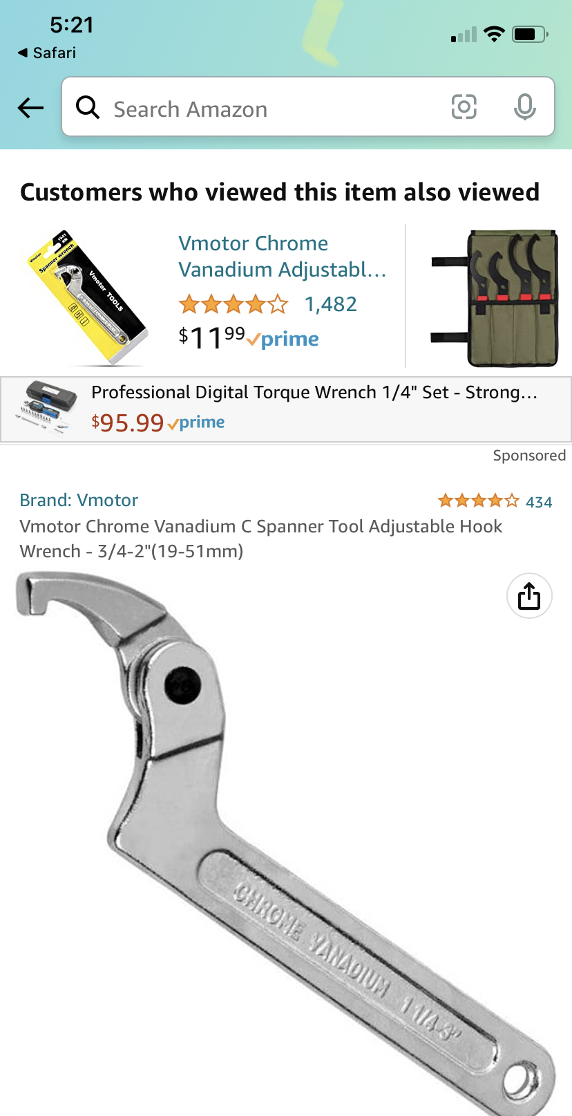

I'd prefer to use the right tool, especially since it works with a 1/2" socket. My breaker bar is 24" long and it will provide me with lots of leverage.
However, I might have to just get a hooked spanner and use that with a piece of pipe.

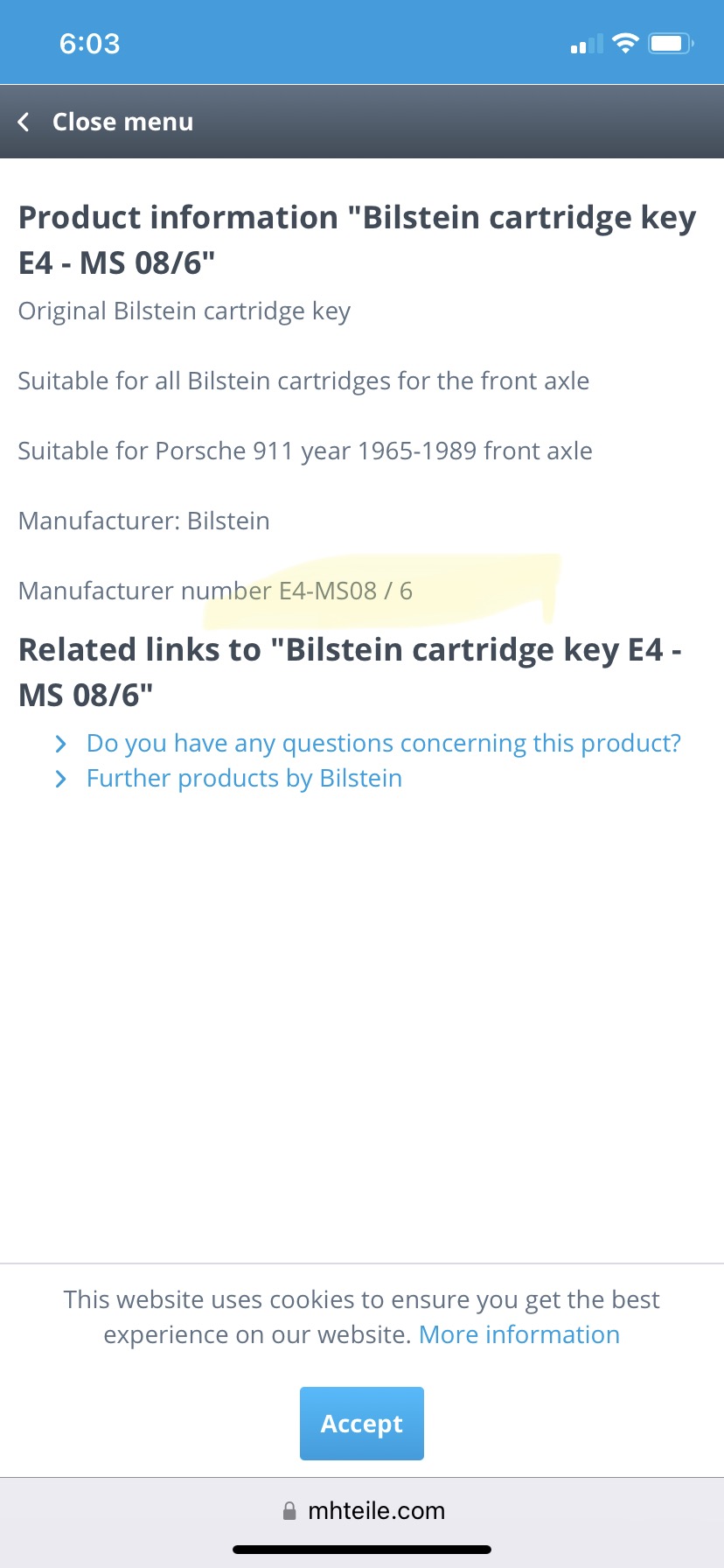

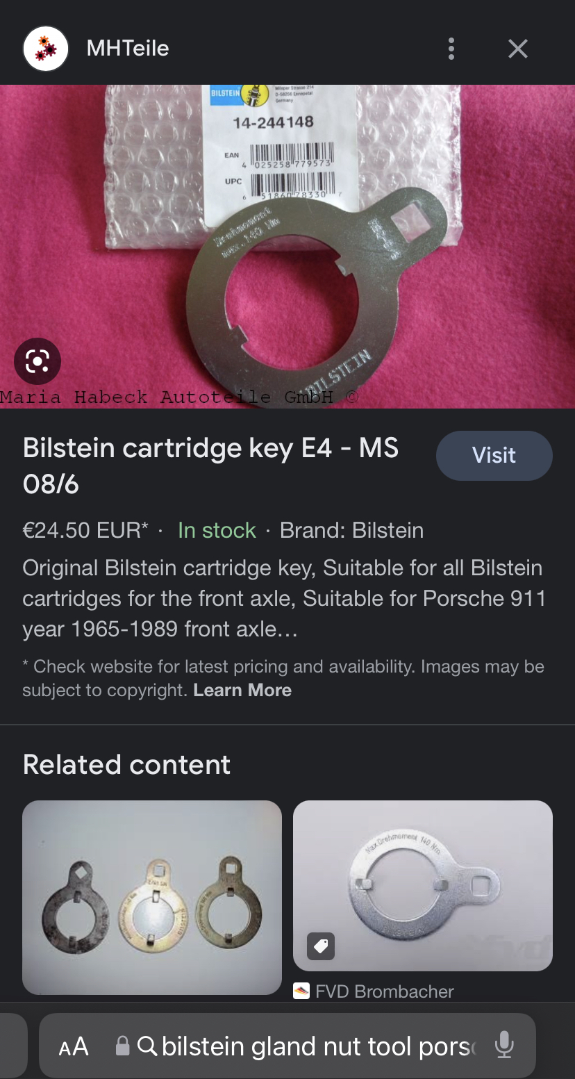

Best I’ve found - I think tool number is MS 08/6
Click to view attachment Click to view attachment
Van B
Feb 8 2023, 11:39 AM
There are basically two version floating out there when you attempt a google search: E4-MS 08/4 and 08/6. the first link thin this thread, EDO Performance, wouldn't even allow me to order the item... said it can't ship to my Maryland address. I thought $5 was worth ordering in the blind just to confirm

I bought both the tool from JimmyT and the wrench from Bilstein.
Bilstein tool is #E4-MS08/6. It's 47mm between the tabs, about 54.5mm ID (just fit around the shock tube) and 86.5mm OD. It's 4mm thick.

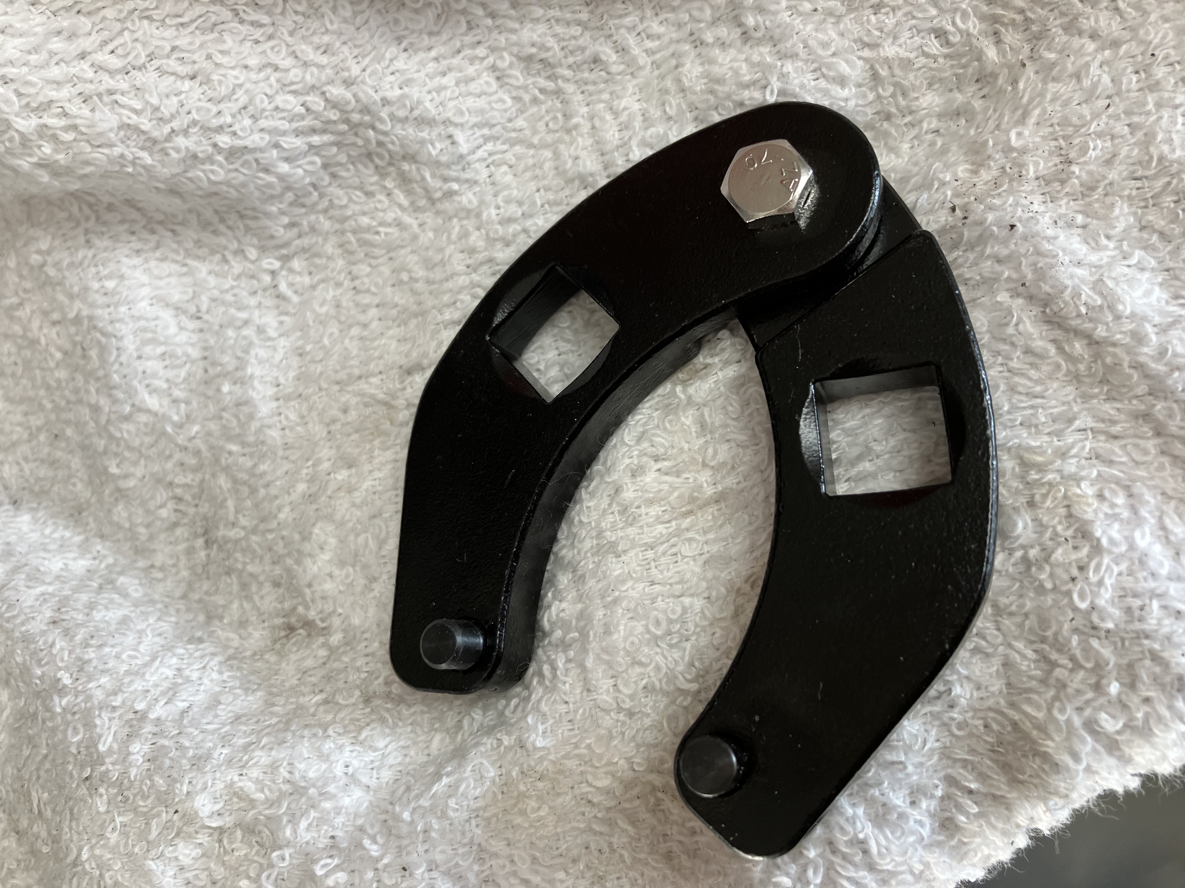

Got this adjustable gland nut wrench for $10.50 free shipping.
Mar 13 2023, 09:05 AM
QUOTE(76-914 @ Mar 13 2023, 10:54 AM)
Click to view attachmentThat looks like a good tool.
I’ve removed dozens of the gland nuts from old struts. Clamp the caliper mounting plate in a vise and twist the nut off with a large pipe wrench. Add some heat with a torch if it’s really stuck on there. Works ever time.

Being a plumbing contractor, I too have always done this but at this price I couldn't pass it up. Besides the fact that I'm a certified tool whore.
