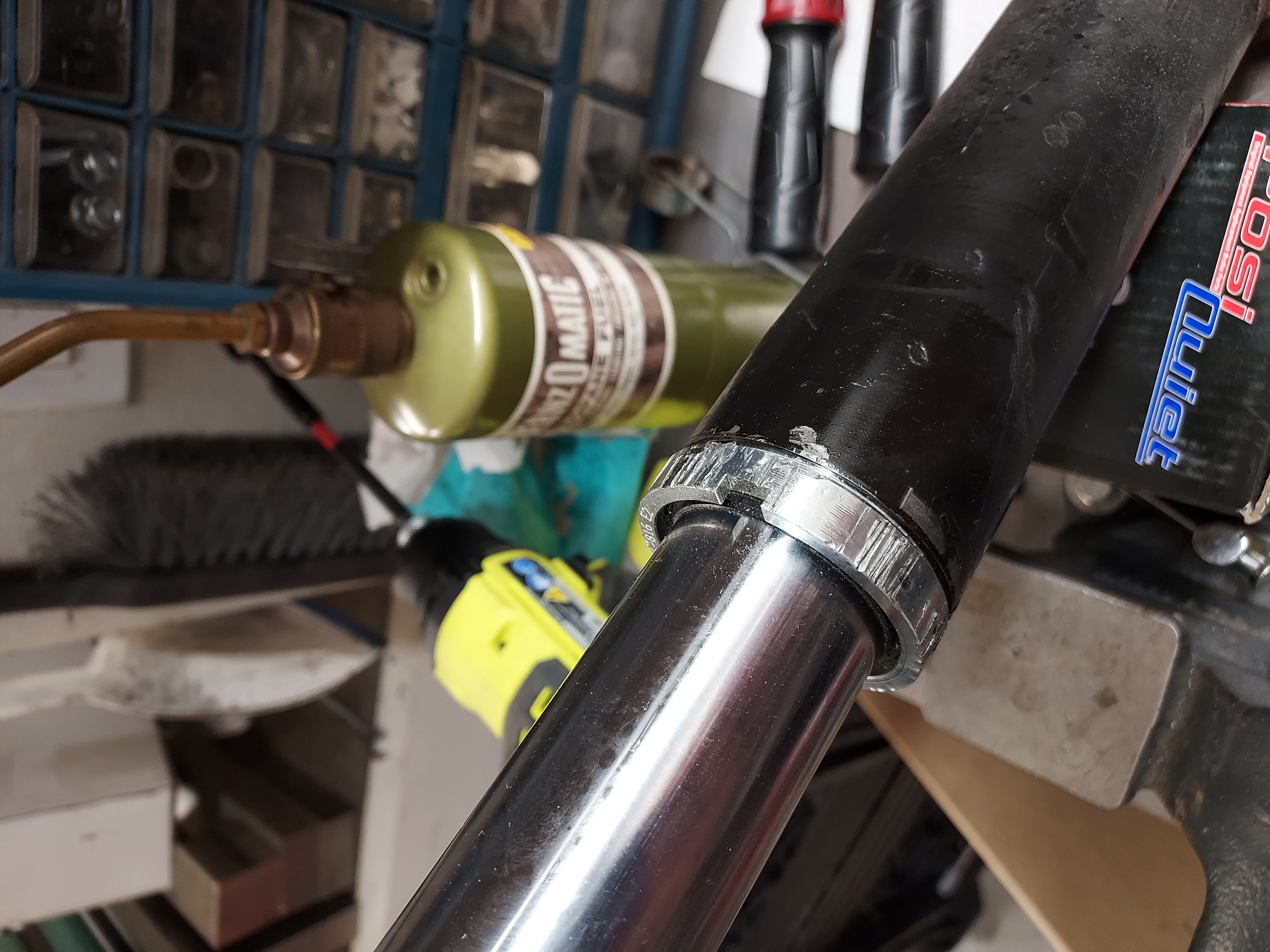

I'm trying to remove the nut that hold the shock in place. I need to replace the strut.
I've tried heat, but maybe it wasn't hot enough. How hot do I get it?
I'm using an 18" pipe wrench. It's the same one I put it on with. I changed the shocks about a year ago. It will not budge. It's hard to put leverage on when it's in the vise. I even hit the wrench with a dead blow hammer. It's currently soaking in penetrating oil.
I tried using a drift and hammer to break it loose. Didn't budge.
The next step would be to use a cheater bar on the wrench. However, I'm afraid I won't be able to hold it in the vice securely enough.
Does anyone have any other ideas?
Thanks!

Pipe wrench is working against you. As you try to loosen, the wrench is deforming and compressing the retaining ring deeper into the threads creating a bind.
This type of spanner will also work well - get right size for strut diameter and you may have to grind the hook to fit.
Be careful with the heat. Bilstein struts are gas charged monotubes and the heat will damage the internal seals of the floating gas piston. At its worst strut can explode if gas is heated too much.

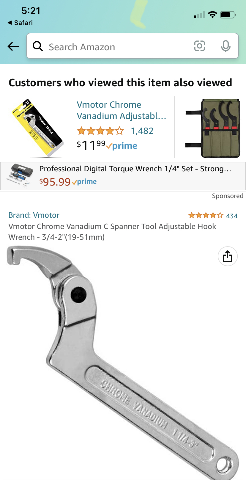

I may go the spanner wrench route, since those are more versatile.

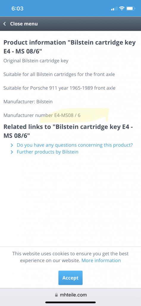

I found what appears to be the right part here:
https://www.mk1autohaus.com/Bilstein-Strut-...7mm_p_8039.html
But when I went to my cart, it took me to a page that redirected me to an Ebay store that is no longer active. No credit card info was entered, but I thought it was odd.
I think the dimension refers to the inside distance between the two tabs.
Prices are all over the place and most sites have no info about the dimensions.
I'd prefer to use the right tool, especially since it works with a 1/2" socket. My breaker bar is 24" long and it will provide me with lots of leverage.
However, I might have to just get a hooked spanner and use that with a piece of pipe.

Just be aware that the hooked spanners can slip off the hook especially when a pipe gets involved and you really start reefin’. They like a perfectly straight pull. Ask me how I know. (IMG:style_emoticons/default/sad.gif)

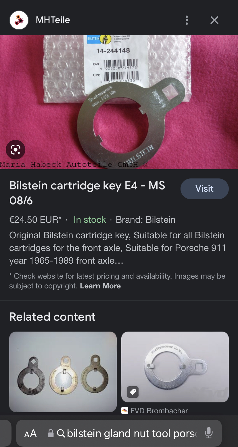

(IMG:style_emoticons/default/dry.gif) - would be funny if not so sad that suppliers can’t be bothered to actually state what diameter strut tube the Bilstein tool is for or to at least confirm it is for 914/911 sized struts. Pricing is all over the map too. Sierra Madre sells them which you would assume would be for 911/914 but they also have a little foot note that you may have to modify the tool - Really?
Who wants to pay $50 for a simple stamped tool only to find out it doesn’t fit and needs to be modified when it appears the next guy is selling the same tool for $15.
I also see Summit sells a Bilstein branded 60mm spanner wrench but that appears to be for adjusting coil over spring perches. Would probably work.
I suspect Bistein will come to his aid with a proper tool number.

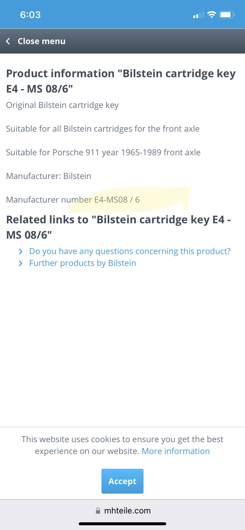

Best I’ve found - I think tool number is MS 08/6

There are basically two version floating out there when you attempt a google search: E4-MS 08/4 and 08/6. the first link thin this thread, EDO Performance, wouldn't even allow me to order the item... said it can't ship to my Maryland address. I thought $5 was worth ordering in the blind just to confirm
