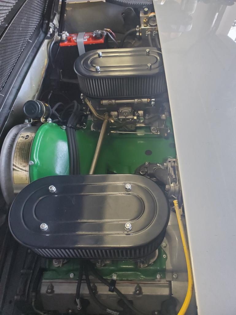

nditiz1   Slotty from this angle it looks like that positive...   Mar 18 2023, 11:11 AM
slotty008   Slotty from this angle it looks like that positiv...   Mar 18 2023, 11:48 AM
