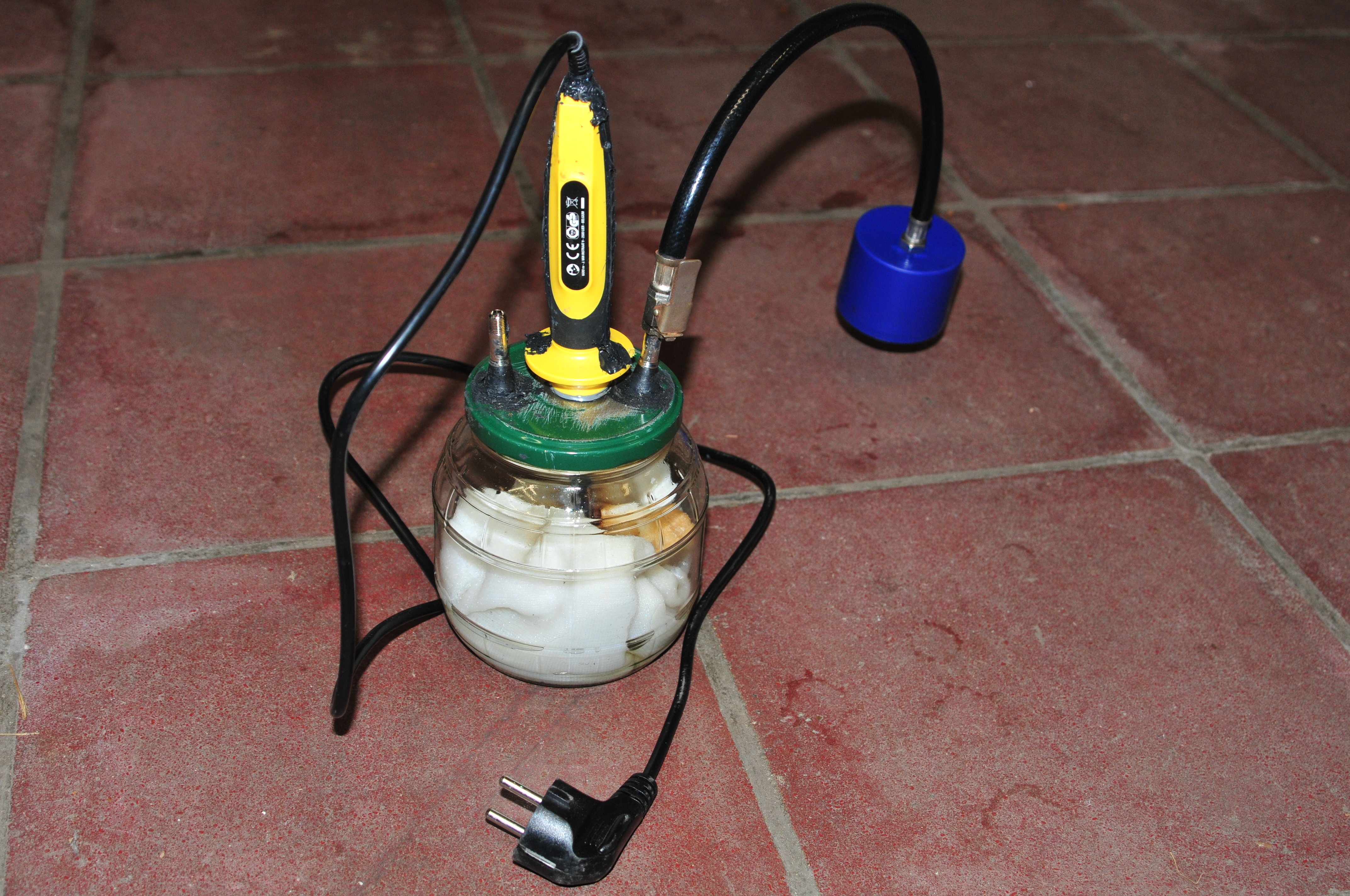

Now that I'm retired, I've finally found the time to finish the smoke machine. I used a pickle jar, 2 car valves, an old bicycle pump, a 10€ soldering iron and an old tube from a tire pressure pump. I had to seal the car valves and the soldering iron with Tec-7 because too much smoke escaped there. I mounted a lid from an aerosol can on the tube of the tire pressure pump. It fits exactly on the throttle body. (IMG:style_emoticons/default/smilie_pokal.gif) Yesterday we did the test and a little smoke is escaping along the axle of the throttle valve. So I will have to look for a better throttle body or find someone to repair it. All the vacuum lines were tight.
