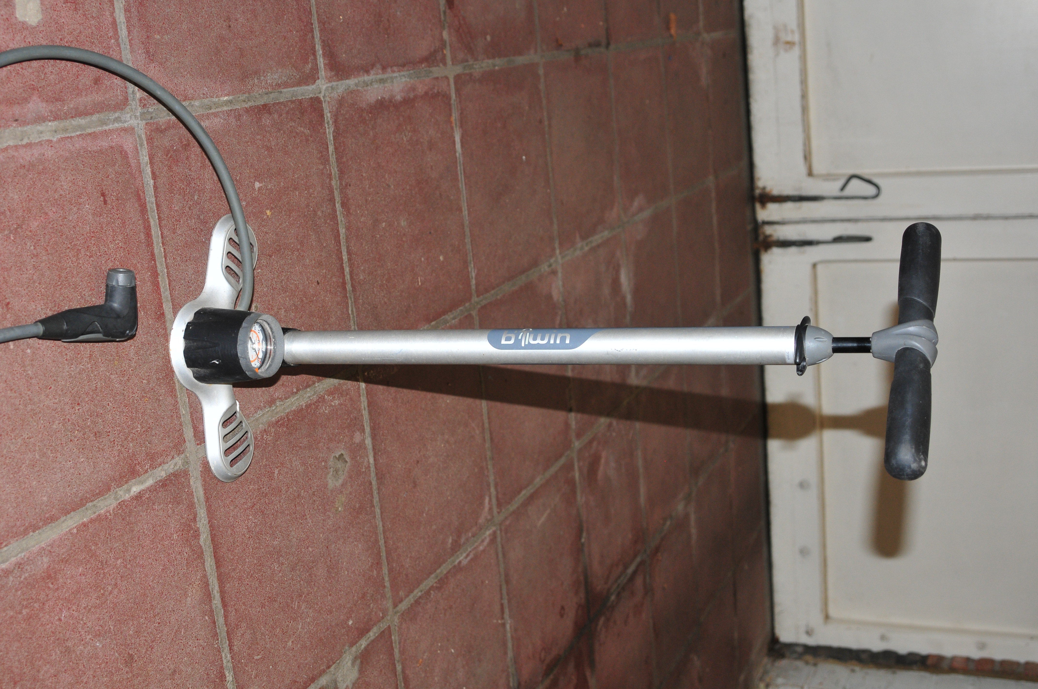

slotty008   After disassembling the AAR several times, I gave ...   Mar 24 2024, 09:23 AM
slotty008   Here it is installed.   Mar 24 2024, 09:25 AM
slotty008   I've put a box on it to protect it. The bottom...   Mar 24 2024, 09:28 AM
slotty008   And this is the knob in the cockpit.   Mar 24 2024, 09:33 AM
