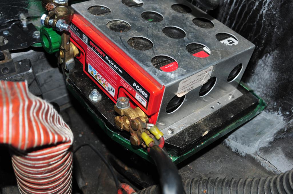

I have the PC680 since 2 years now. It's very light and the car starts every time from the first time. But I always disconnect the battery if i don't drive the car for more than a week and from time to time I use a battery tender since the weather here in Belgium is too bad to drive a lot during wintertime.
To disconnect the battery I have the little green wheel at the negative of the battery. Very easy to install and very cheap. I also had to buy a bracket to hold the battery in place. Until now , I'm very happy with it. I have no radio and no AC, probably you will need a bigger battery or a really good alternator if you have them and use them a lot.
I only did this to reduce weight and I think the AGM's keep their charge longer ( when disconnected).

nditiz1   Slotty from this angle it looks like that positive...   Mar 18 2023, 11:11 AM
slotty008   Slotty from this angle it looks like that positiv...   Mar 18 2023, 11:48 AM
