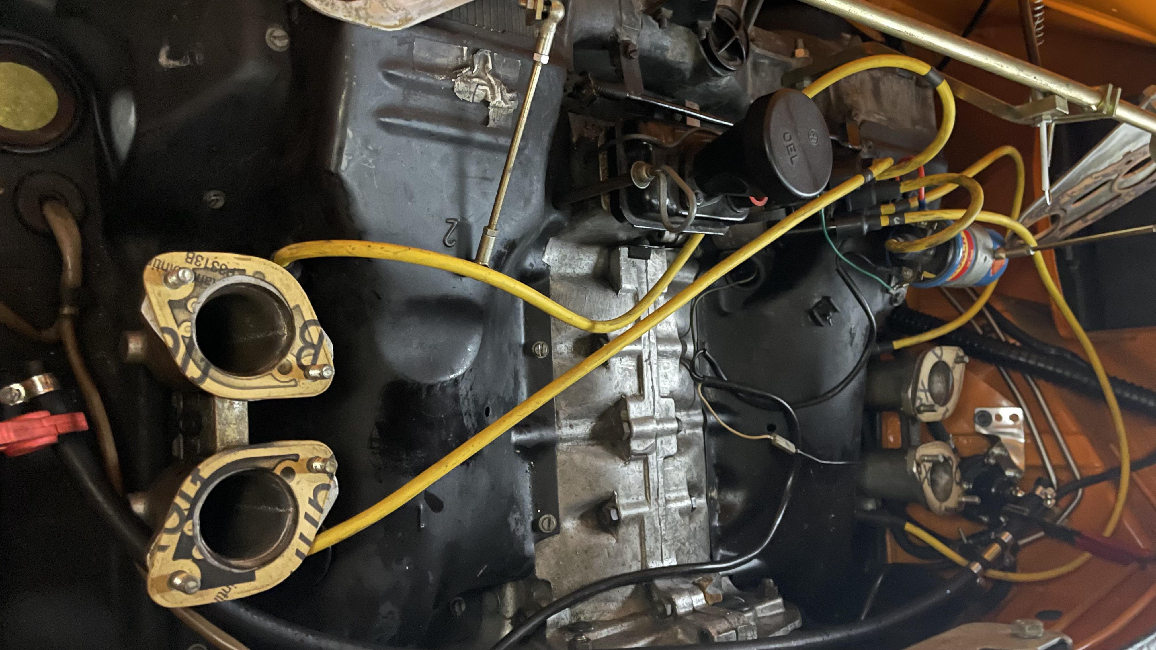

Before he left he yanked these off. Probably so I couldn't mess with it while he was gone. (IMG:style_emoticons/default/smash.gif)
not sure why plug wire #1 is so tight?

ChrisFoley   not sure why plug wire #1 is so tight? Switch...   Mar 19 2023, 03:27 AM

Dave_Darling   That distributor does not look to be in the right ...   Mar 19 2023, 07:51 PM
bobboinski   Distributor cap looks to be wired wrong. Or maybe ...   Mar 19 2023, 09:02 PM
VaccaRabite   Your dizzy is all sorts of awkward in that picture...   Mar 19 2023, 09:13 PM

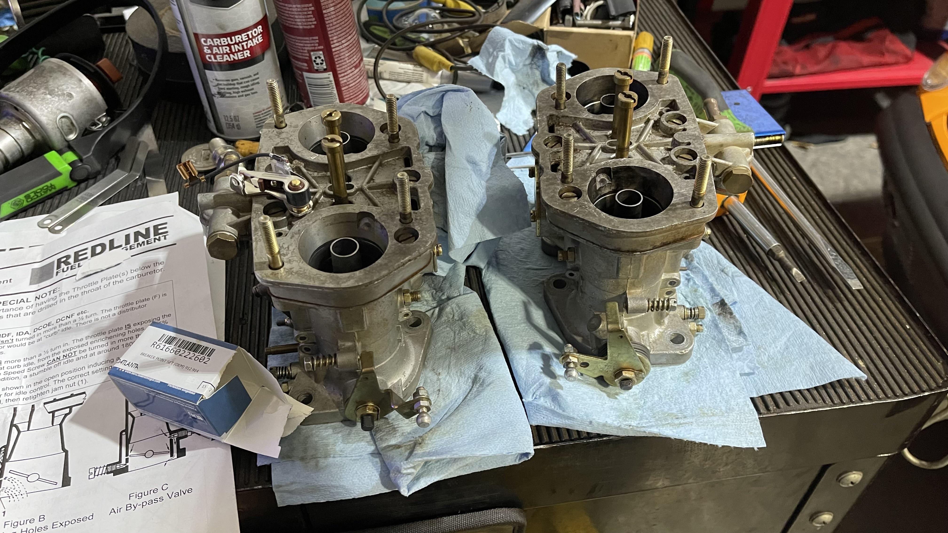

Superhawk996   Now that the carbs have been removed - you’re go...   Mar 20 2023, 08:35 PM
Type 47   Now that the carbs have been removed - you’re g...   Mar 20 2023, 09:18 PM

nditiz1   If the car pops stutters backfires at IDLE here ar...   Mar 21 2023, 09:29 AM
Type 47   Idle circuit is dirty - are the carbs clean? Ha...   Mar 21 2023, 02:56 PM
