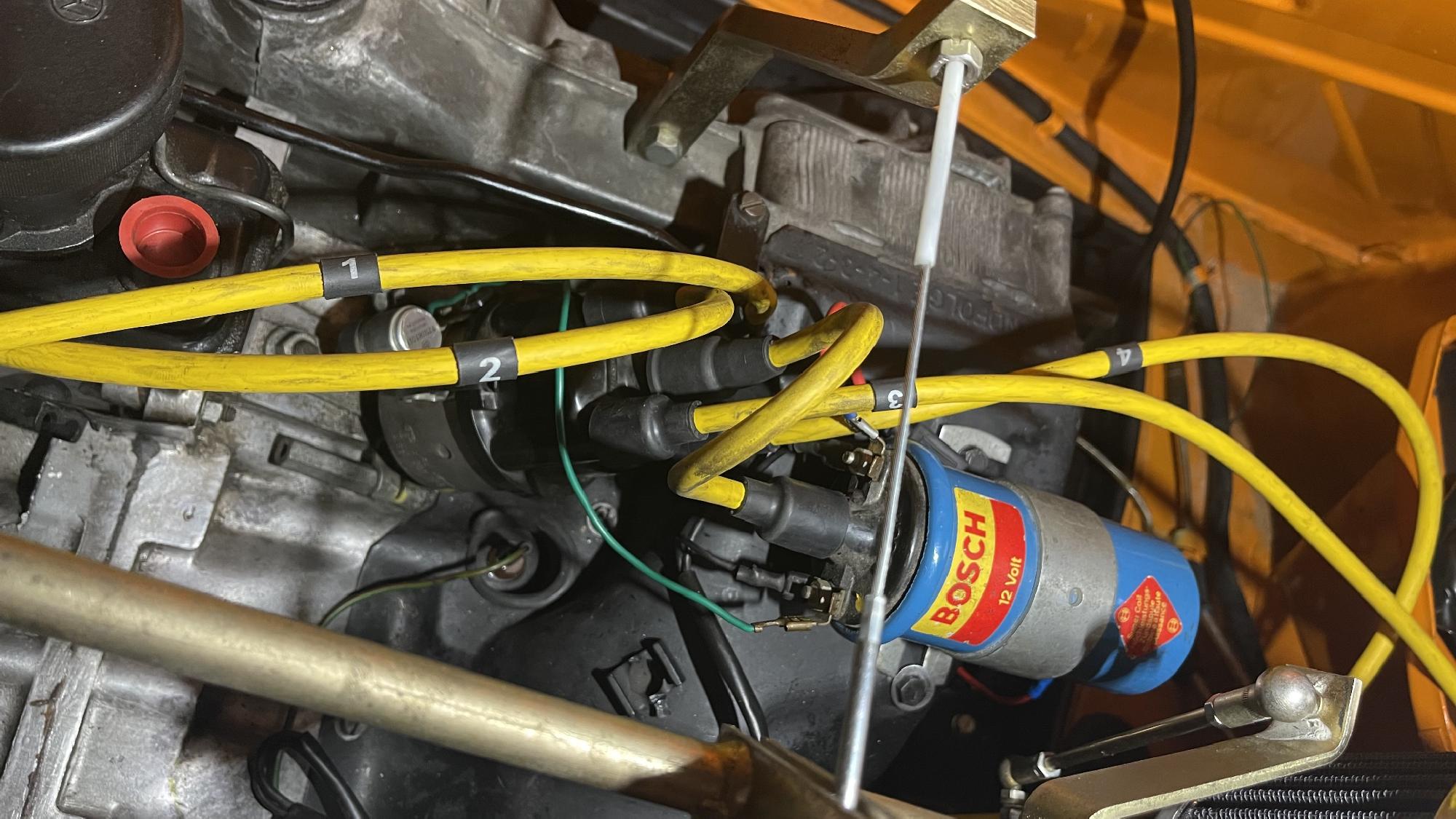

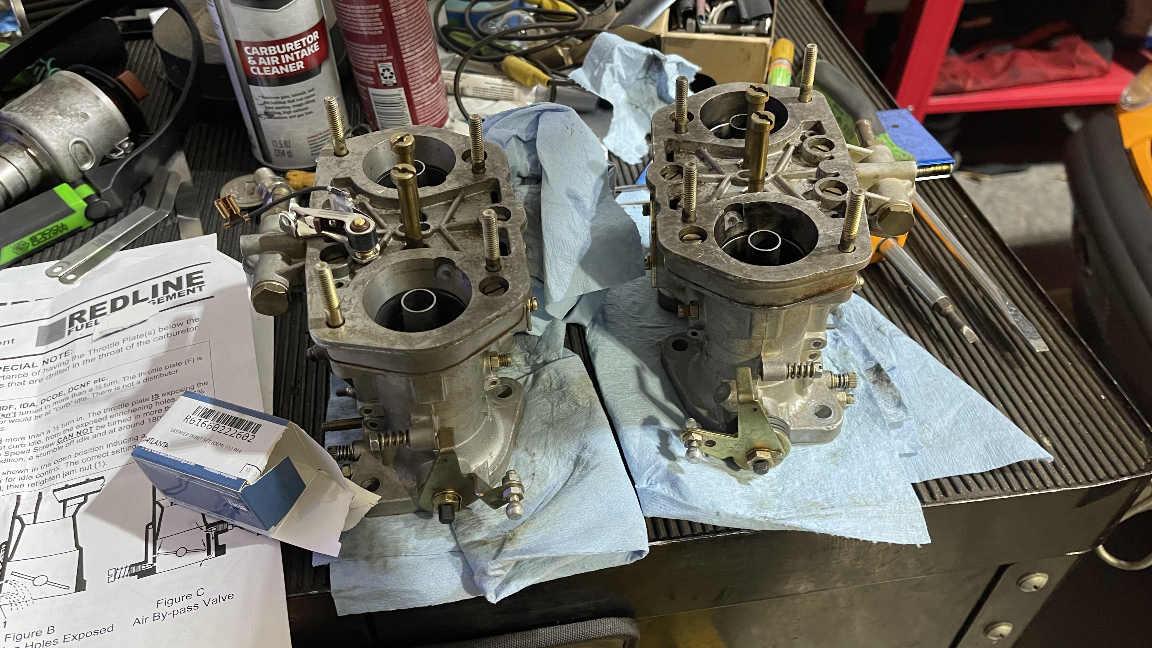

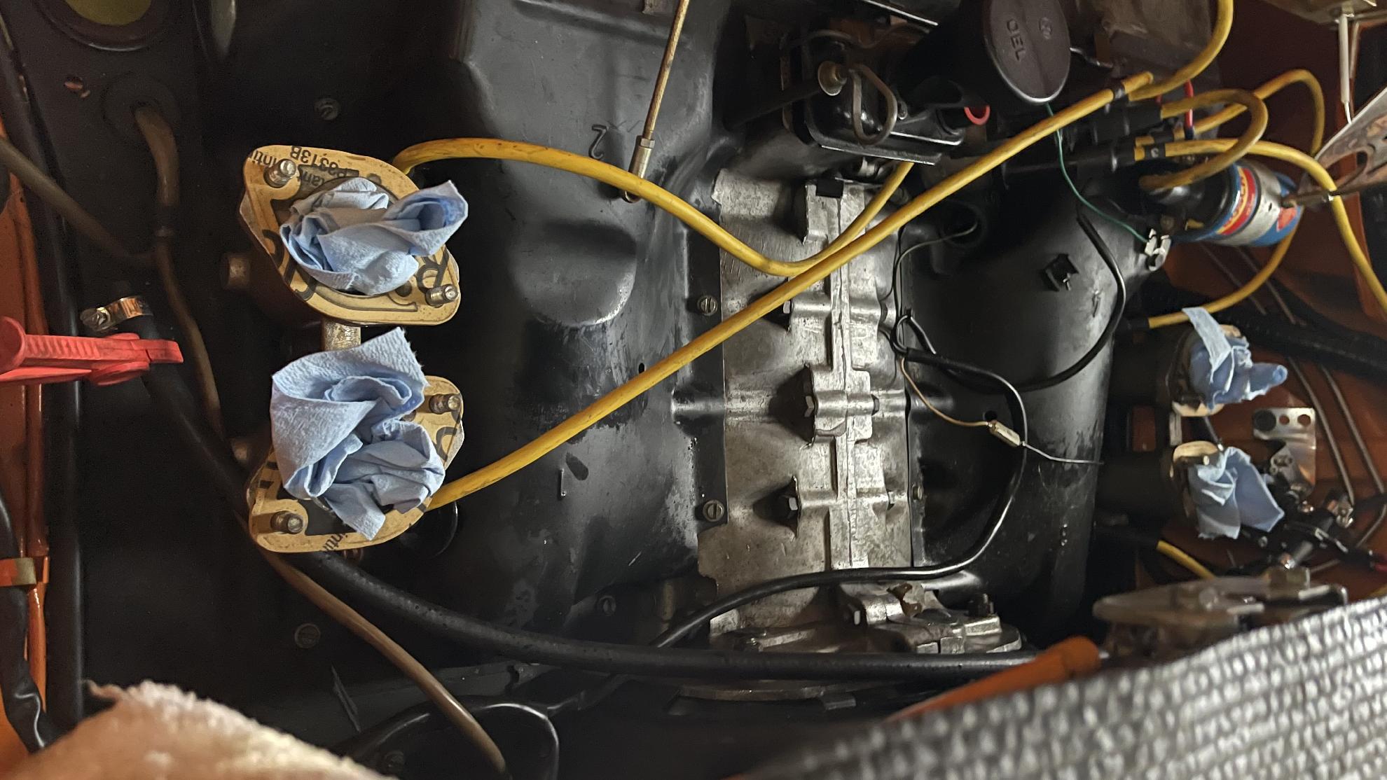

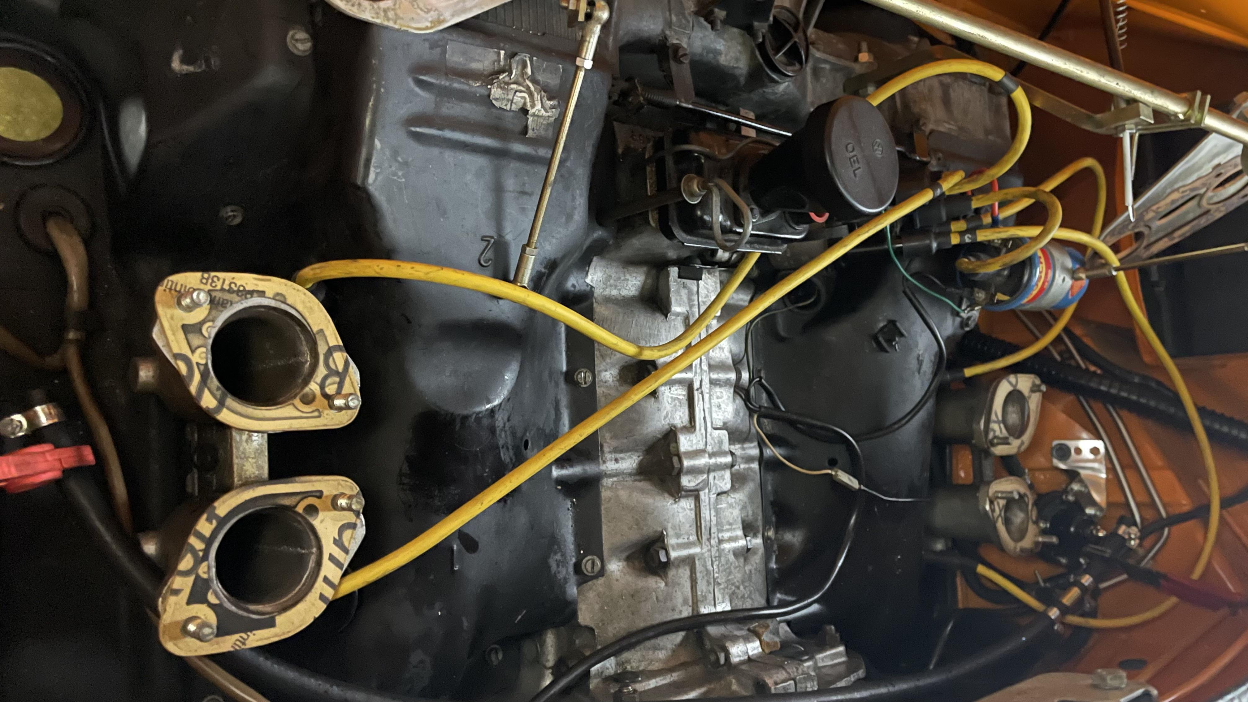

Before he left he yanked these off. Probably so I couldn't mess with it while he was gone. smash.gif
not sure why plug wire #1 is so tight?
Switch wires 1 and 2 for a better fit.
It is also possible to re-clock the distributor by lifting out the drive gear and rotating it before dropping it back in.

I would plug up the open holes (intake manifolds) asap to keep anything from falling into a cylinder. rag, paper towel, ...

Dave_Darling
That distributor does not look to be in the right position. It looks about 90 degrees off to me... Could be the wires are plugged in wrong, could be the whole distributor body is rotated wrong.
You should triple-quadruple check the distributor position and the plug wire locations.
--DD
bobboinski
Distributor cap looks to be wired wrong.
Or maybe the distributor is rotated 90 degrees or more clockwise.
Or both.
I think your vacuum can should be about where the condenser is in the picture in post #1.
At least that is how it is on my 1.7 and 2.0. Maybe 1.8 is different...Never worked on one.
VaccaRabite
Your dizzy is all sorts of awkward in that picture. It’s either wired wrong or it’s 180 out. Either way, this is the cause of your issue.
Give it some gas and you will blow some impressive fireballs out the tops of your carbs this way. BTDT.
Zach

Now that the carbs have been removed - you’re going to have to work your way back through balancing airflow in each barrel, setting idle mixture, setting idle speed and then synchronizing the two carbs.
Have you done that?
Also what are the Venturi sizes and jets that you’re working with?
Type 47
QUOTE(Superhawk996 @ Mar 20 2023, 06:35 PM) *
Have you done that?
Why would we have to do that? Kid took them off...I made him put them back on. Nothing changed except making sure they were good and tight.
Airflow is a final adjustment we were almost there when things went south.
you make it seems so simple. I get the synch'n the carbs, but i'm kind of lost at idle mixture/speed.
