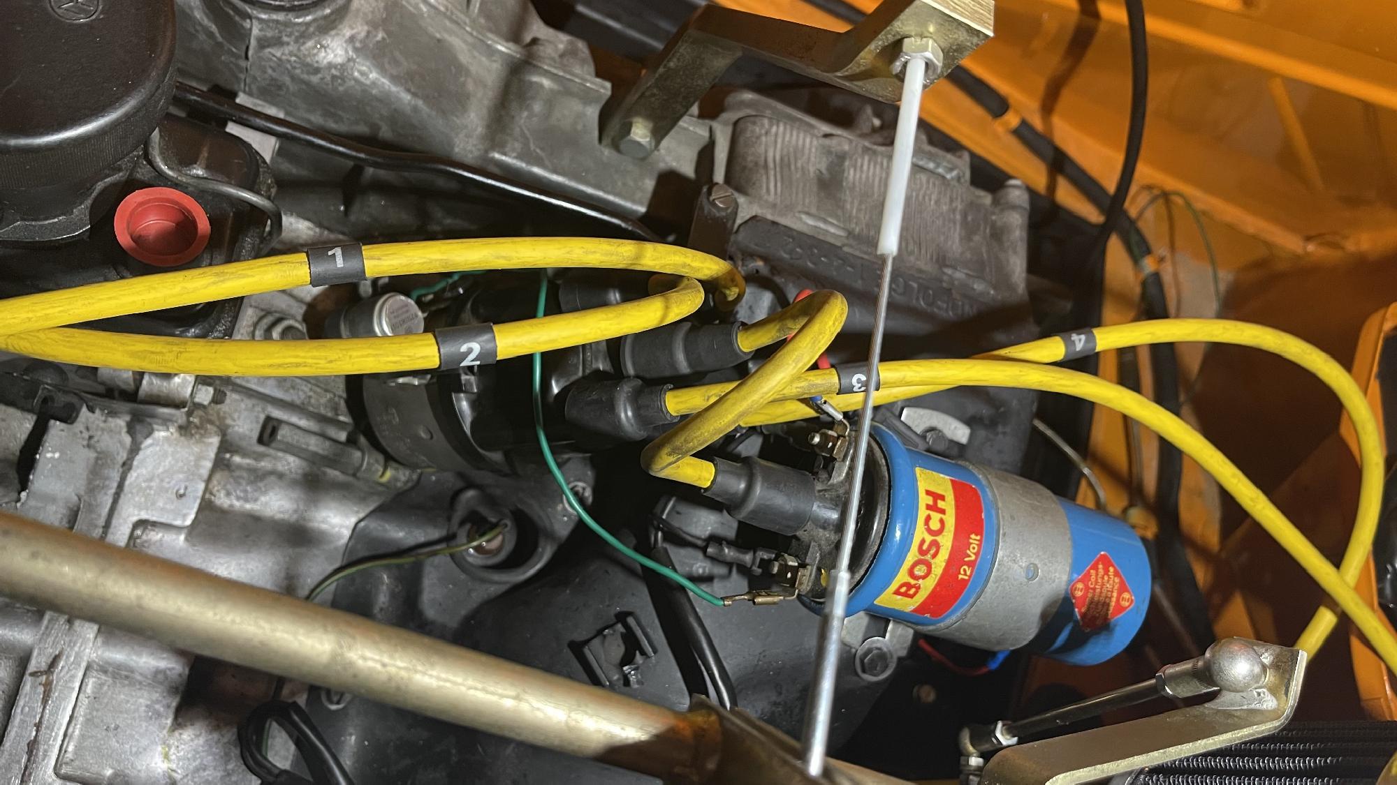

Dave_Darling   That distributor does not look to be in the right ...   Mar 19 2023, 07:51 PM
bobboinski   Distributor cap looks to be wired wrong. Or maybe ...   Mar 19 2023, 09:02 PM
VaccaRabite   Your dizzy is all sorts of awkward in that picture...   Mar 19 2023, 09:13 PM

ChrisFoley   That red line on your impeller is the 27 degree ma...   Mar 22 2023, 05:23 AM
