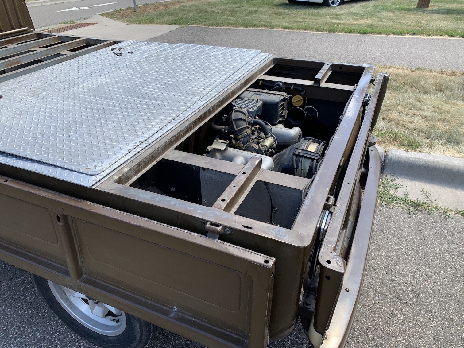

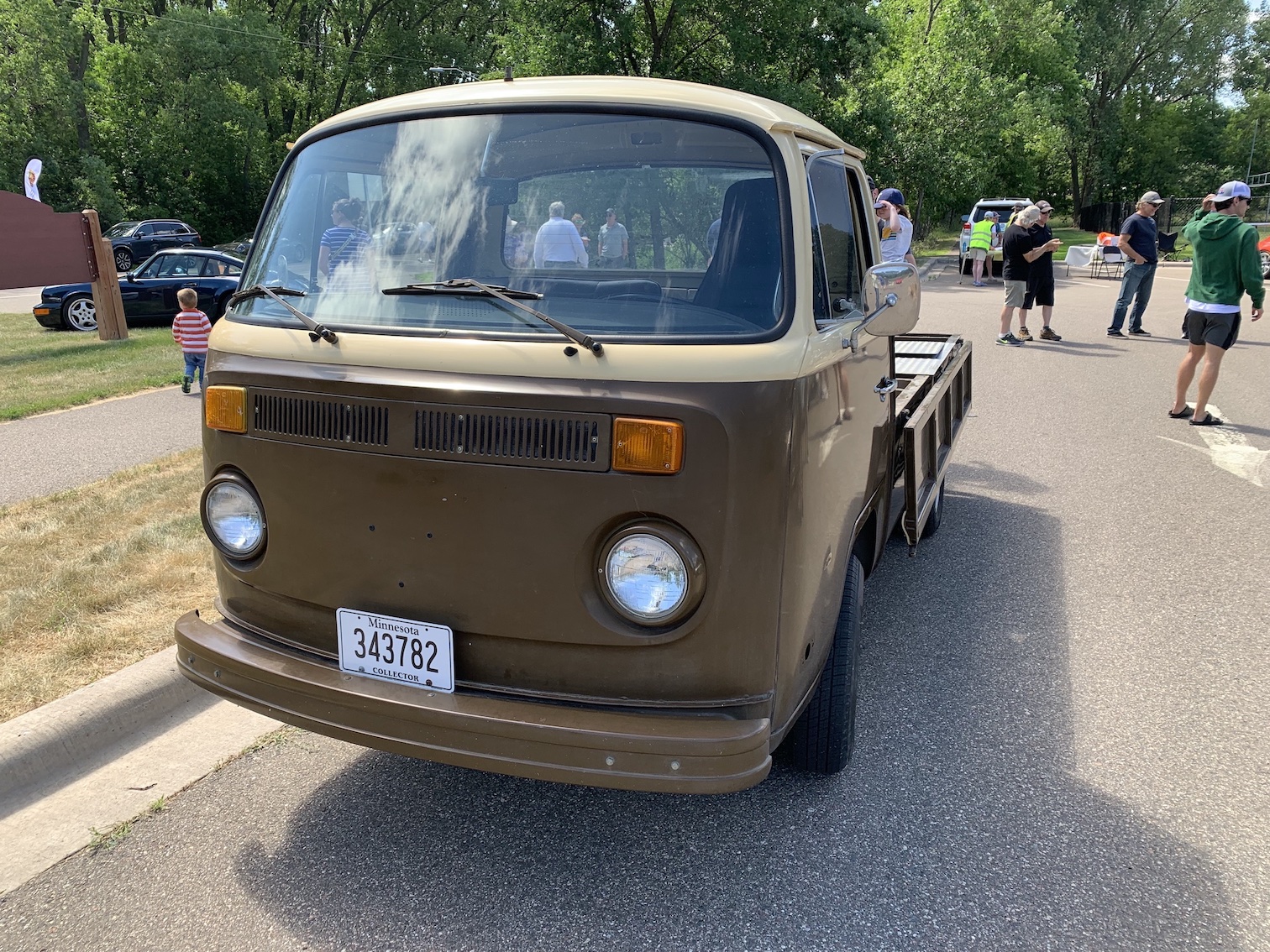

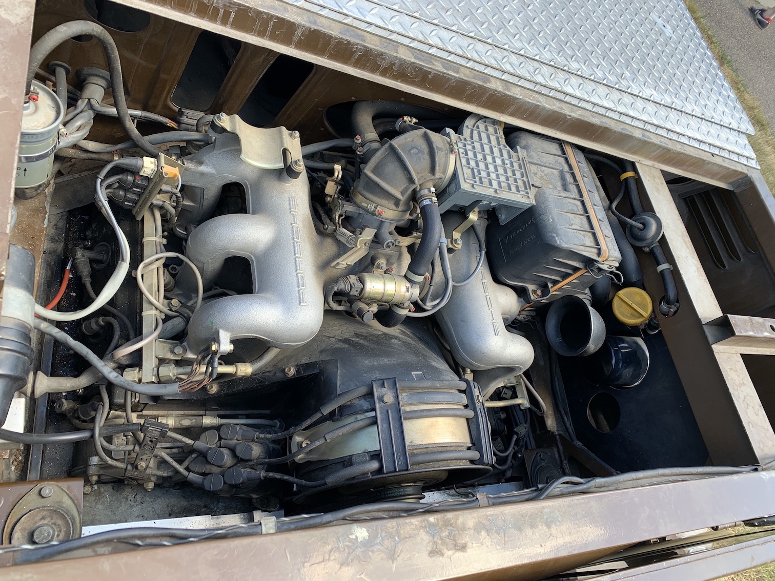

Food for thought (IMG:style_emoticons/default/idea.gif)
This was at Nord Stern Region's outdoor show last summer.

anderssj   Food for thought :idea: This was at Nord ...   Mar 21 2023, 08:08 AM
