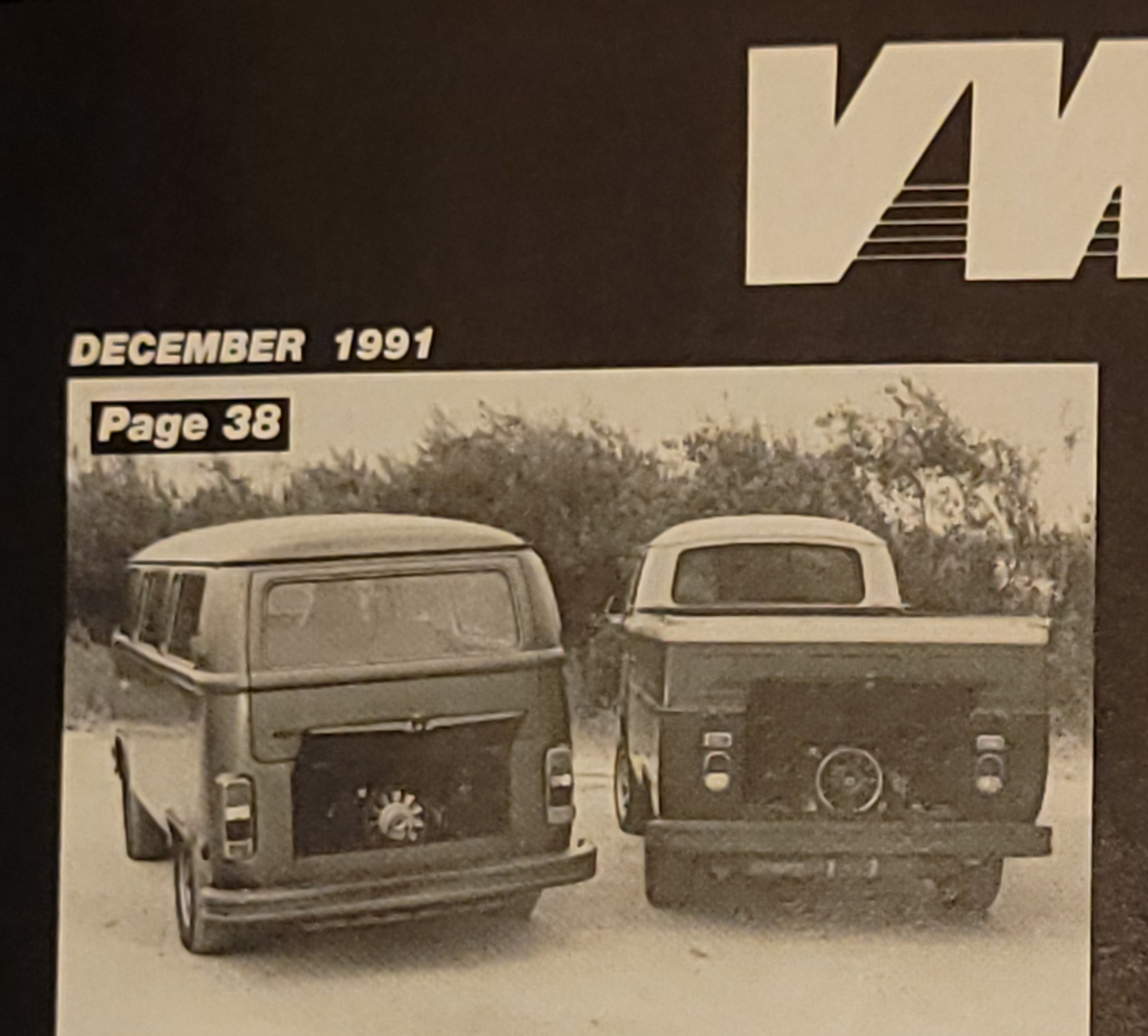

The 1968 single-cab was formerly used as a Shopping-cart retrieval vehicle !

Maltese Falcon   "VW Trends" magazine, Dec. 1991; Dieter ...   Mar 22 2023, 10:18 PM
Maltese Falcon   The 1968 single-cab was formerly used as a Shoppin...   Mar 22 2023, 10:21 PM
Maltese Falcon   Few more from the article, pic 6B shows a very sho...   Mar 22 2023, 10:26 PM
Maltese Falcon   Last of the article pics...911 gauges on a custom ...   Mar 22 2023, 10:29 PM
