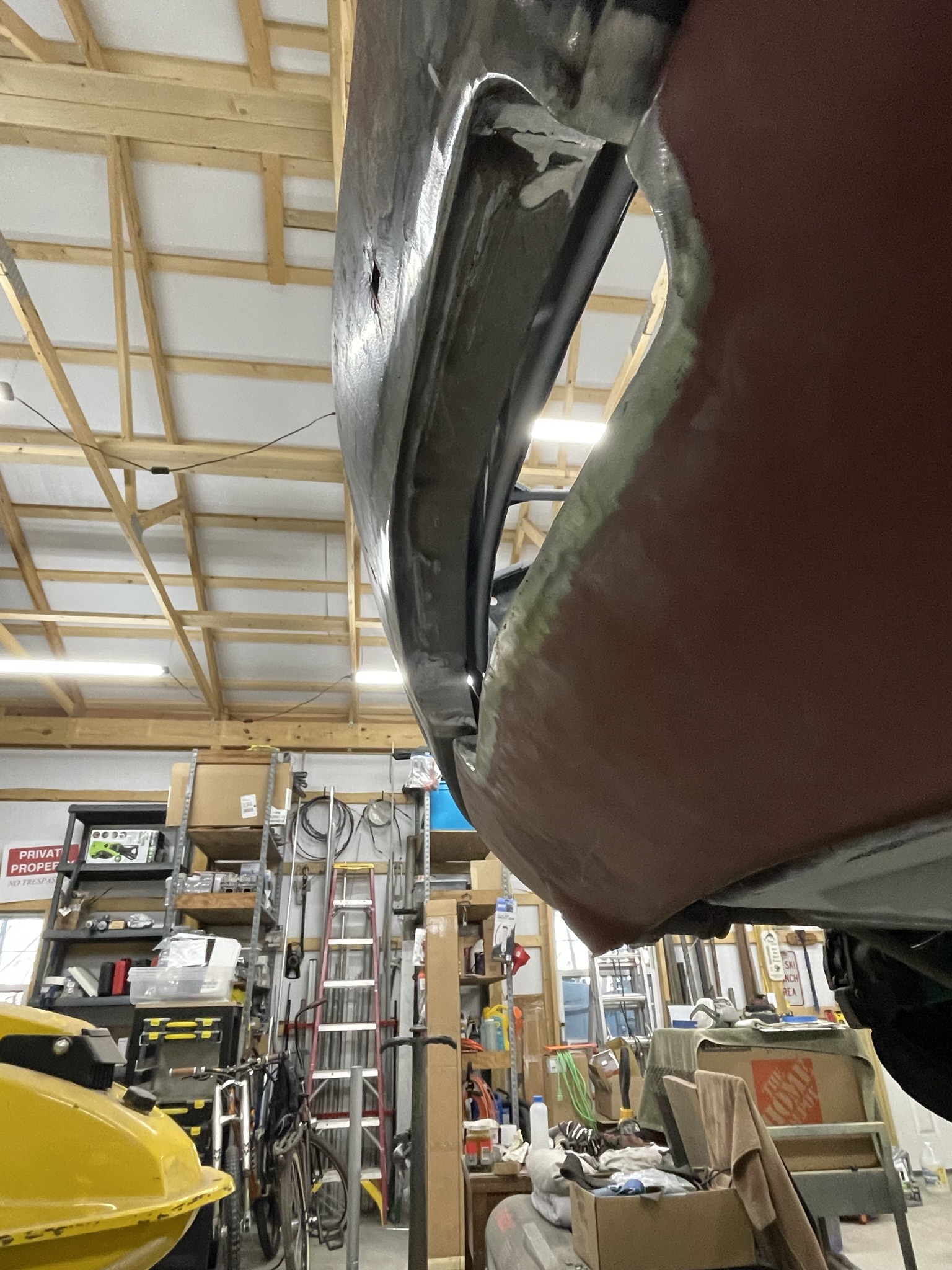

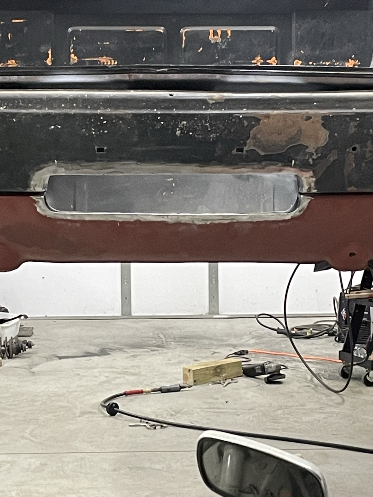

East coaster   Picked up a stock front valance in nice shape and ...   Mar 15 2023, 07:54 PM
East coaster   Did the same treatment to the bumper…….radiato...   Mar 23 2023, 07:52 AM
