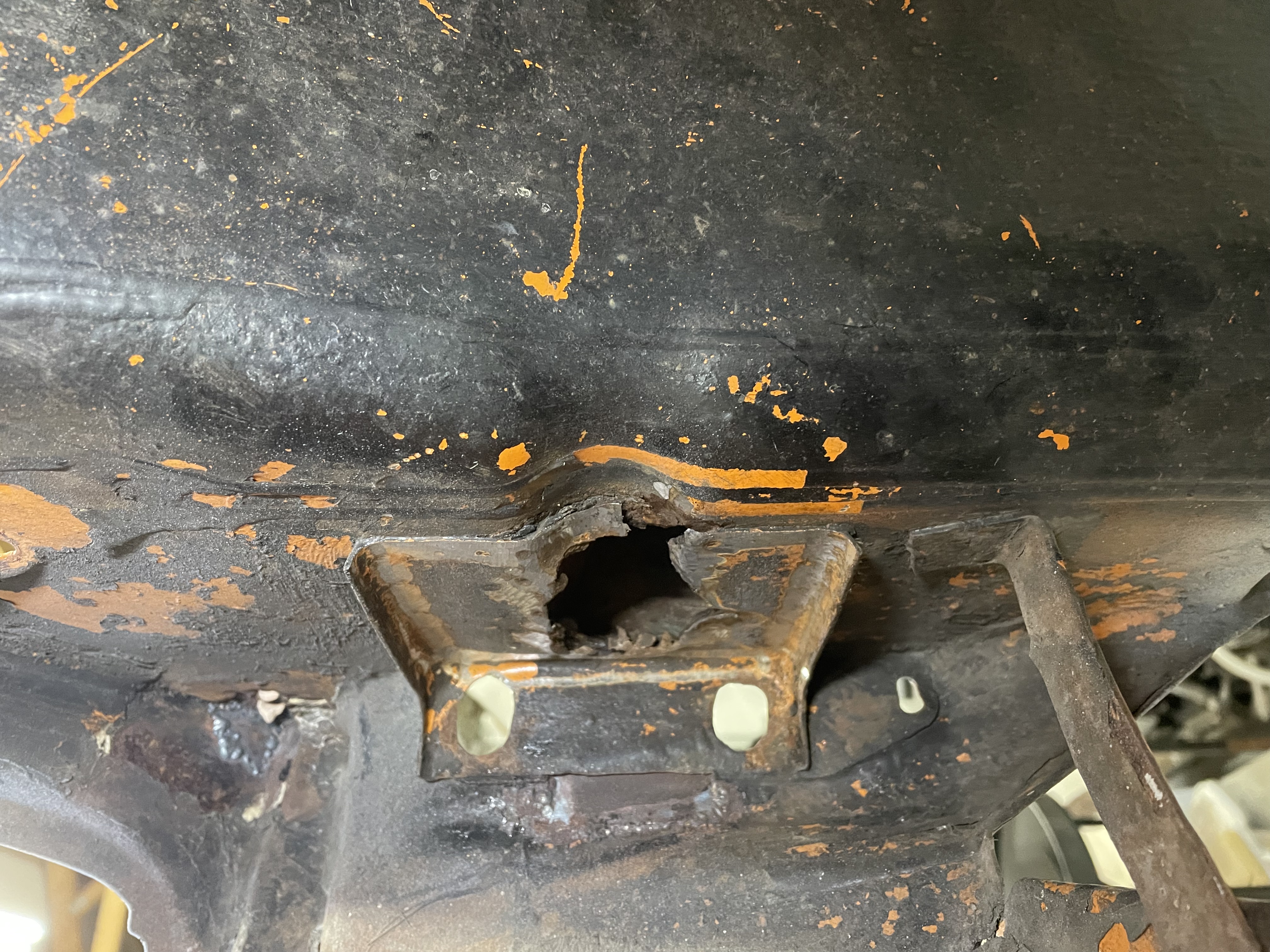

I saved the sh*ttiest task for last……had to repair some pretty bad rust at the front bumper mounting areas. There were sizable holes through to the headlight bucket area. Fabricated some patch panels and made it strong again. This area just sux because there’s no room to work it at all.

East coaster   I saved the sh*ttiest task for last……had to re...   Mar 23 2023, 06:47 PM
East coaster   Patch welded in…..   Mar 23 2023, 06:50 PM
East coaster   Passenger side was worse and required 2 patch piec...   Mar 23 2023, 06:51 PM
