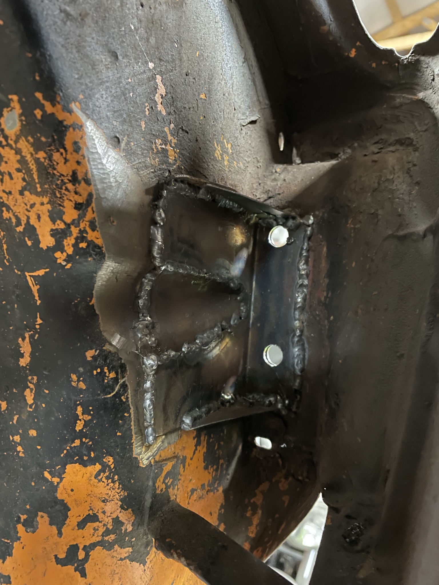

East coaster   I saved the sh*ttiest task for last……had to re...   Mar 23 2023, 06:47 PM
East coaster   Patch welded in…..   Mar 23 2023, 06:50 PM
East coaster   Passenger side was worse and required 2 patch piec...   Mar 23 2023, 06:51 PM
