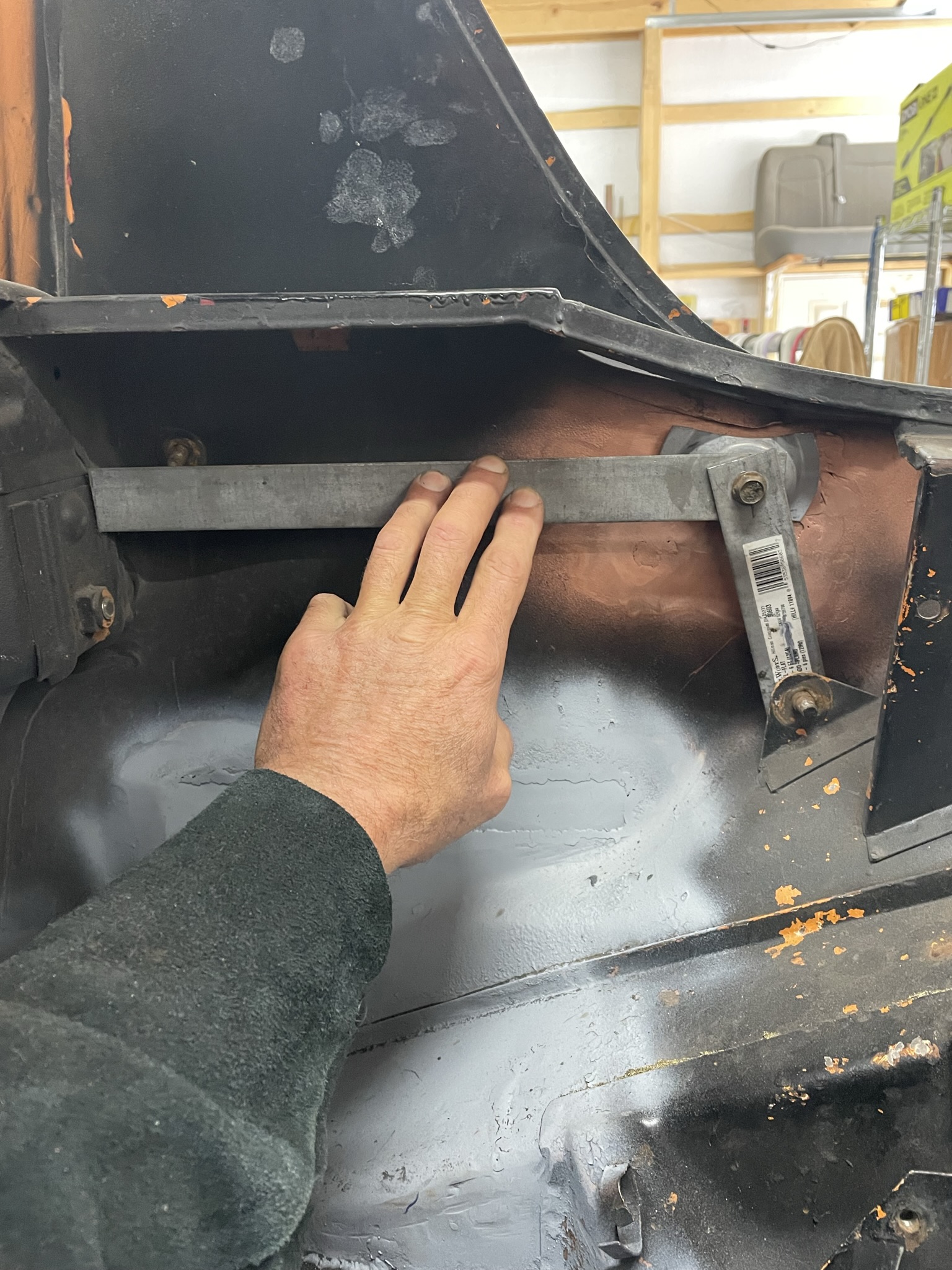

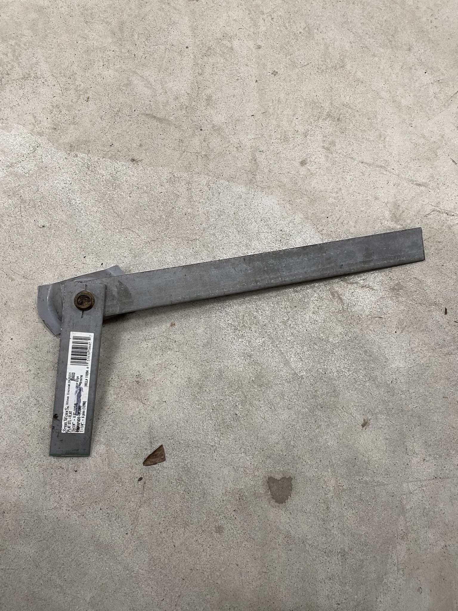

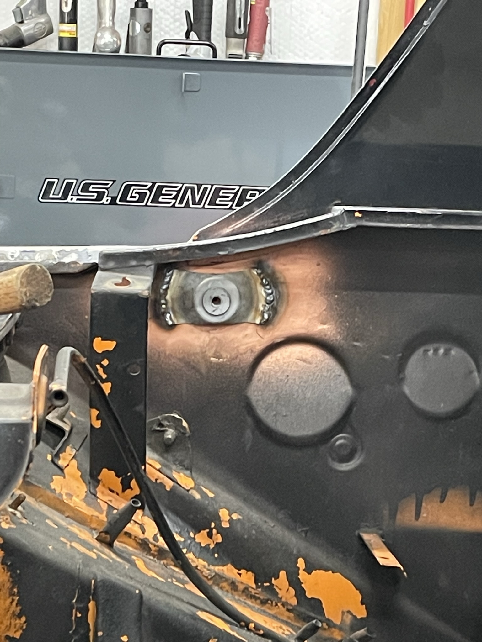

Then it was on to rear trunk hinge pivots. The drivers side was a mess of bubble gum welds holding a stock replacement pivot. I cut the off and got down to clean metal. The passenger side had an aftermarket heim joint setup (jwest?) and they had drilled multiple holes before they got it right. I welded up all the holes and got back to clean metal as a base.
I made a little jig for proper positioning the pivot, it works for either side.
