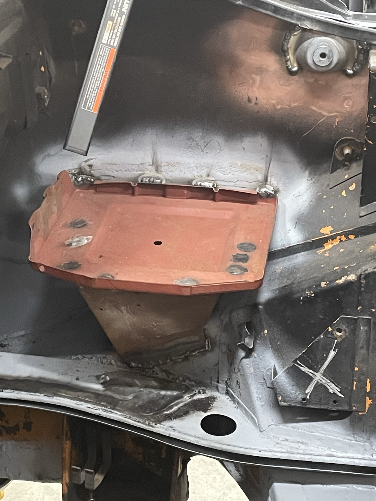

Tackled the battery tray next. Although I’m doing a Subaru conversion and most seem to relocate the battery, I couldn’t find any reason not to go with the stock location.

East coaster   Tackled the battery tray next. Although I’m doin...   Mar 24 2023, 05:28 AM
