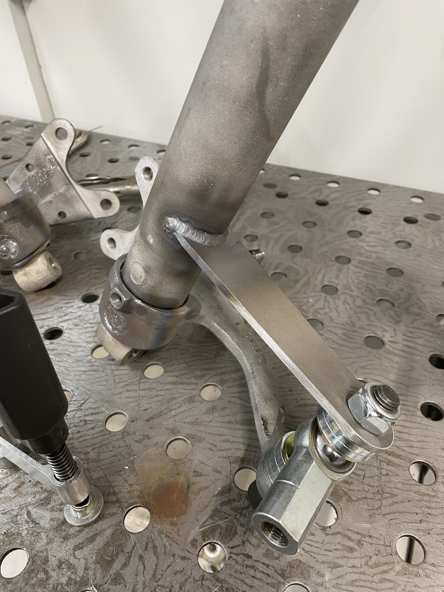

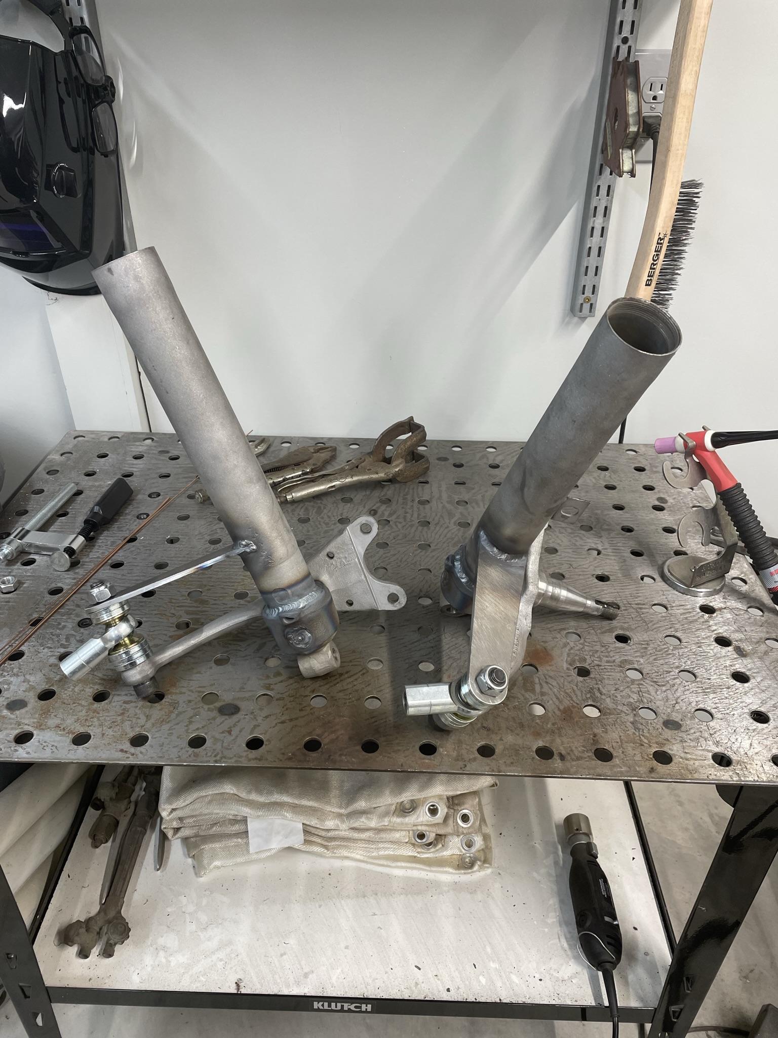

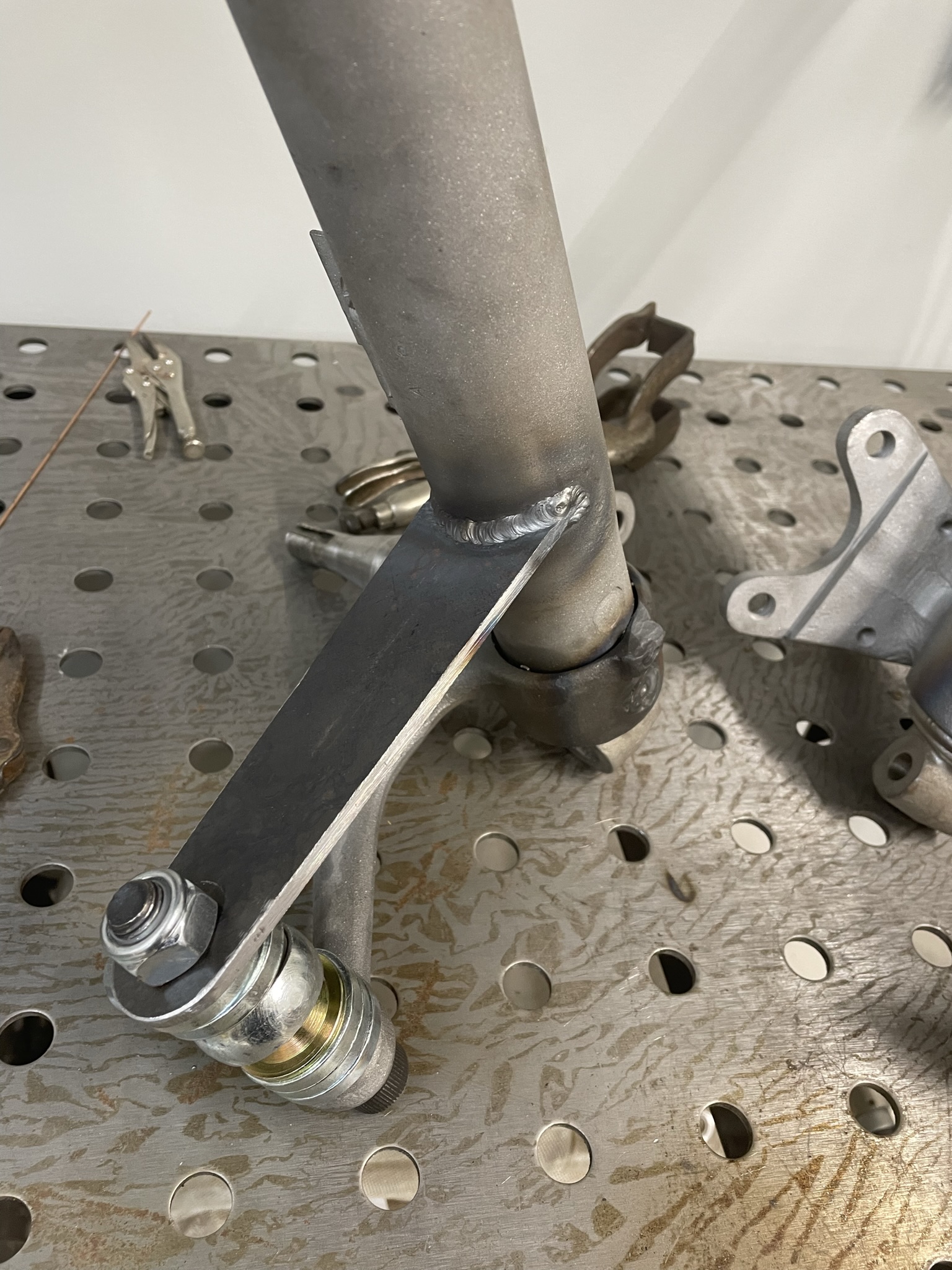

Decided a little while back to go with 911 struts. I was originally going to use my stock 4 bolt struts and convert the rotors to 5 lug and started modifying them for the Safari lift.
Fast forward…..thanks to @mepstein , I have 911 struts to mod.
I lowered the axles 1.670” and added a steering arm brace to allow for heim joints (vs ball joints). Welded them up today and now they’re ready for prime and paint.
