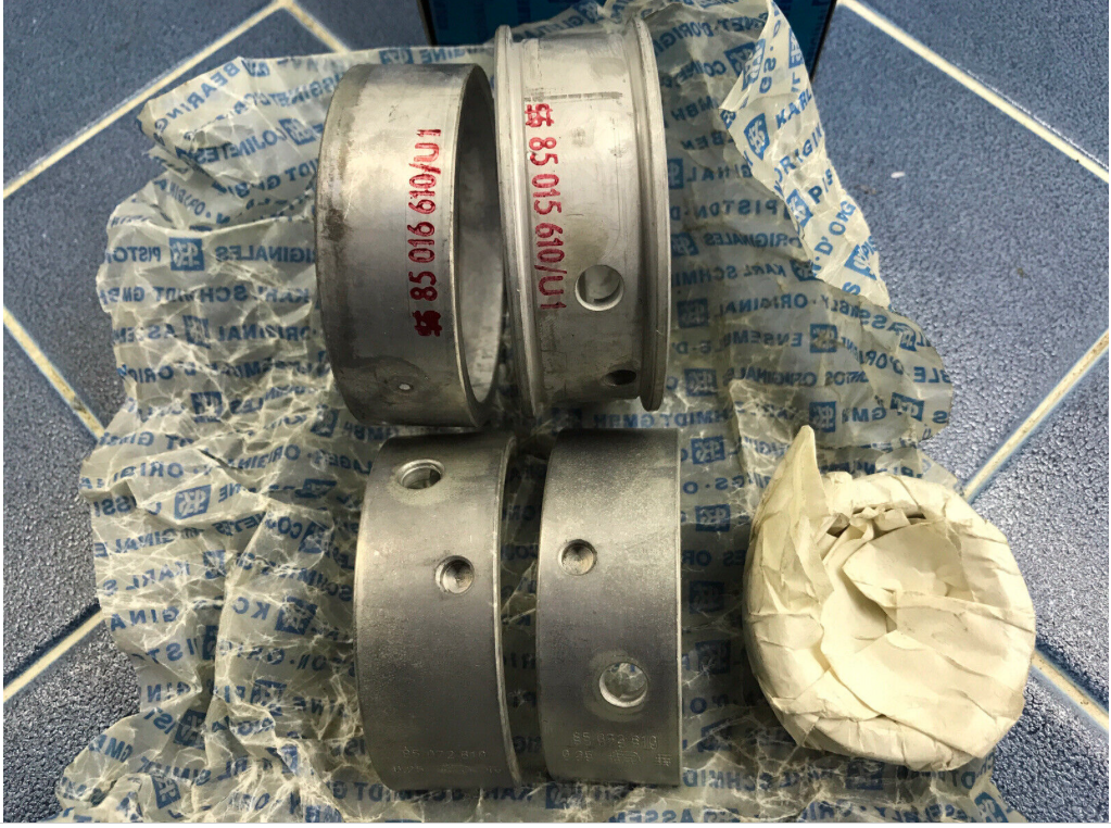

It took a while but I finally got a set of NOS KS/KW 0.010 main bearings on the way....
I did have to pay more than I should have....but I think I am worth it! ;-)
