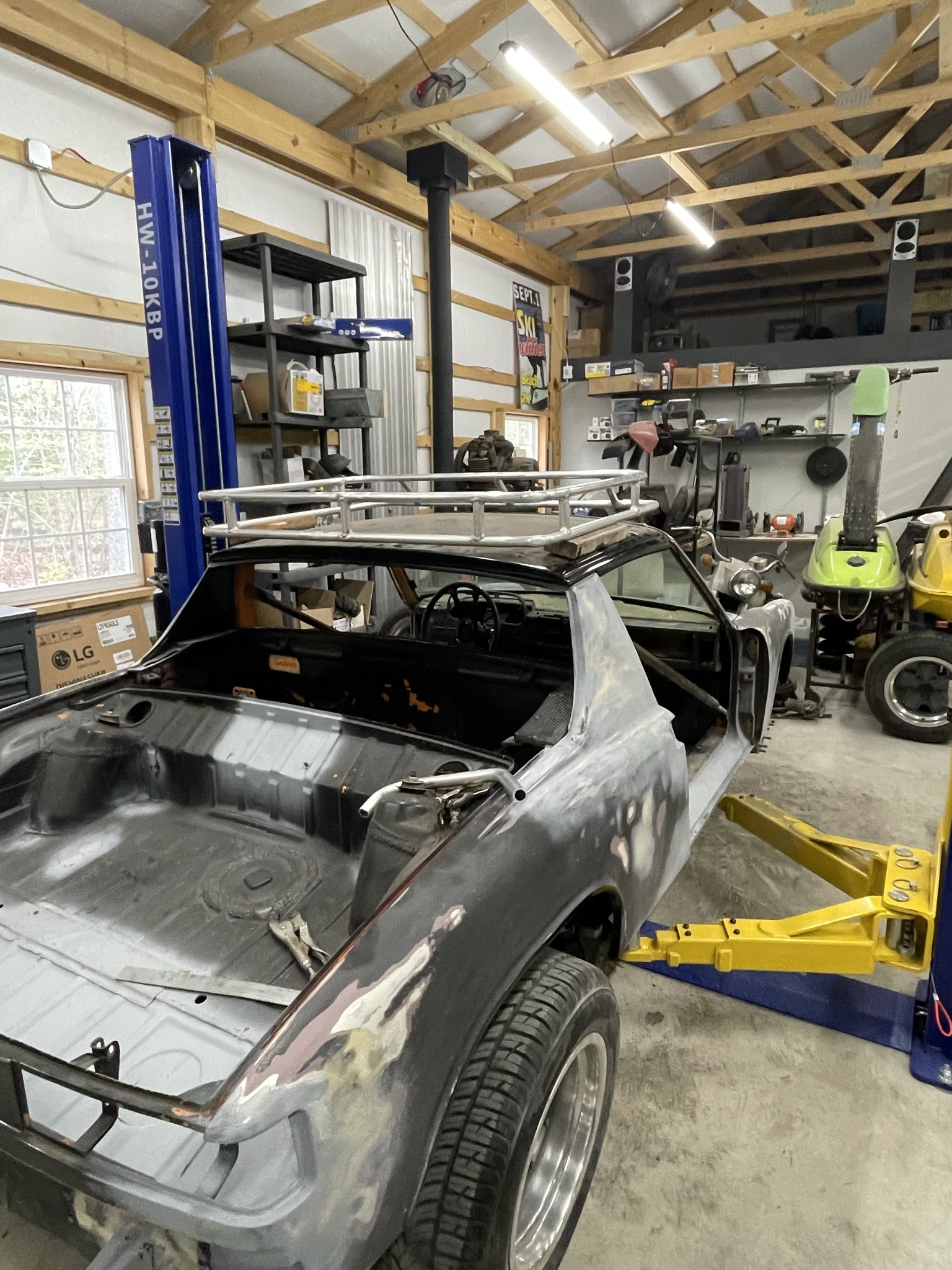

East coaster Started fabricating my safari rack (what’s a saf... Mar 5 2023, 07:58 PM

Retroracer Some great fabrication there. Rack design coming ... Mar 11 2023, 09:21 AM
East coaster
Some great fabrication there. Rack design coming... Mar 11 2023, 09:04 PM

Retroracer Hinged at the front so you can remove the targa ro... Apr 1 2023, 09:48 AM
East coaster
Hinged at the front so you can remove the targa r... Apr 1 2023, 07:10 PM

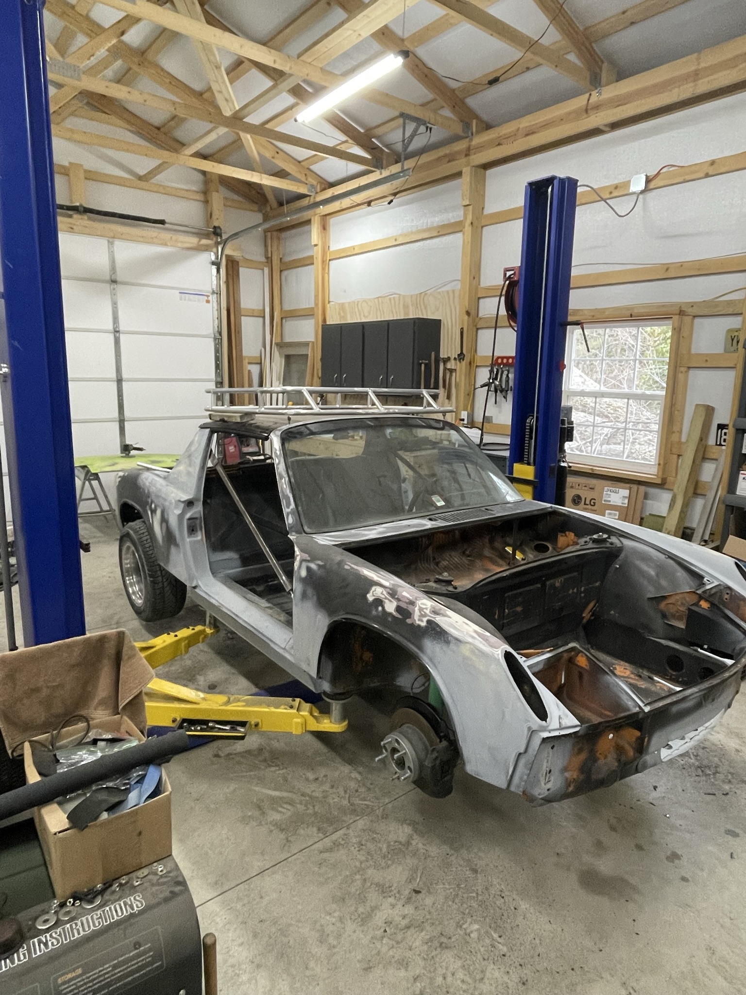

East coaster My biggest challenge in this project thus far is d... Apr 2 2023, 06:37 PM

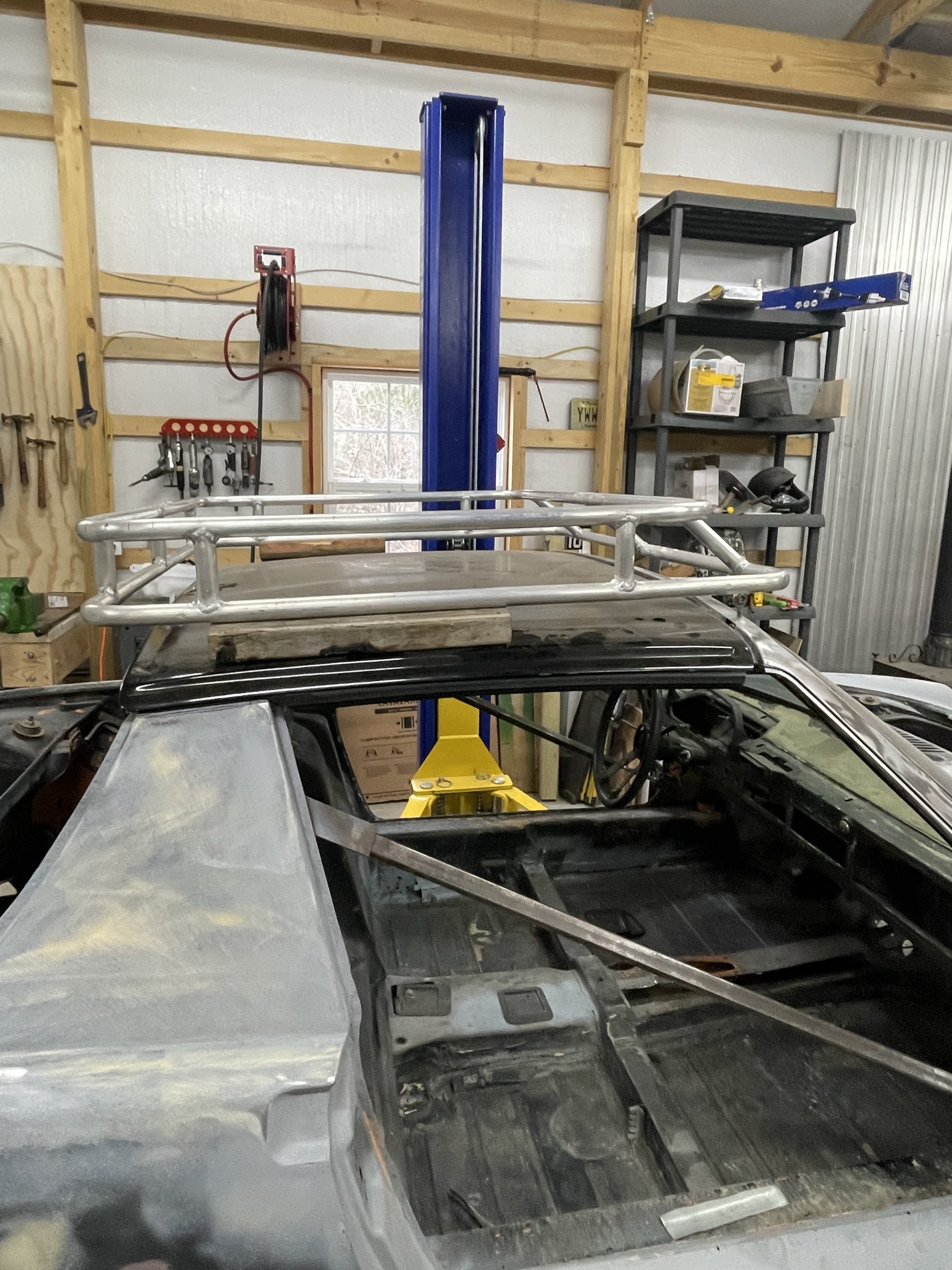

East coaster Started work on the rear rack. Hope to get it weld... Apr 3 2023, 07:00 PM

East coaster Finished fabricating and welding the rear rack. On... Apr 4 2023, 07:56 PM
East coaster Finished the rear cargo rack and got it mounted to... Apr 6 2023, 08:08 PM

Shivers Well, this rocks (pun intended}. The rack sure mak... Apr 7 2023, 09:10 AM
