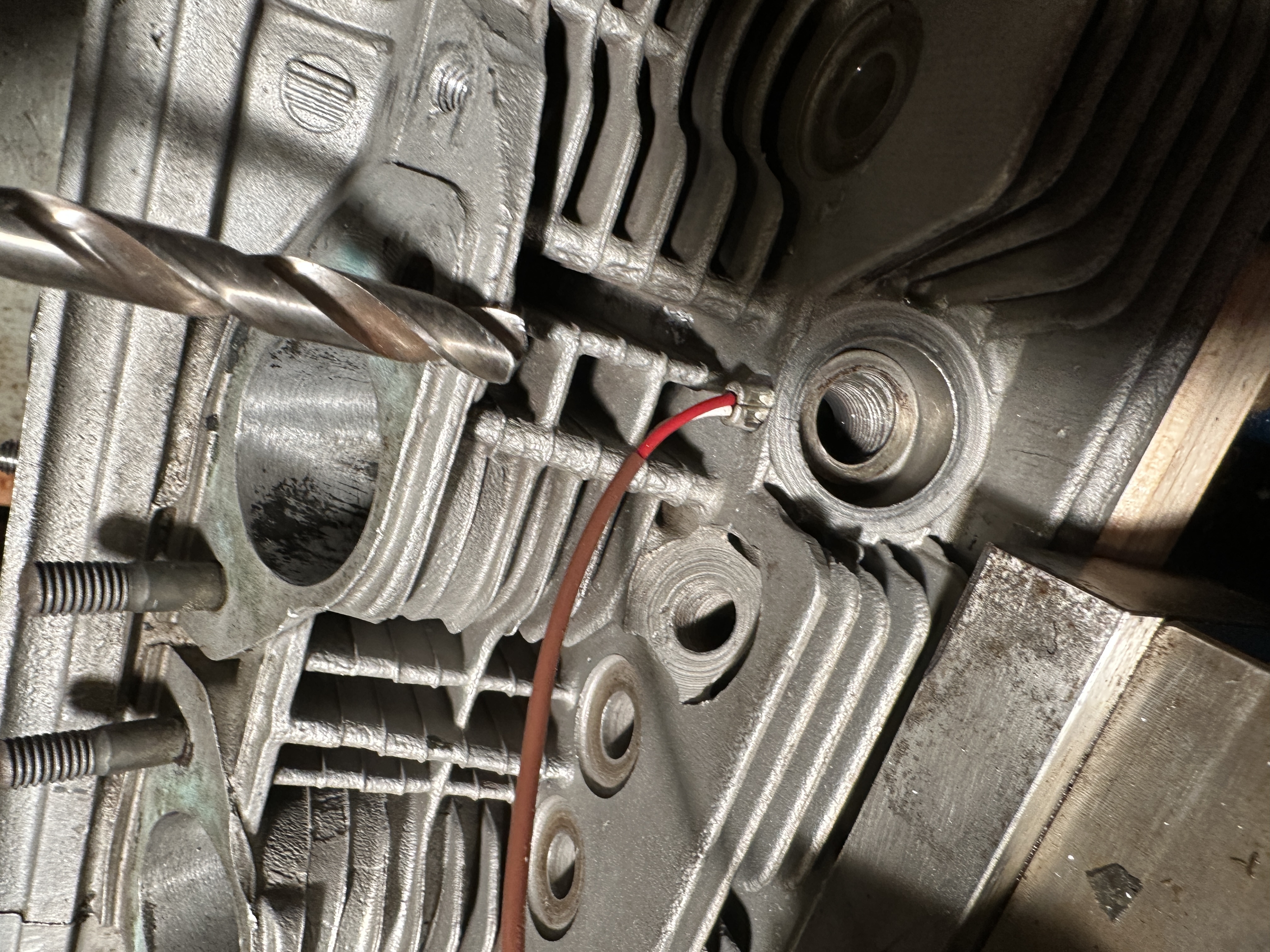

Add a VDO HEAD TEMP thermocouple under the #3 spark plug. Milled a small hole for the wires and crimp.

VaccaRabite   Unless things have changed, the VDO head temp gaug...   Mar 29 2023, 06:09 AM
rfinegan   This way the sensor stays in place when servicing ...   Mar 29 2023, 07:18 AM
