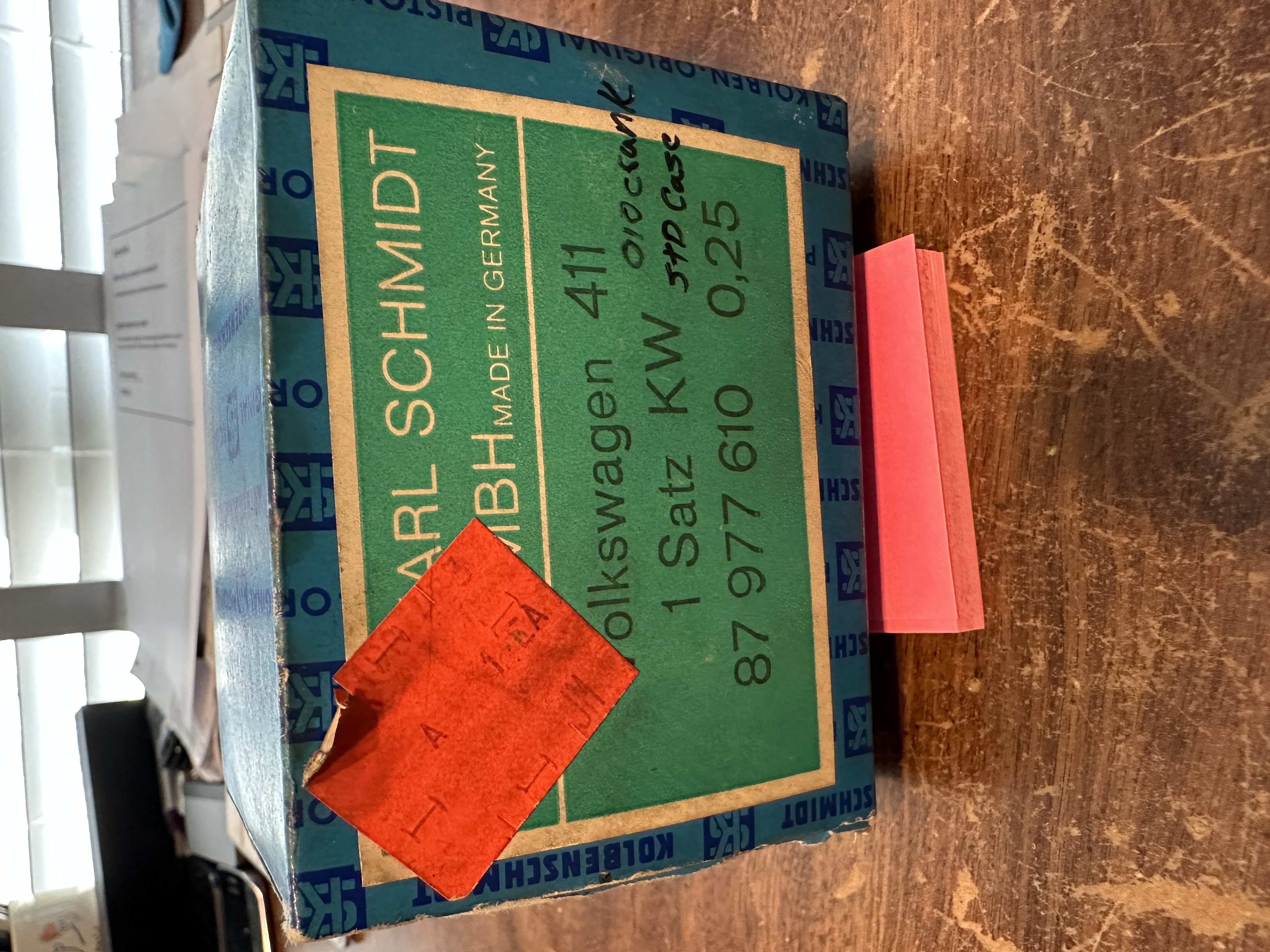

Never opposed to OE parts if you can get them....

rfinegan   It took a while but I finally got a set of NOS KS/...   Mar 27 2023, 05:24 AM

rfinegan   I may be CRAZY, but got a set of ML Cam bearings n...   Apr 7 2023, 11:06 AM
rfinegan   NEW KS 2.0 rod bearing are HERE....   Apr 7 2023, 11:07 AM
