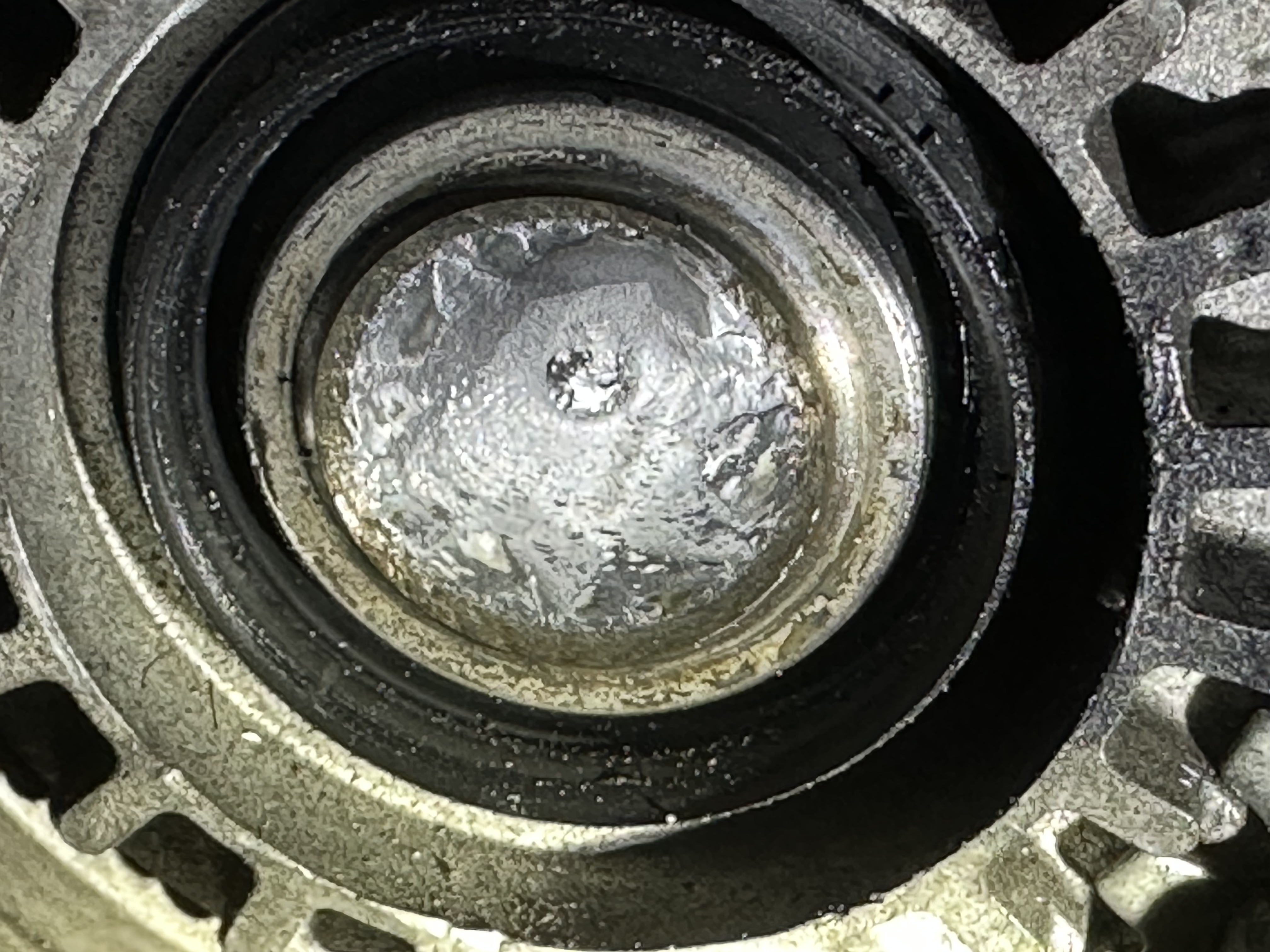

The fracture occurred at the the small diameter of the fillet near the outboard side of the oil seal land.
I haven’t had a chance to inspect the fracture surface in detail yet.
The bonus of a tight engine bay.. the inboard CV got trapped between my subframe and the bell housing. You can see some material missing on the case to left of the sheared stub.

waltonsm   PSA… Sheared off a diff stub axle this weekend....   Mar 28 2023, 02:05 PM
East coaster   Ouch!   Mar 29 2023, 04:36 AM
jd74914   Did that shear at a snap ring groove   Mar 29 2023, 06:55 AM
waltonsm   The fracture occurred at the the small diameter of...   Mar 29 2023, 11:13 AM
