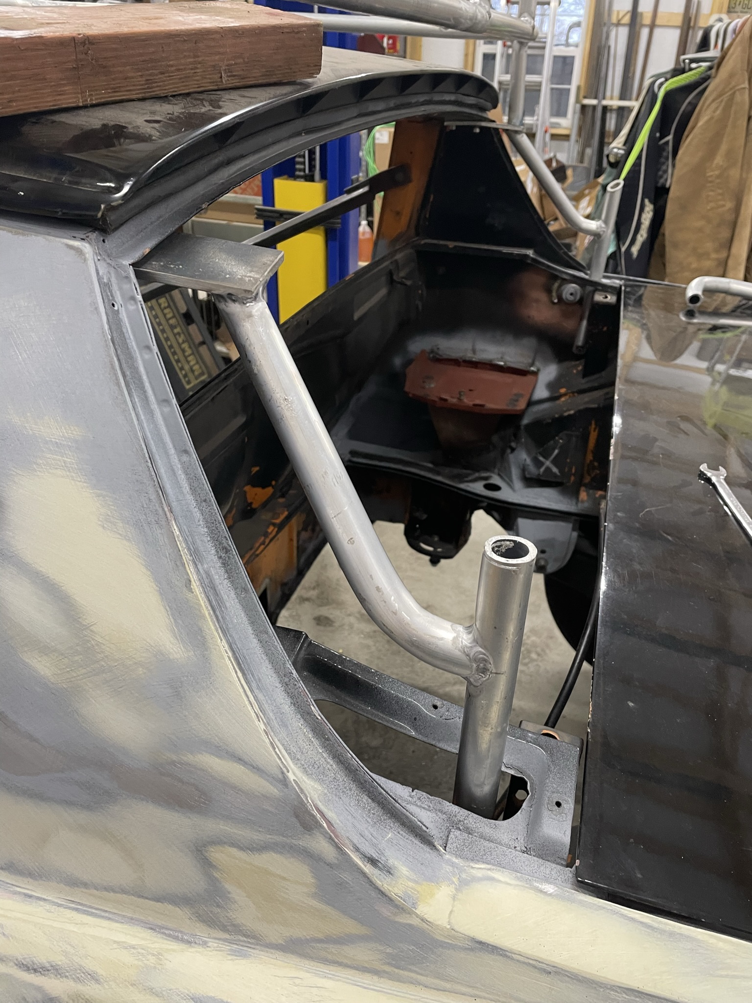

East coaster   My biggest challenge in this project thus far is d...   Apr 2 2023, 06:37 PM

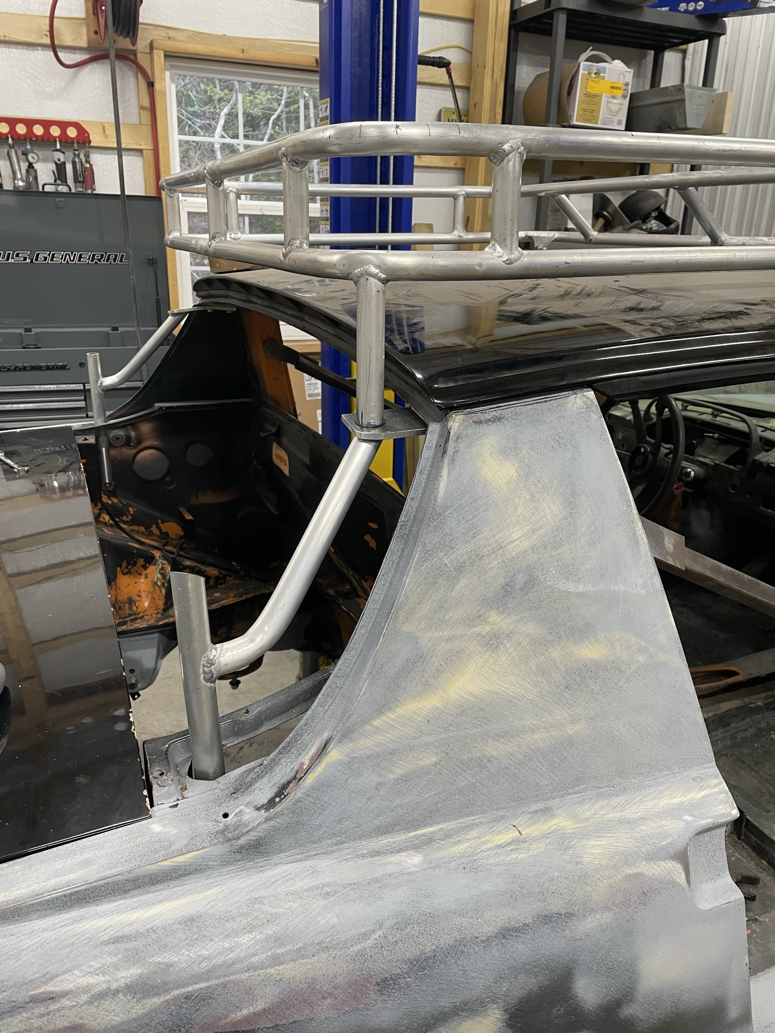

East coaster   Started work on the rear rack. Hope to get it weld...   Apr 3 2023, 07:00 PM

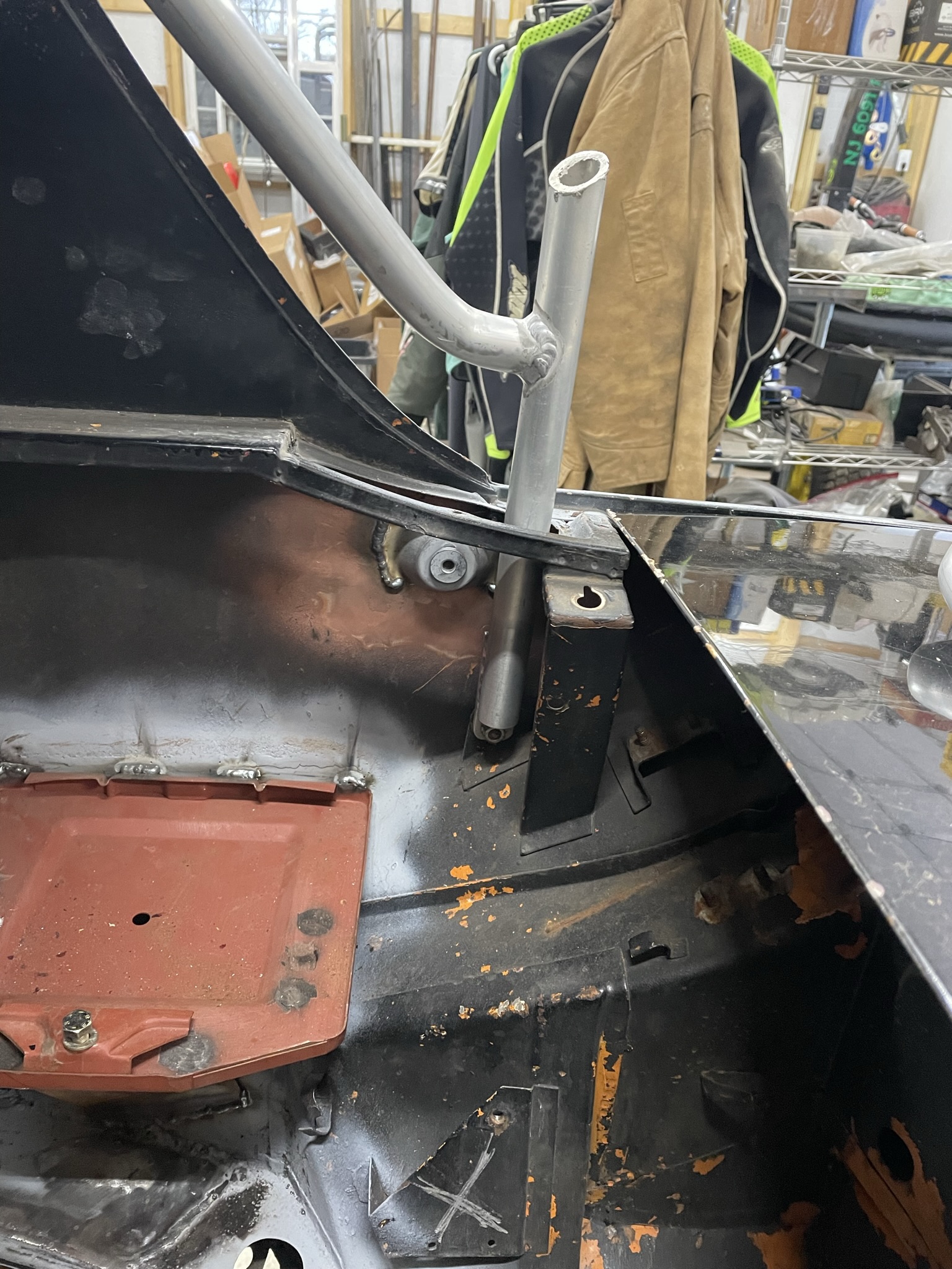

East coaster   Finished fabricating and welding the rear rack. On...   Apr 4 2023, 07:56 PM
East coaster   Finished the rear cargo rack and got it mounted to...   Apr 6 2023, 08:08 PM
