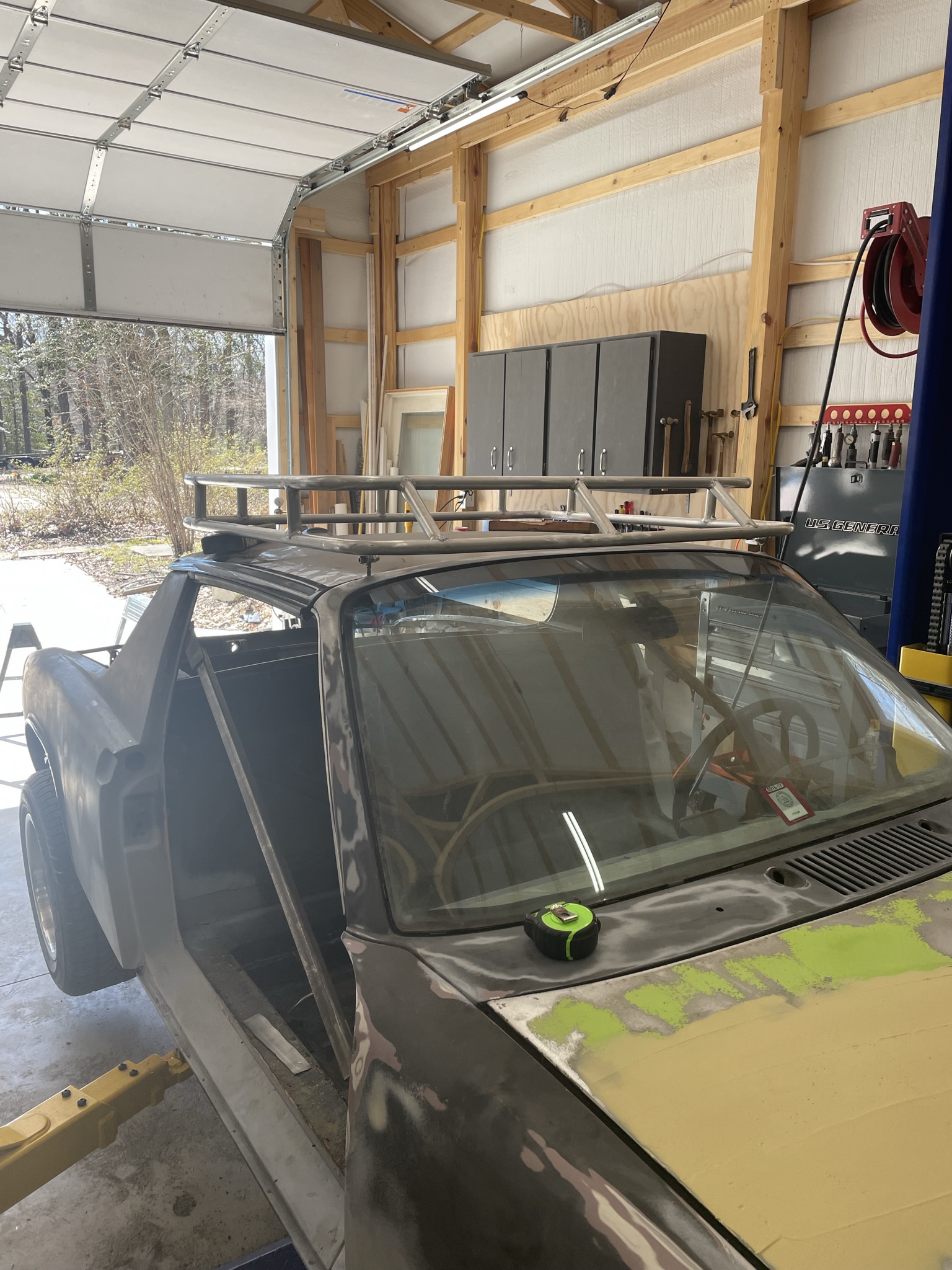

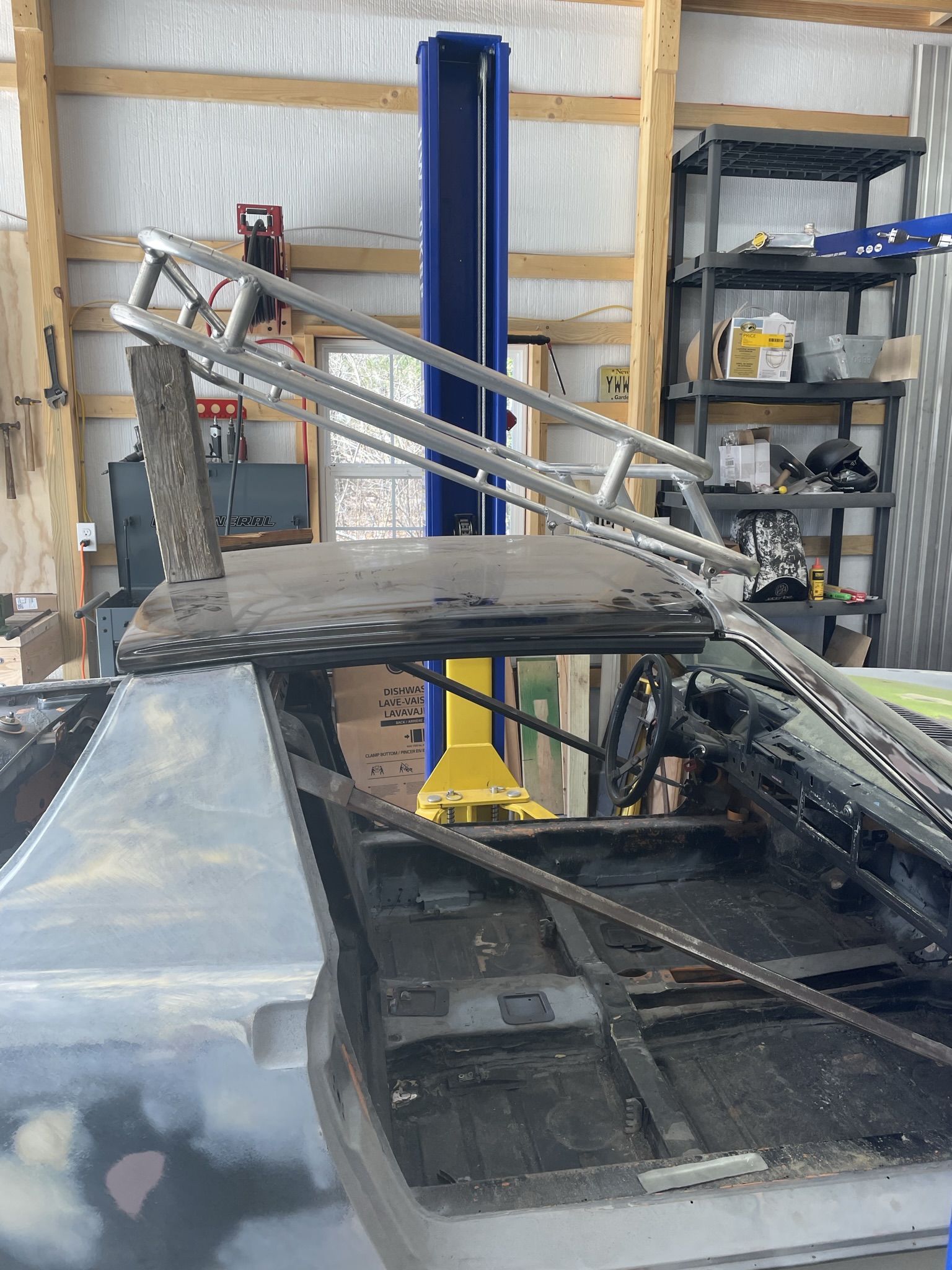

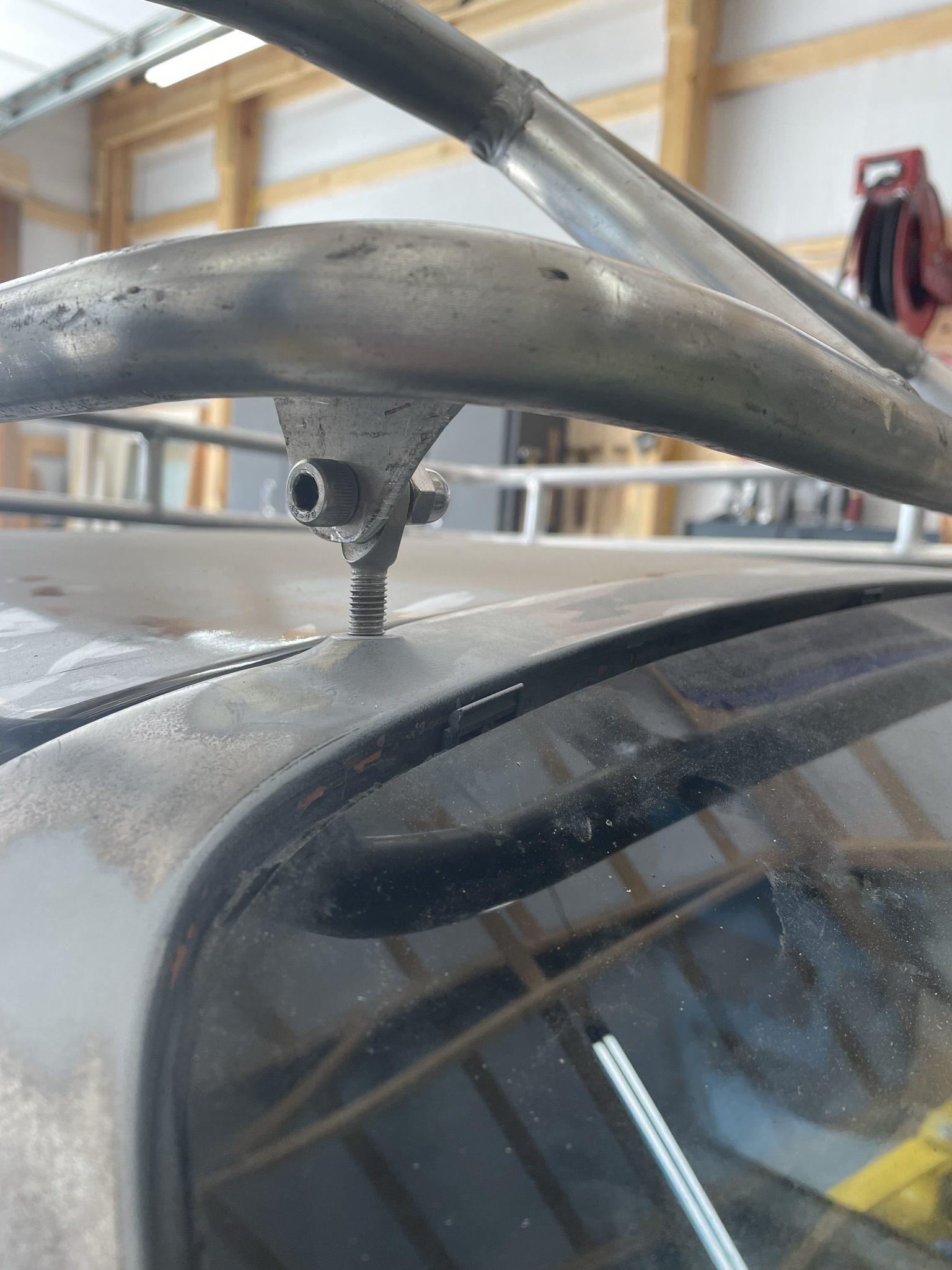

East coaster   Started fabricating my safari rack (what’s a saf...   Mar 5 2023, 07:58 PM

Retroracer   Some great fabrication there. Rack design coming ...   Mar 11 2023, 09:21 AM
East coaster   Some great fabrication there. Rack design coming...   Mar 11 2023, 09:04 PM

Retroracer   Hinged at the front so you can remove the targa ro...   Apr 1 2023, 09:48 AM
East coaster   Hinged at the front so you can remove the targa r...   Apr 1 2023, 07:10 PM
