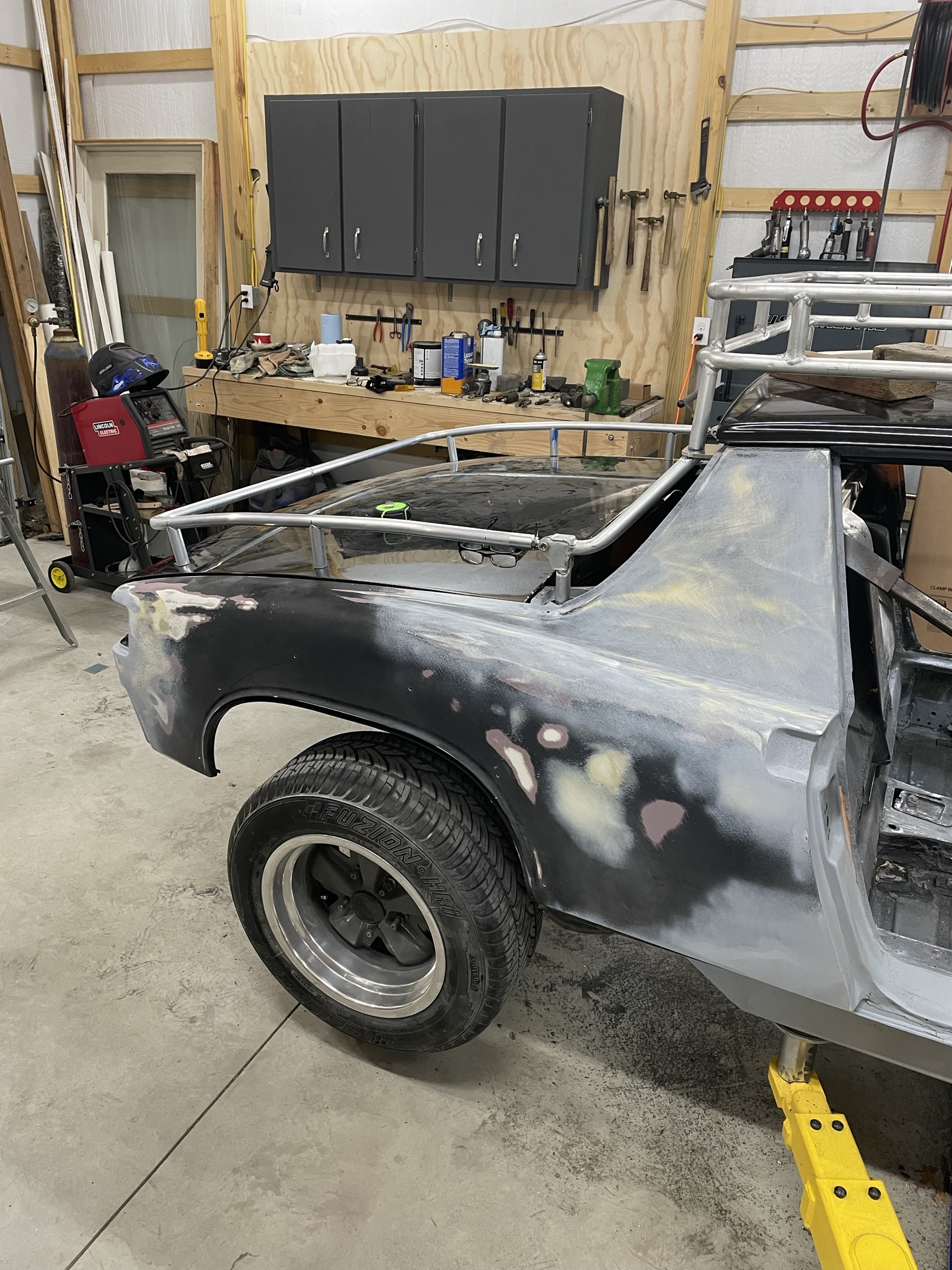

Started work on the rear rack. Hope to get it welded up tomorrow…..

East coaster   Started work on the rear rack. Hope to get it weld...   Apr 3 2023, 07:00 PM

East coaster   Finished fabricating and welding the rear rack. On...   Apr 4 2023, 07:56 PM
East coaster   Finished the rear cargo rack and got it mounted to...   Apr 6 2023, 08:08 PM
