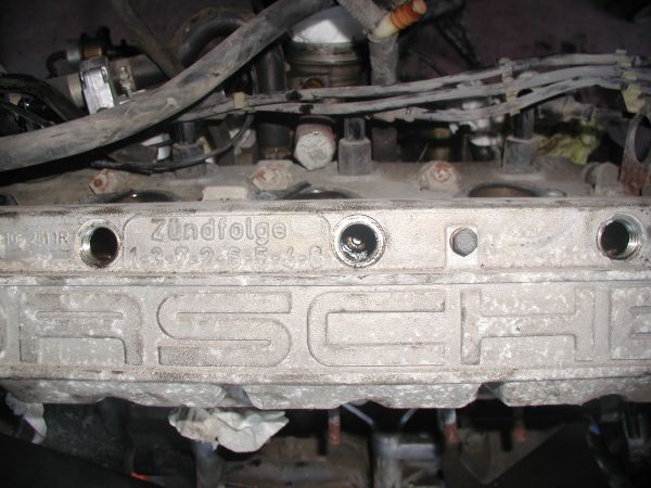

Now the uglyness I broke an allen wrench off in one of the cam tower bolts (IMG:http://www.914world.com/bbs2/html/emoticons/sad.gif) I vented about this in another post and am over it now. NOw Im just mad at myself (IMG:http://www.914world.com/bbs2/html/emoticons/mad.gif)

spare time toys   Well I got the head off on the left side today bef...   Jan 20 2005, 06:28 PM
spare time toys   Now the uglyness I broke an allen wrench off in on...   Jan 20 2005, 06:32 PM
