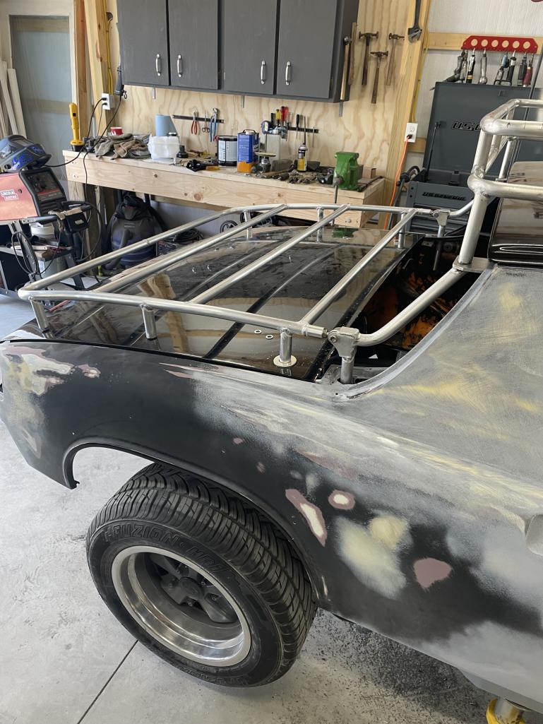

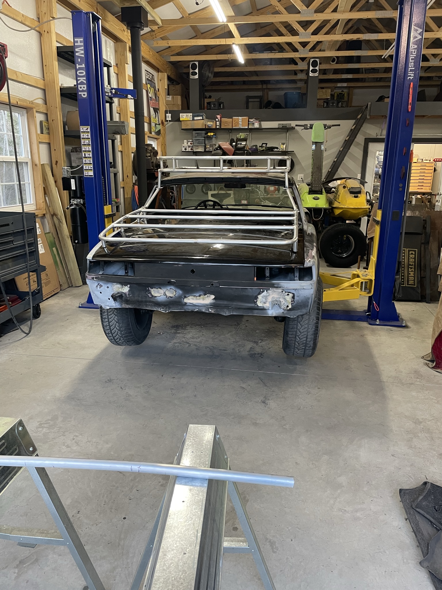

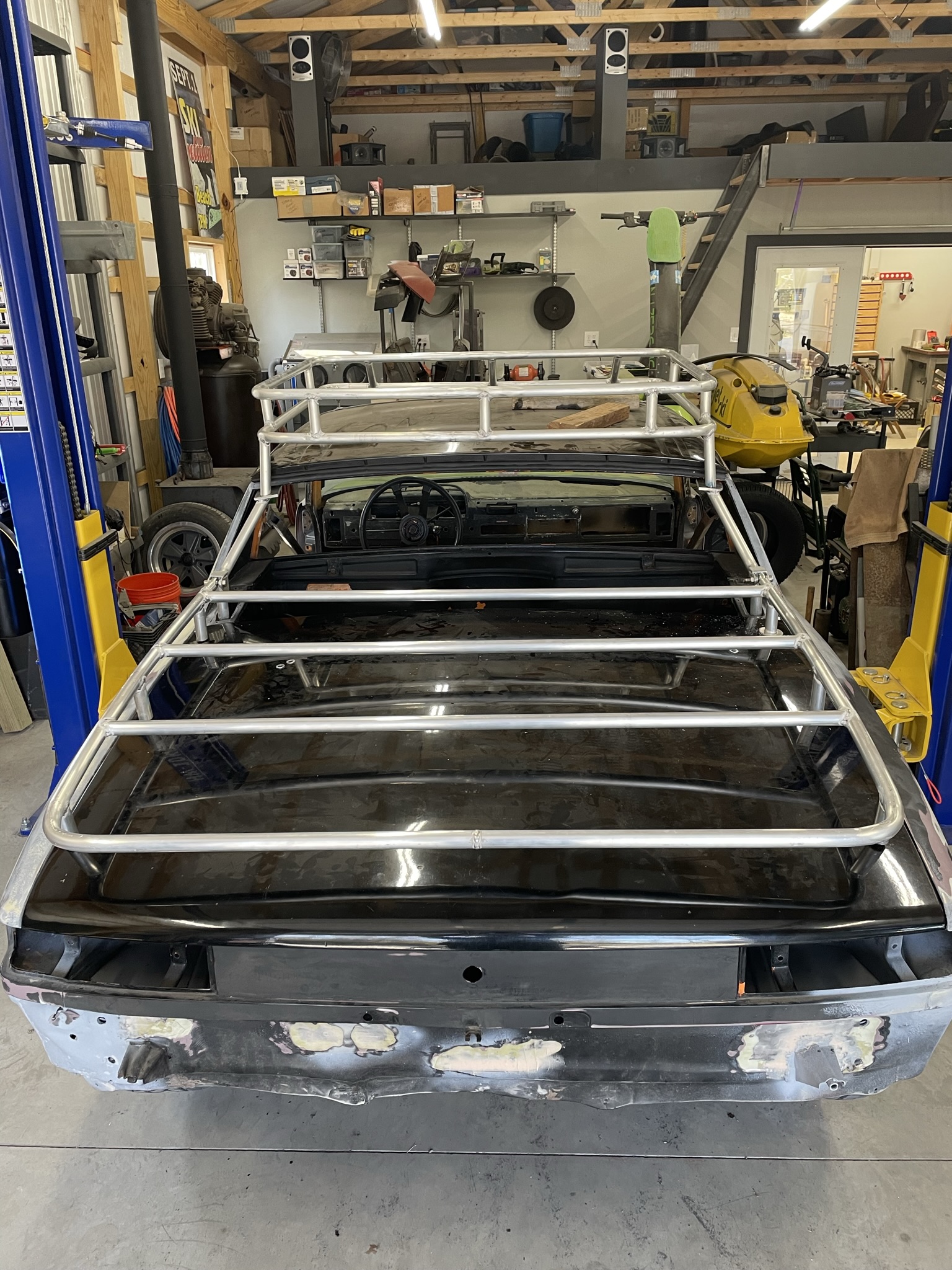

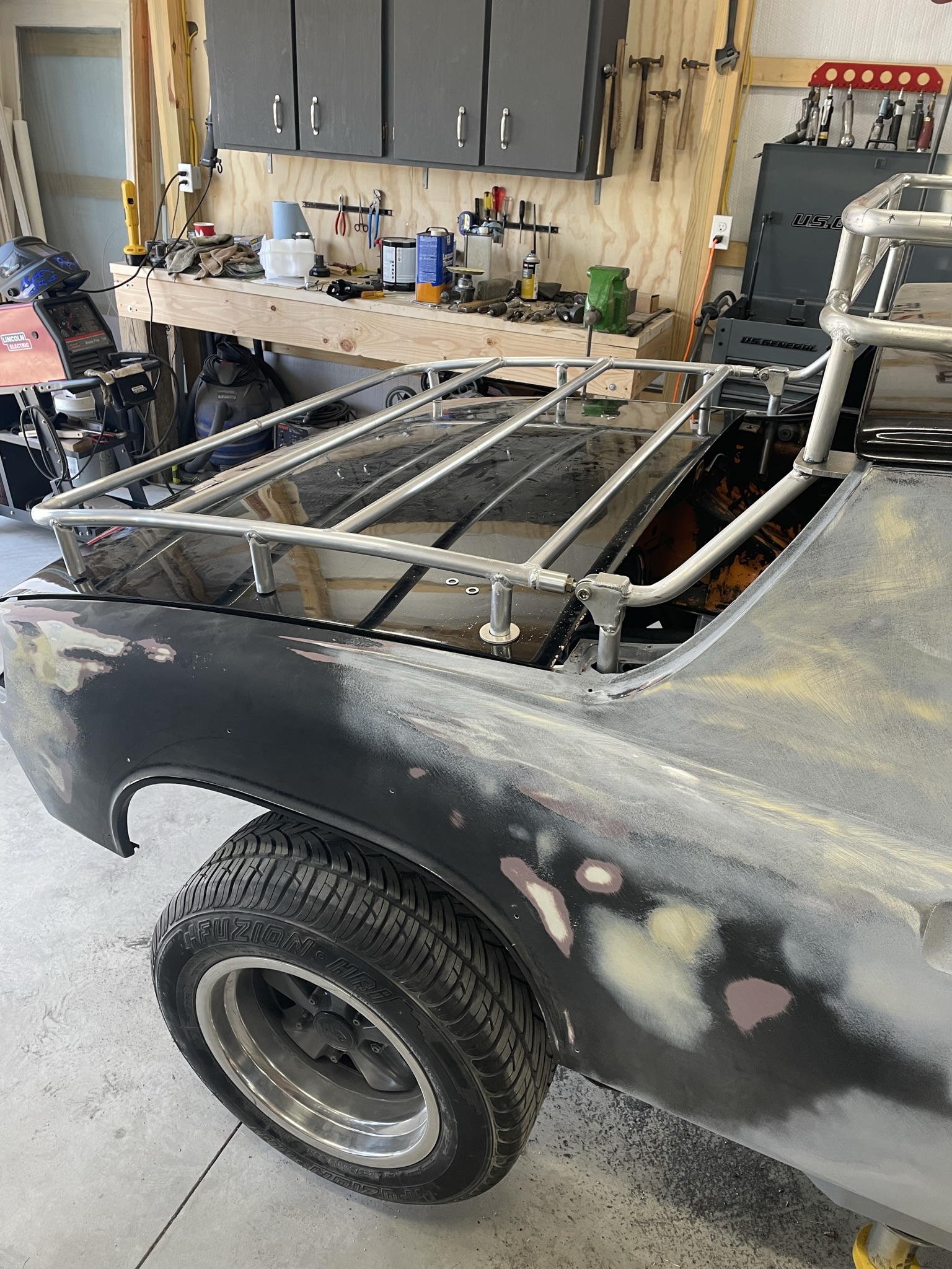

Finished fabricating and welding the rear rack. Only thing left is welding the flanges where it meets the trunk.

East coaster   Started fabricating my safari rack (what’s a saf...   Mar 5 2023, 07:58 PM

East coaster   Started work on the rear rack. Hope to get it weld...   Apr 3 2023, 07:00 PM

East coaster   Finished fabricating and welding the rear rack. On...   Apr 4 2023, 07:56 PM
East coaster   Finished the rear cargo rack and got it mounted to...   Apr 6 2023, 08:08 PM
