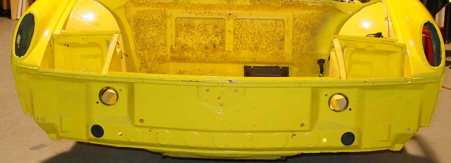

Example of late 1976:

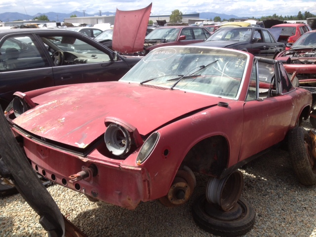

Earlier 1976:
BTW, it appears to have the mounting holes for the 74 and earlier bumpers as well. So definitely a Euro market panel.
