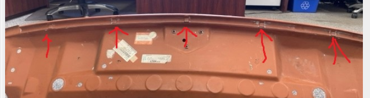

I have this NOS front latch panel here. It is unique in that it has an extra lip on the front.
I also have an NOS from clip that I know is from a 70-71 car as it has the unique impressions from that MY.
I have checked my boneyard where I have MY 72, 73, 74. None of these cars has this front lip.
It also has five little square impressions when looking face on.
So I'm trying to determine what year this lip came on cars, and its actually function.
I'm thinking that it could have started in 1975?
Can anyone confirm this and also its function?
Thanks,
Pete

I believe those 5 small openings are drains for water to go from the front trunk seal slot. I think those came about after '74 some time.

davep   That appears to be a very late 1976 panel without ...   Apr 6 2023, 07:09 AM

914Sixer   Dave is correct 75-76 nose.   Apr 6 2023, 07:22 AM

peteyd   Ok, thanks everyone for the responses. I think f...   Apr 6 2023, 09:46 AM
Steve   I have a US 75 car and it had that lip for the rub...   Apr 6 2023, 10:02 AM
