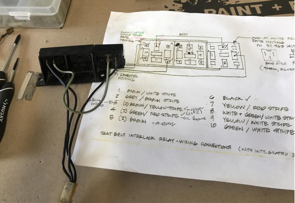

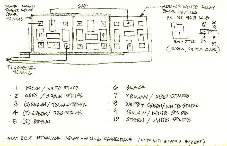

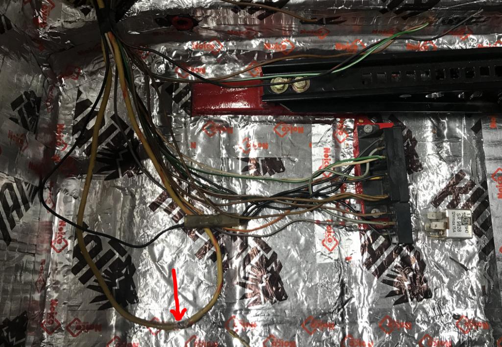

Hi Does anyone have pictures of the seat belt relay board and wires behind the seat of 1974 914 ? Or were I can get a wire diagram of this . Some idjut hacked mine up. Would like to fix this . thanks kindly

You need this diagram. These are two pics from my restoration and the wiring harness diagram. This area was a complete mess and I restored it back to original - minus the starter yellow wire bypass (red arrow), which was a factory recall item. It's actually pretty easy to do. Best of luck!
