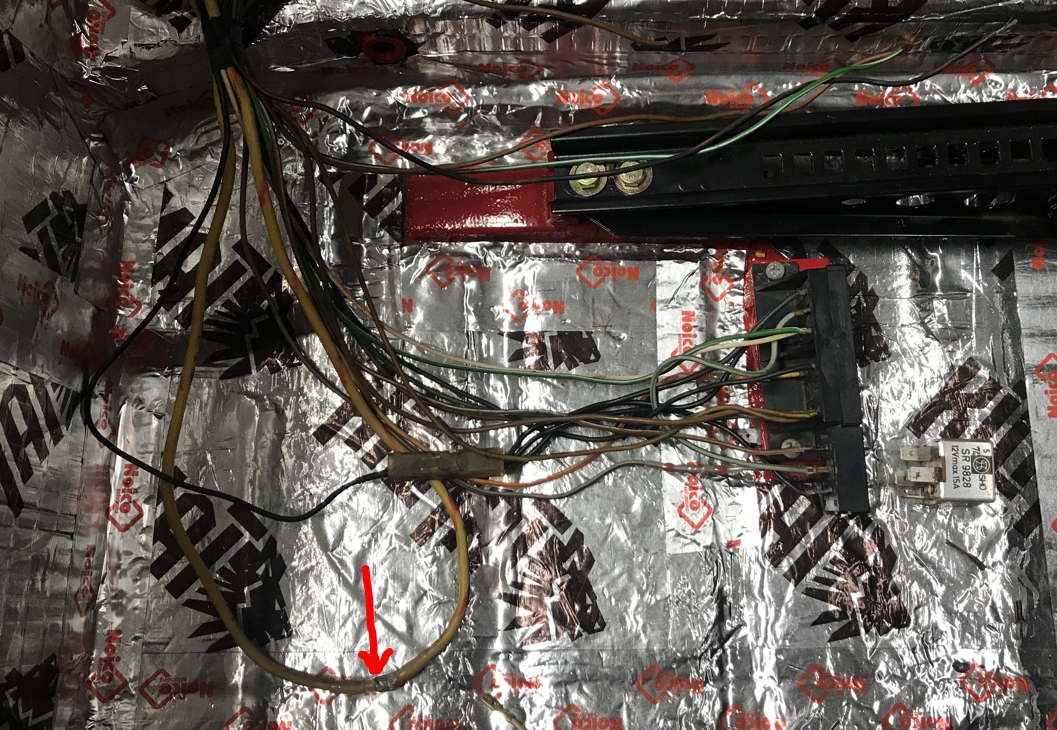

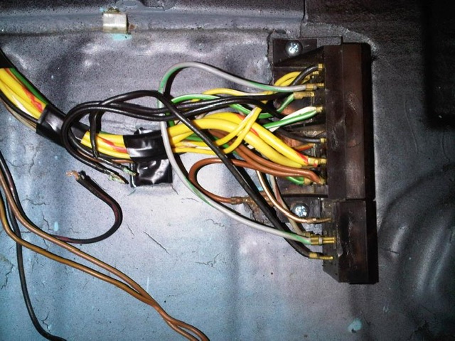

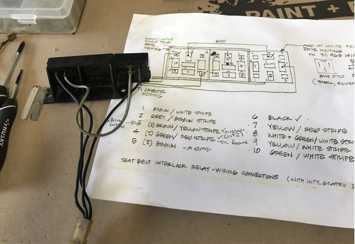

You need this diagram. These are two pics from my restoration and the wiring harness diagram. This area was a complete mess and I restored it back to original - minus the starter yellow wire bypass (red arrow), which was a factory recall item. It's actually pretty easy to do. Best of luck!

Agree! I actually never installed either of the relays into this plastic board. I didn't see any reason to have it hooked up. I just wanted wiring put back to original.
