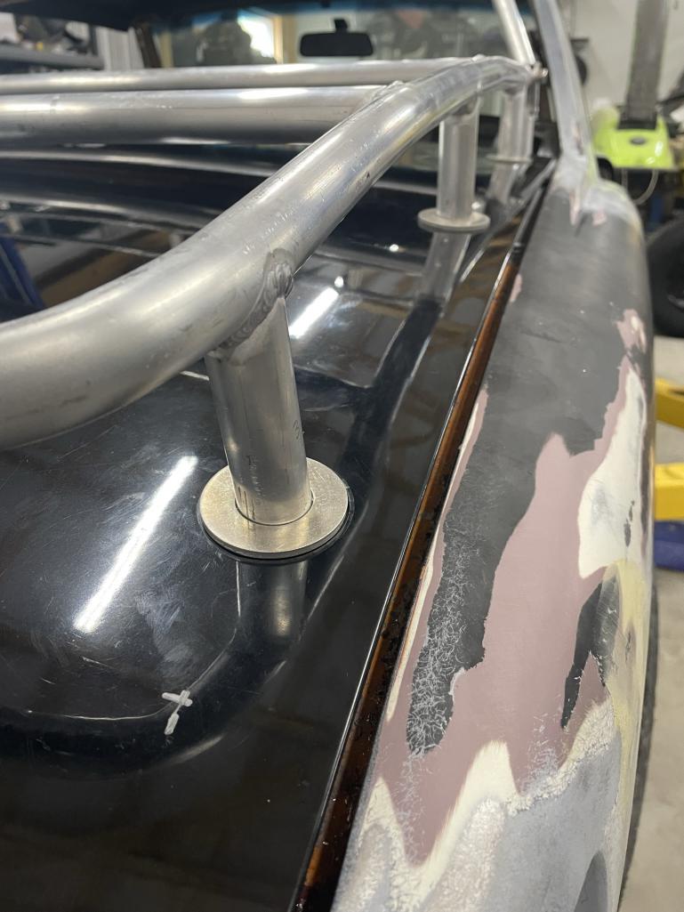

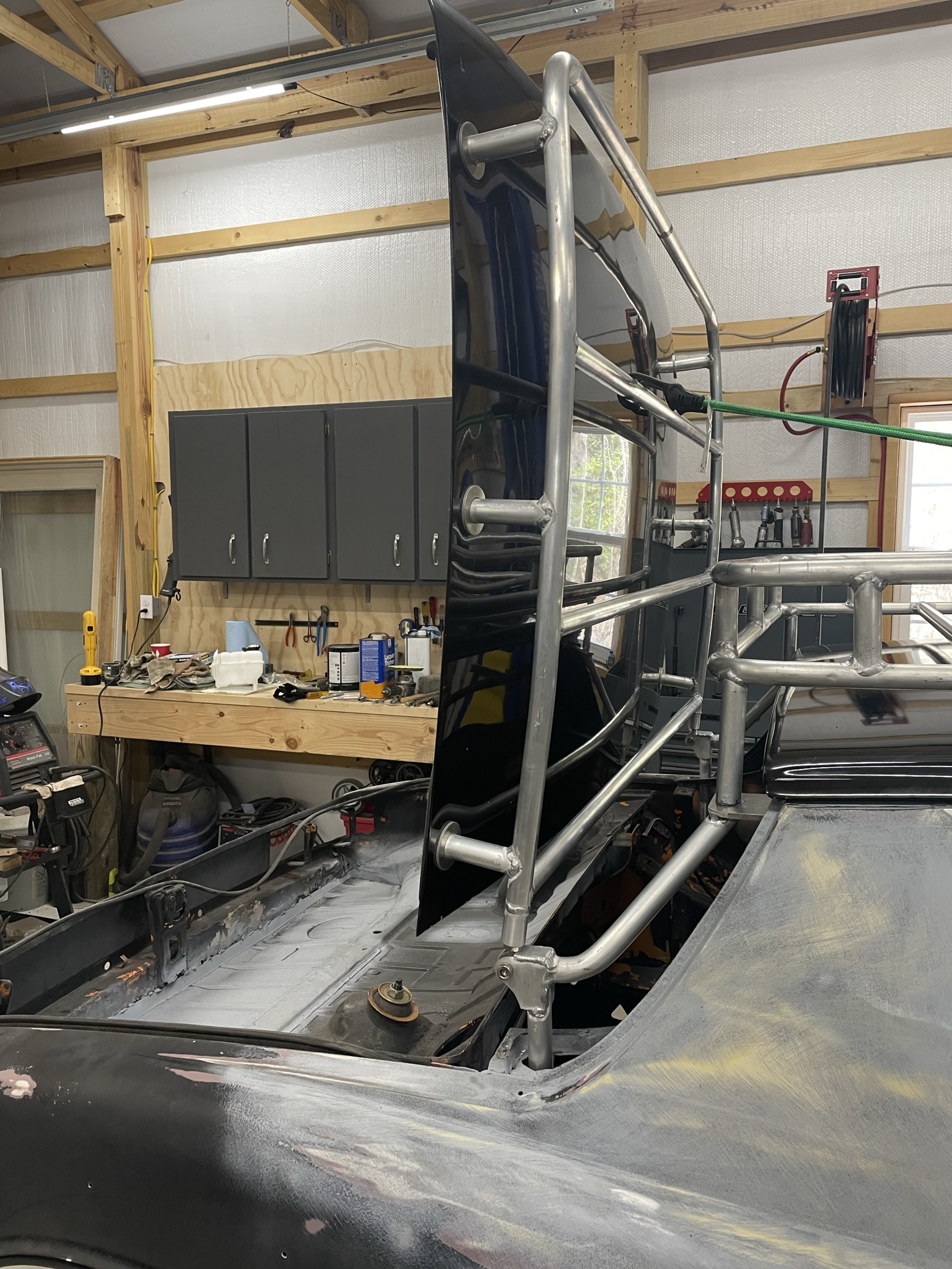

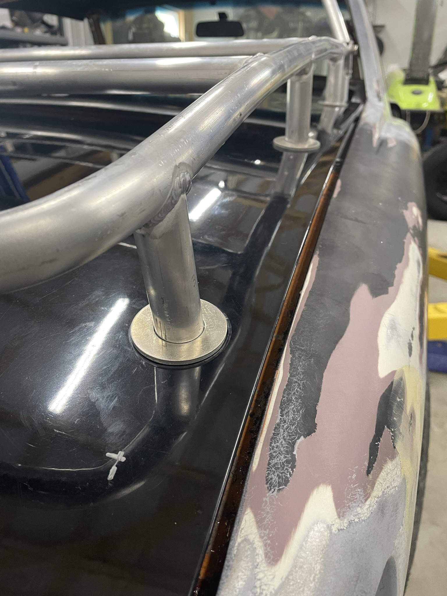

Finished the rear cargo rack and got it mounted to the trunk lid. I removed the factory hinges and the trunk lid now hinges off the rack. The trunk lid works perfectly and latches using the factory latch. Now onto the next part of the project….

East coaster   Finished fabricating and welding the rear rack. On...   Apr 4 2023, 07:56 PM
East coaster   Finished the rear cargo rack and got it mounted to...   Apr 6 2023, 08:08 PM
