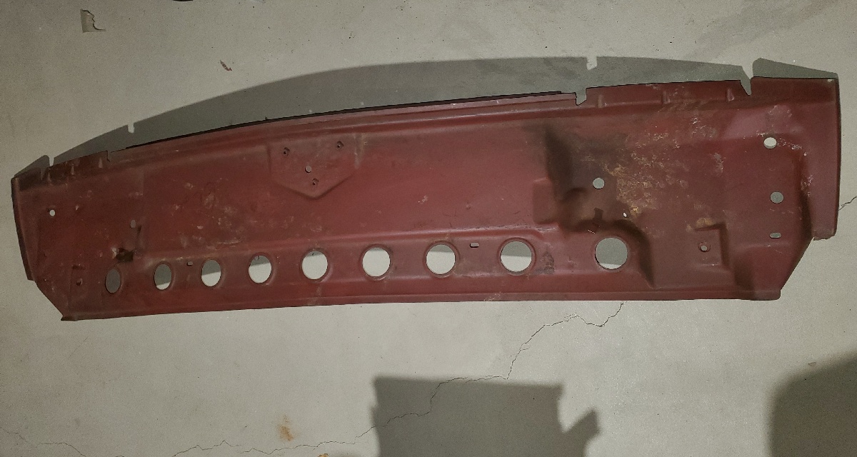

From years of working on 914s I have found four different Front Cross Panel (Schloßquerwand vorn)
1970-72
1973-74
Two flat areas were created for the back of the bumperettes.
1975-76
Provisions for the 5 MPH bumper shocks were added.
Replacement Panel
Note the holes are not cut out.
gms
post Apr 7 2023, 09:59 AM
Posts: 2,755
Joined: 12-March 04
From: Chicagoland
Member No.: 1,785
Early Version

OmaPossu   Thank you for sharing! Although it is now har...   Nov 22 2012, 02:06 PM
sixnotfour   Nice work Glenn. FYI in about 1983 I bought one f...   Nov 23 2012, 09:09 PM
sixerdon   Gee, Glenn. My '75 (11/74) is as your third ph...   Nov 29 2012, 08:42 PM
SirAndy   I would like to hear from other '75 & ...   Nov 30 2012, 02:31 PM
sixnotfour   Right= 75's to some point had rubber plugs.   Nov 30 2012, 08:24 PM
SirAndy   475.29.09903, painted over but clearly holes with ...   Nov 30 2012, 09:12 PM
SirAndy   476.29.03506, and here's a '76 with holes:...   Nov 30 2012, 09:17 PM
SirAndy   476.29.01132, and another '76 with the black p...   Nov 30 2012, 09:21 PM
SirAndy   47629.00593, and another: http://www.914world.com...   Nov 30 2012, 09:23 PM
rjames   My '75 has the holes and plastic plugs.   Nov 30 2012, 11:56 PM
gms   CAVEAT LECTOR! This is MY findings and is not ...   Dec 1 2012, 11:29 AM
SirAndy   Feel free to post variations...maybe the 4th incar...   Dec 1 2012, 02:00 PM
sixerdon   Feel free to post variations...maybe the 4th inca...   Dec 2 2012, 10:13 PM
sixerdon   [quote name='SirAndy' post='1776750' date='Dec 1 ...   Dec 16 2012, 03:43 PM
