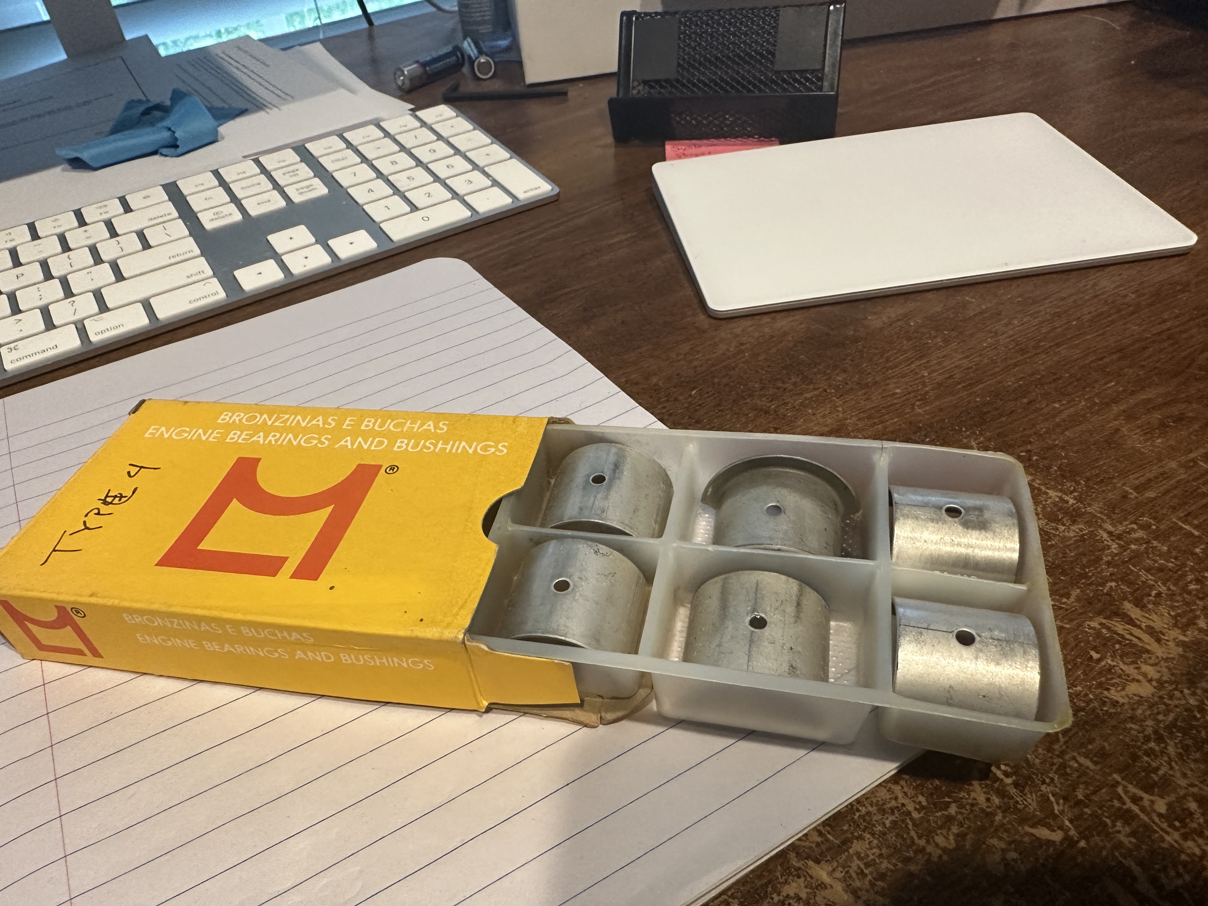

I may be CRAZY, but got a set of ML Cam bearings now...Attached Image

rfinegan   I may be CRAZY, but got a set of ML Cam bearings n...   Apr 7 2023, 11:06 AM
