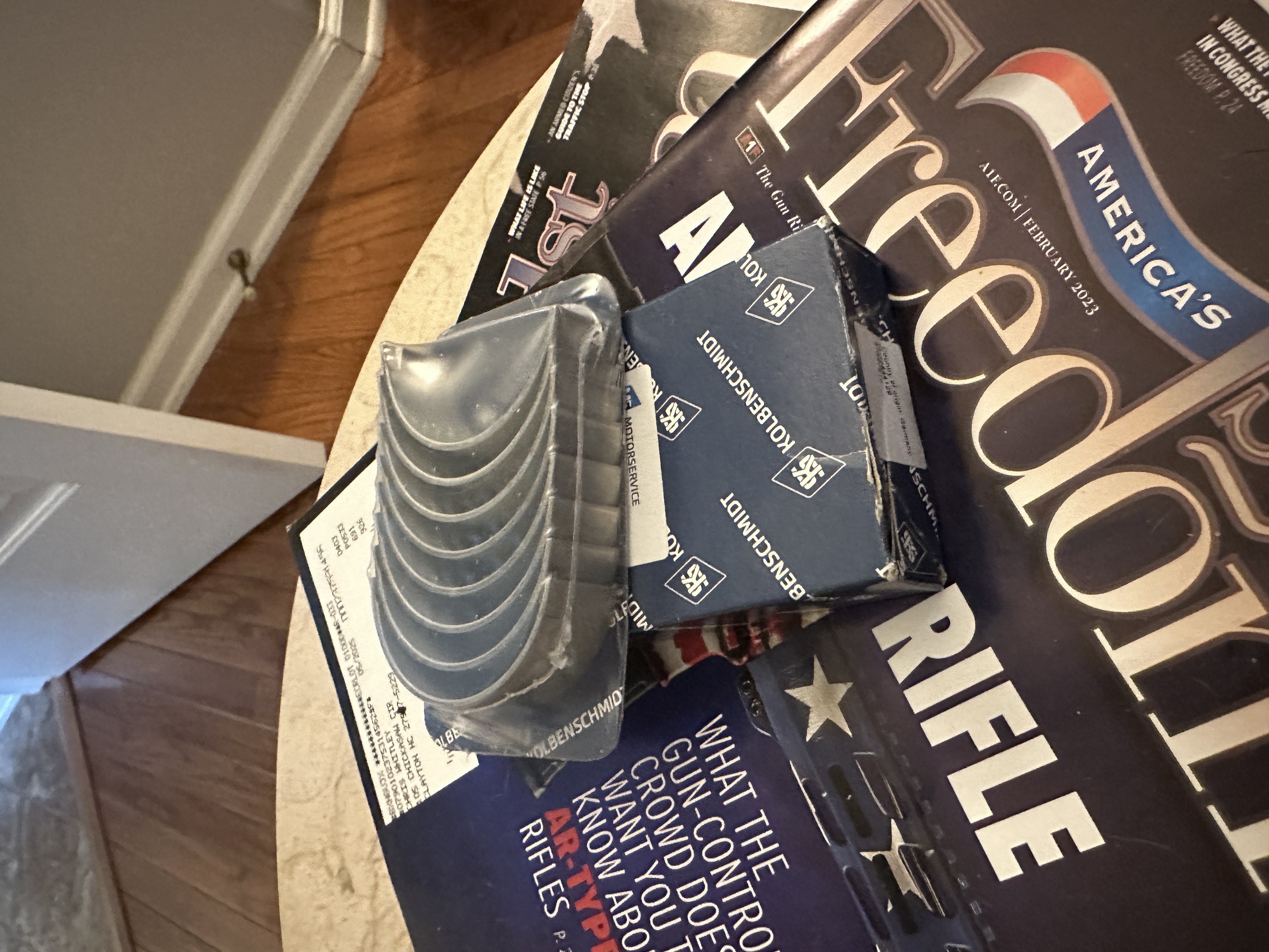

NEW KS 2.0 rod bearing are HERE....

rfinegan   NEW KS 2.0 rod bearing are HERE....   Apr 7 2023, 11:07 AM
