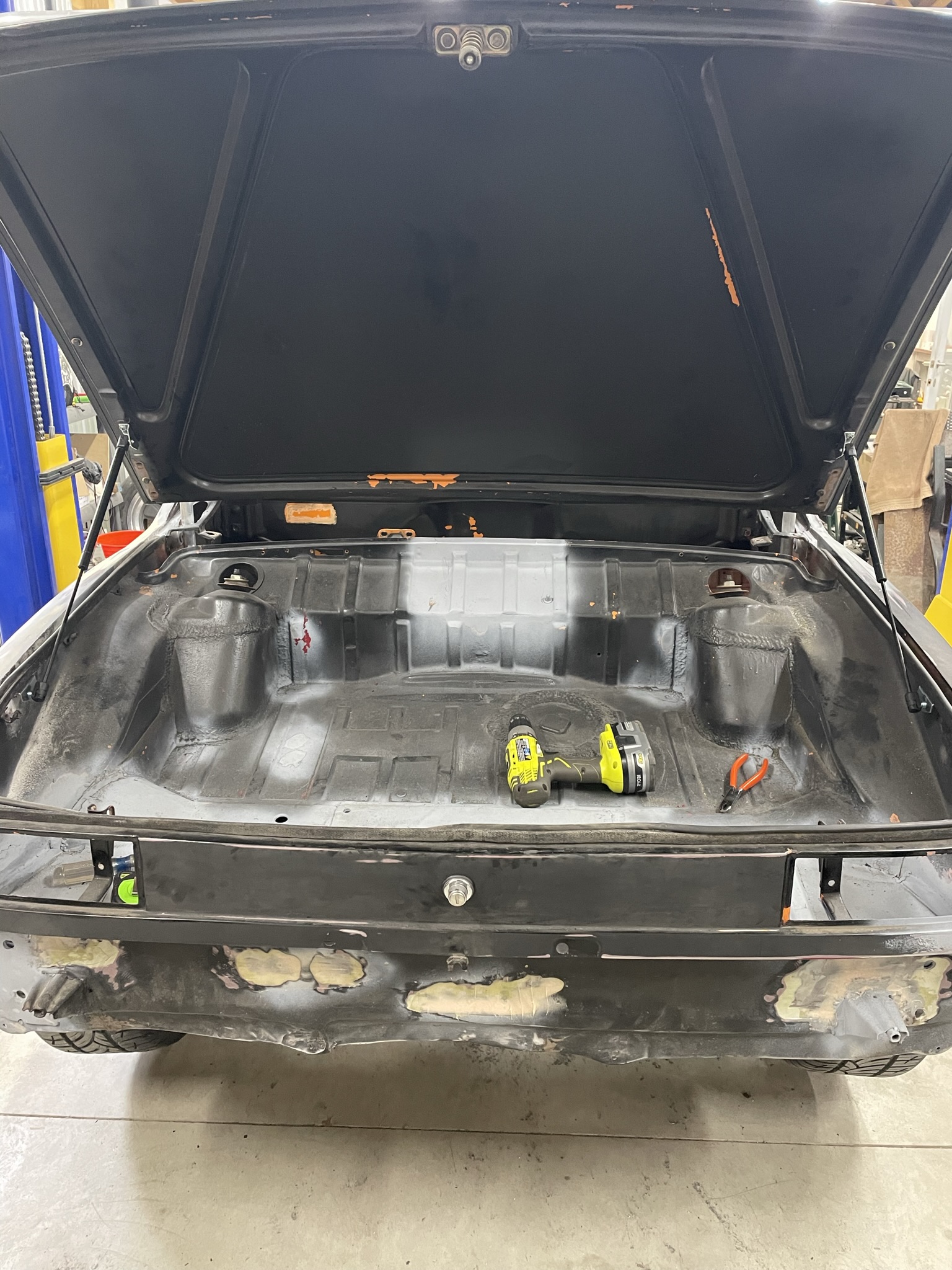

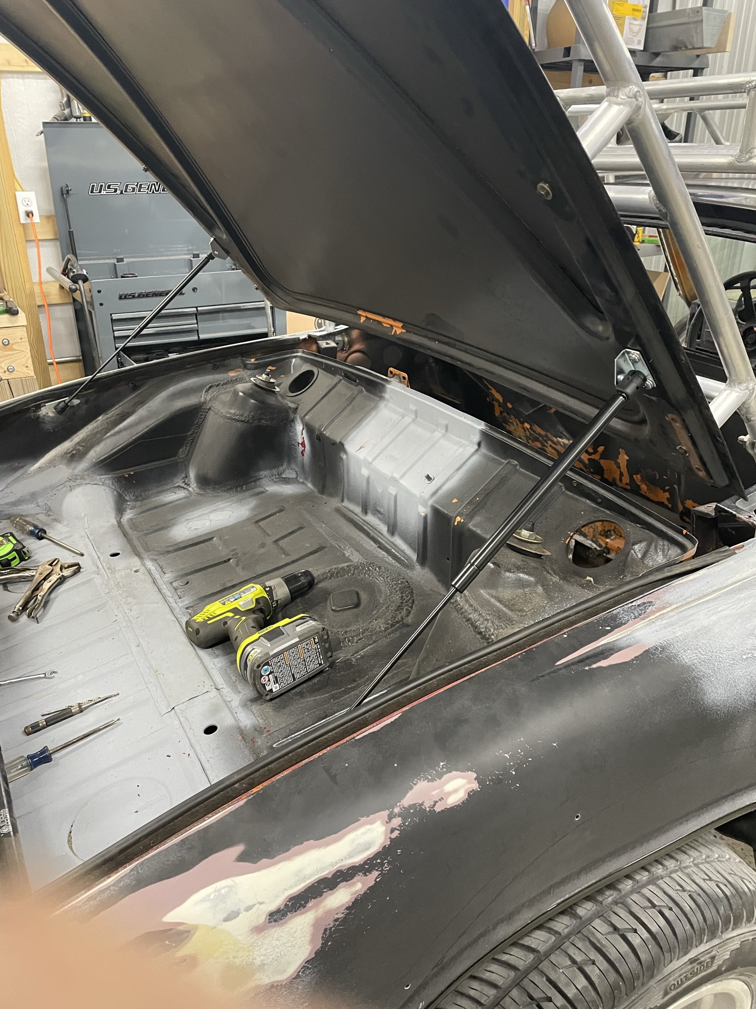

Installed gas struts for the rear trunk today. They lift the trunk lid and the rack just fine.
