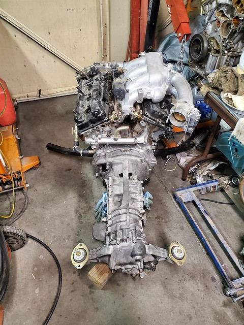

So it started as a simple MIA (Mosquito Involved Absence) from the N6 engine rebuild, which lasted into winter, so I moved to backyard projects cuz that’s where the sun shines making it reasonably warm. Also includes some much overdue house projects but unfortunately this year had uncooperative weather so even those are behind schedule.
But in March I had some random downtime, and a need to make room in the garage, so I decided to install the mockup VQ35 with the 914 trans.
(IMG:http://www.914world.com/bbs2/uploads_offsite/live.staticflickr.com-431-1681085648.1.jpg)
Begin plot twist...
