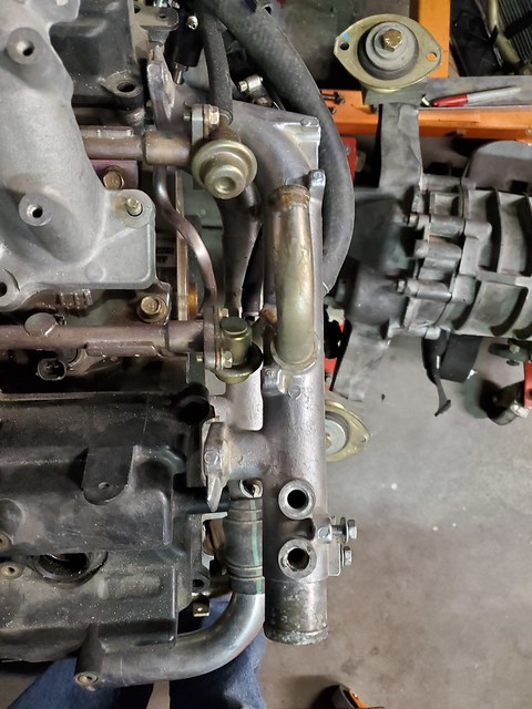

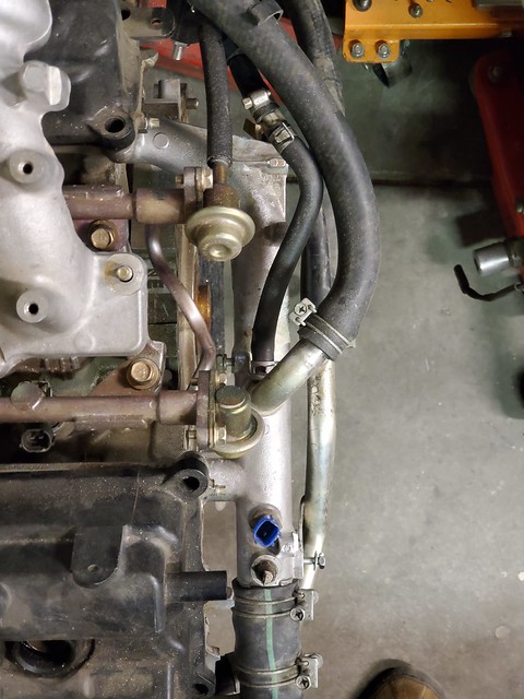

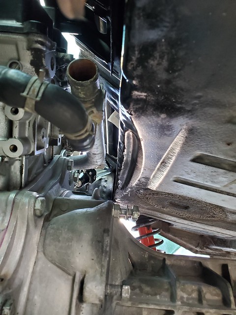

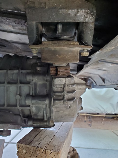

Three decisions were then made. One, I’d like to swap in a WRX trans as I’d like 300+hp with no worries. Subaru Diff is 1.5” closer to the engine compared to the 914, and with the VQ30 I used RH spacers to move it FORWARD 1.25”, so repositioning the drivetrain is necessary, which leads to 2. The VQ35 VCT gears add 1.5” to the front of the motor, which would not be a problem if I moved it back to stock location. Plus I'd prefer to keep it for it’s benefits.
Step one: Can I clock this heater coolant tube at the rear of the engine?
(IMG:http://www.914world.com/bbs2/uploads_offsite/live.staticflickr.com-431-1681085672.1.jpg)
Yes! (IMG:style_emoticons/default/biggrin.gif)
(IMG:http://www.914world.com/bbs2/uploads_offsite/live.staticflickr.com-431-1681085672.2.jpg)
Step two: Install drivetrain
(IMG:http://www.914world.com/bbs2/uploads_offsite/live.staticflickr.com-431-1681085672.3.jpg)
(IMG:http://www.914world.com/bbs2/uploads_offsite/live.staticflickr.com-431-1681085672.4.jpg)
(IMG:http://www.914world.com/bbs2/uploads_offsite/live.staticflickr.com-431-1681085673.5.jpg)

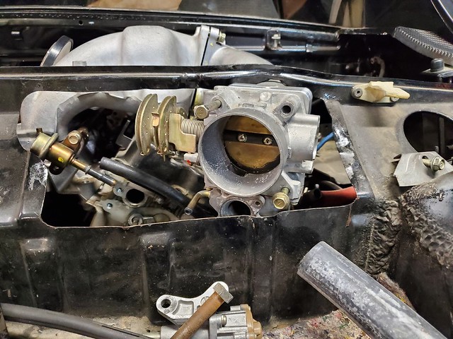

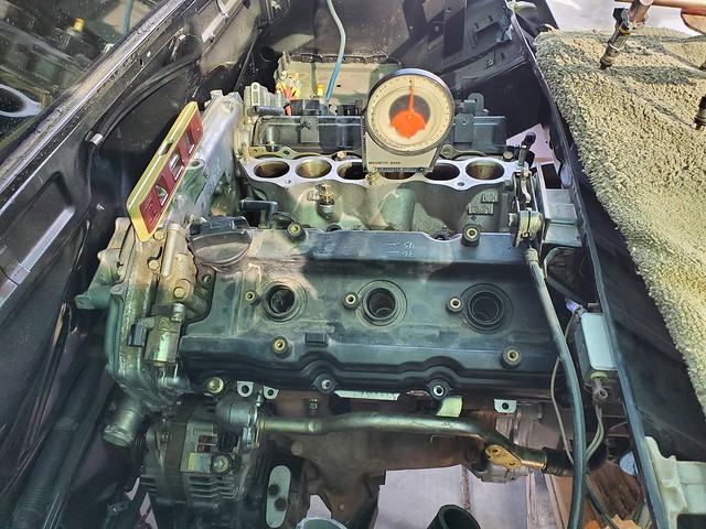

Decision three, the VQ35 intake as is hits the trunk lid if I use the VQ30 conv bits and that is no bueno.
(IMG:http://www.914world.com/bbs2/uploads_offsite/live.staticflickr.com-431-1681085673.6.jpg)
