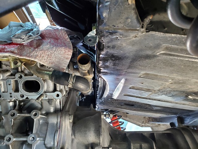

914 trans moves rearward 1”.
(IMG:http://www.914world.com/bbs2/uploads_offsite/live.staticflickr.com-431-1681085689.1.jpg)
(IMG:http://www.914world.com/bbs2/uploads_offsite/live.staticflickr.com-431-1681085689.2.jpg)

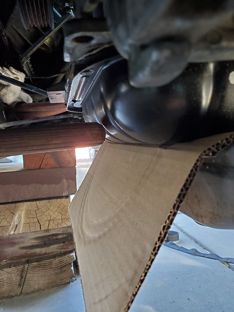

Oil pan sits 3/4” below the floorpan – similar to the VQ30.
(IMG:http://www.914world.com/bbs2/uploads_offsite/live.staticflickr.com-431-1681085689.3.jpg)

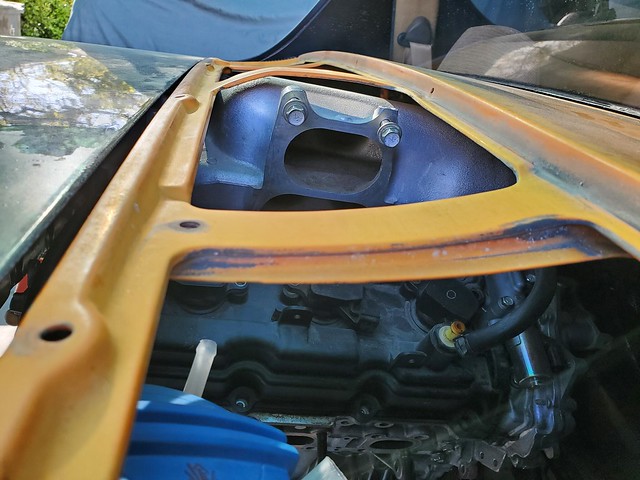

The engine lid will get a minor beauty hump.
(IMG:http://www.914world.com/bbs2/uploads_offsite/live.staticflickr.com-431-1681085689.4.jpg)

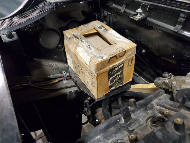

The custom intake extension/MAF/filter box will go where the battery sits.
(IMG:http://www.914world.com/bbs2/uploads_offsite/live.staticflickr.com-431-1681085689.5.jpg)

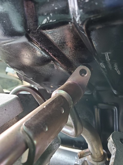

Trunk will get a removable cover panel to clear the fuel rail.
(IMG:http://www.914world.com/bbs2/uploads_offsite/live.staticflickr.com-431-1681085690.7.jpg)
