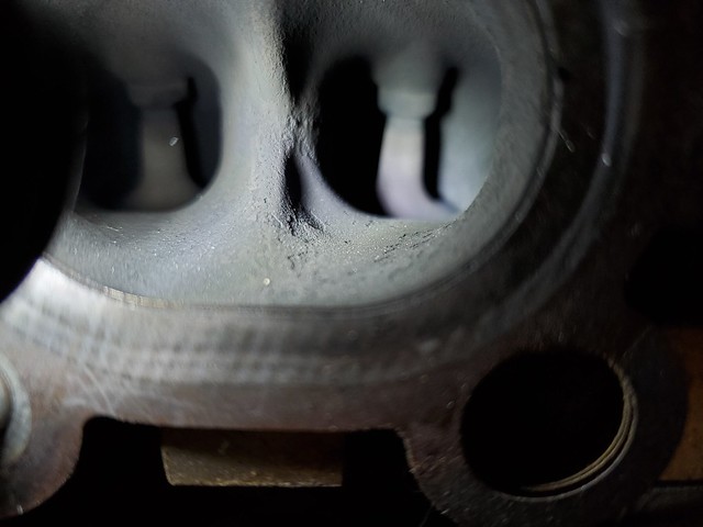

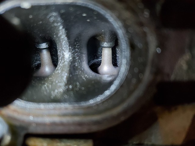

That’s a lot of work to be done, and I’m still paying insurance, so I looked more into the VQ30 cooling issue.
One of the exhaust ports looks different... (IMG:style_emoticons/default/idea.gif)
(IMG:http://www.914world.com/bbs2/uploads_offsite/live.staticflickr.com-431-1681085717.1.jpg)
(IMG:http://www.914world.com/bbs2/uploads_offsite/live.staticflickr.com-431-1681085717.2.jpg)
So the plan when I get caught up is to pop the heads off and if it’s an easy head gasket fix, I’m putting the 3.0 back in.
