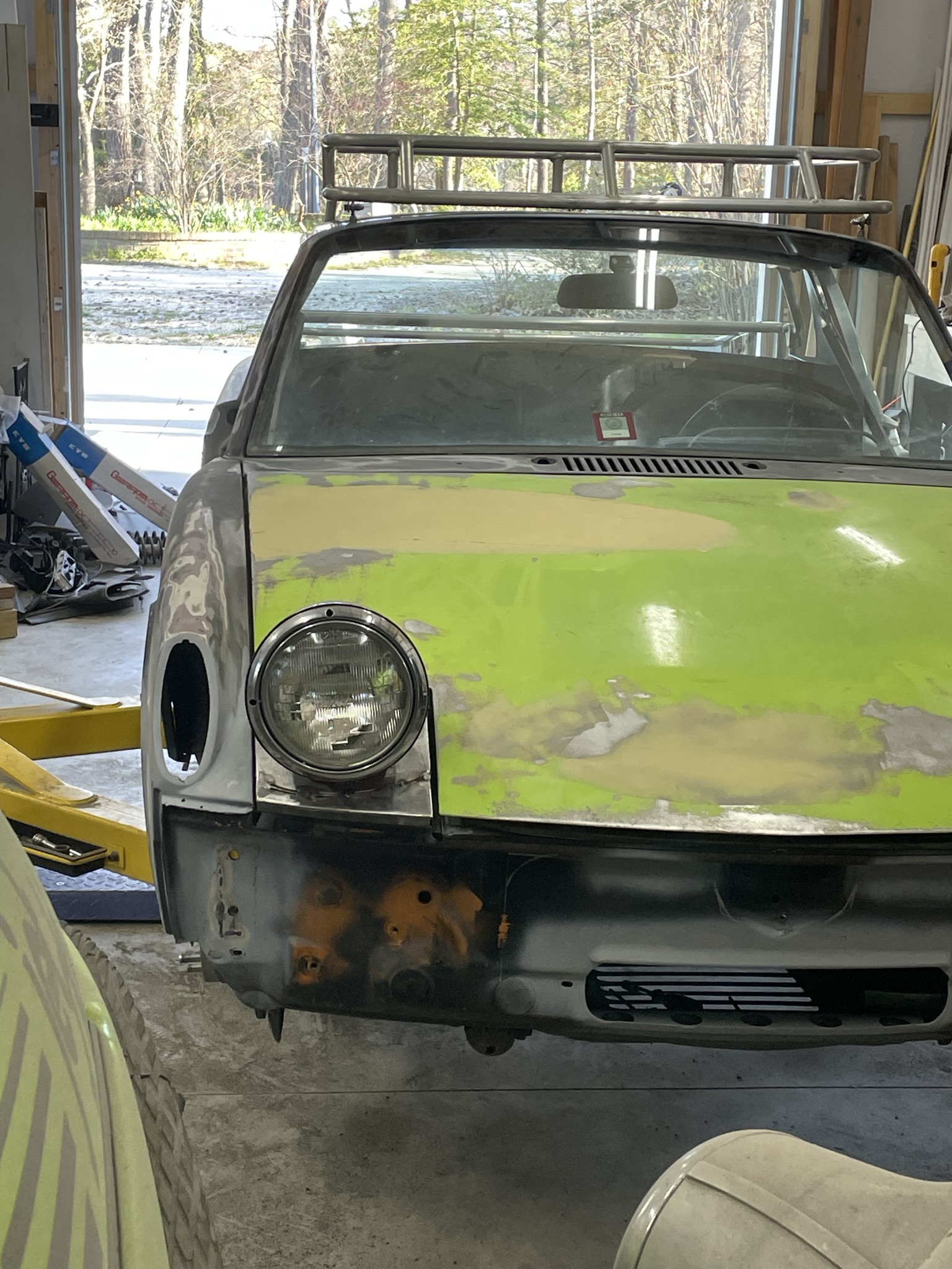

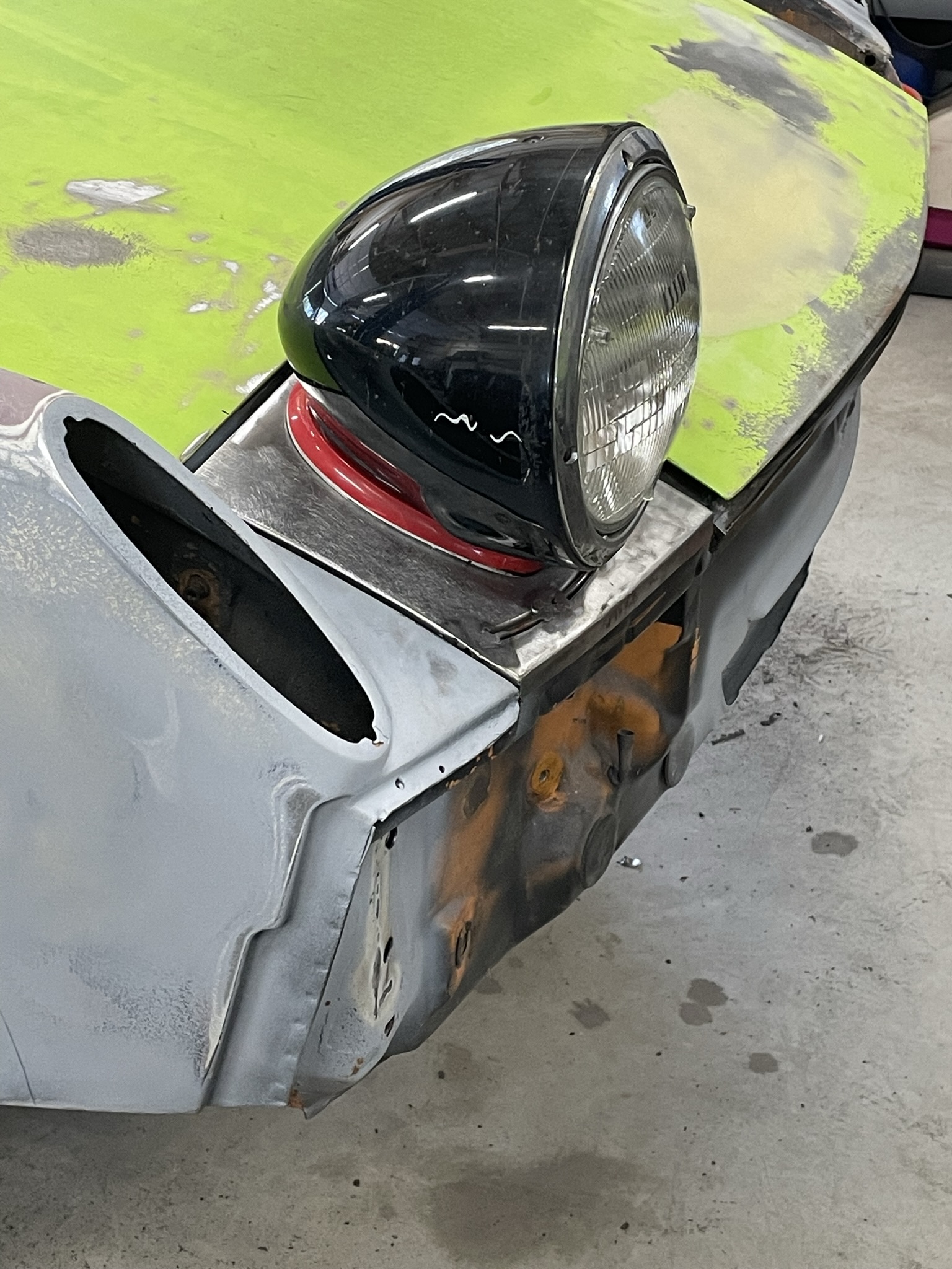

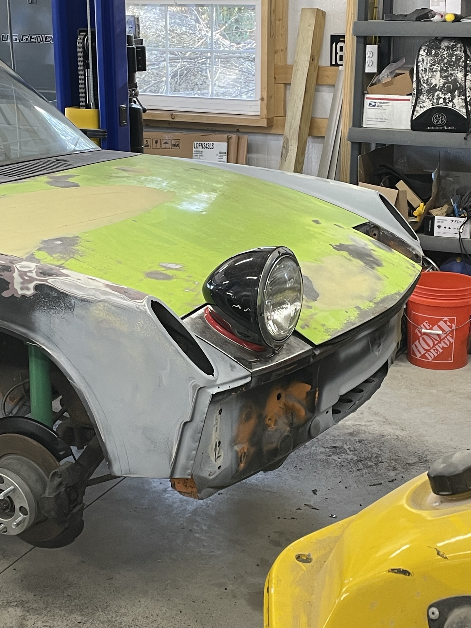

Decided to go with something different for my headlights. I’m using heavily modified 928 headlights in a fixed position. I made a support frame that goes below the 914 headlight doors and incorporated the eyebrow into the door. Still need to do a little finishing work, and the repeat for the passenger side, but I thought I’d share the progress…..

East coaster   Decided to go with something different for my head...   Apr 10 2023, 07:41 PM
brubou   Forget Cibie's!!! Mount a couple 9...   Apr 10 2023, 08:30 PM
Retroracer   Cool idea with the fixed 928 headlight buckets. C...   Apr 11 2023, 08:43 AM
East coaster   A few detail pics of headlight framing…..   Apr 11 2023, 08:07 PM
East coaster   More….   Apr 11 2023, 08:08 PM
