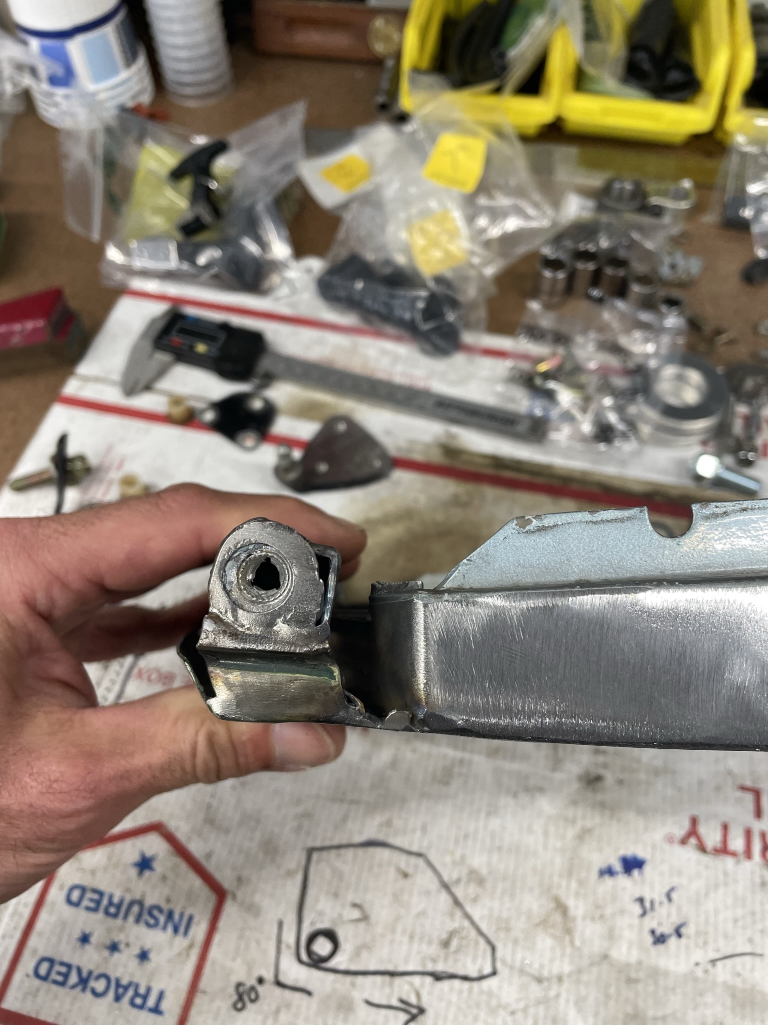

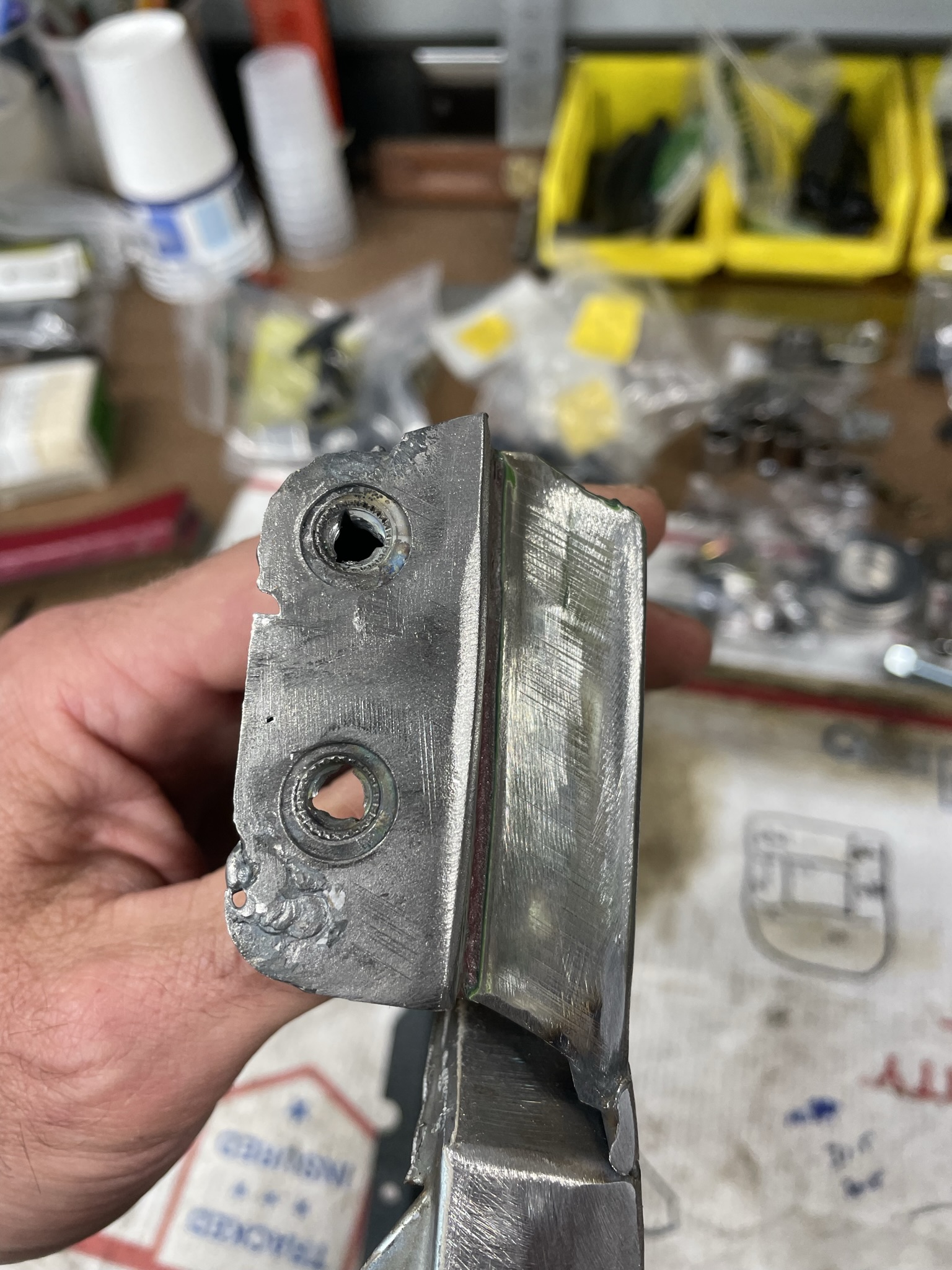

East coaster   Then it was on to rear trunk hinge pivots. The dri...   Mar 23 2023, 06:58 PM

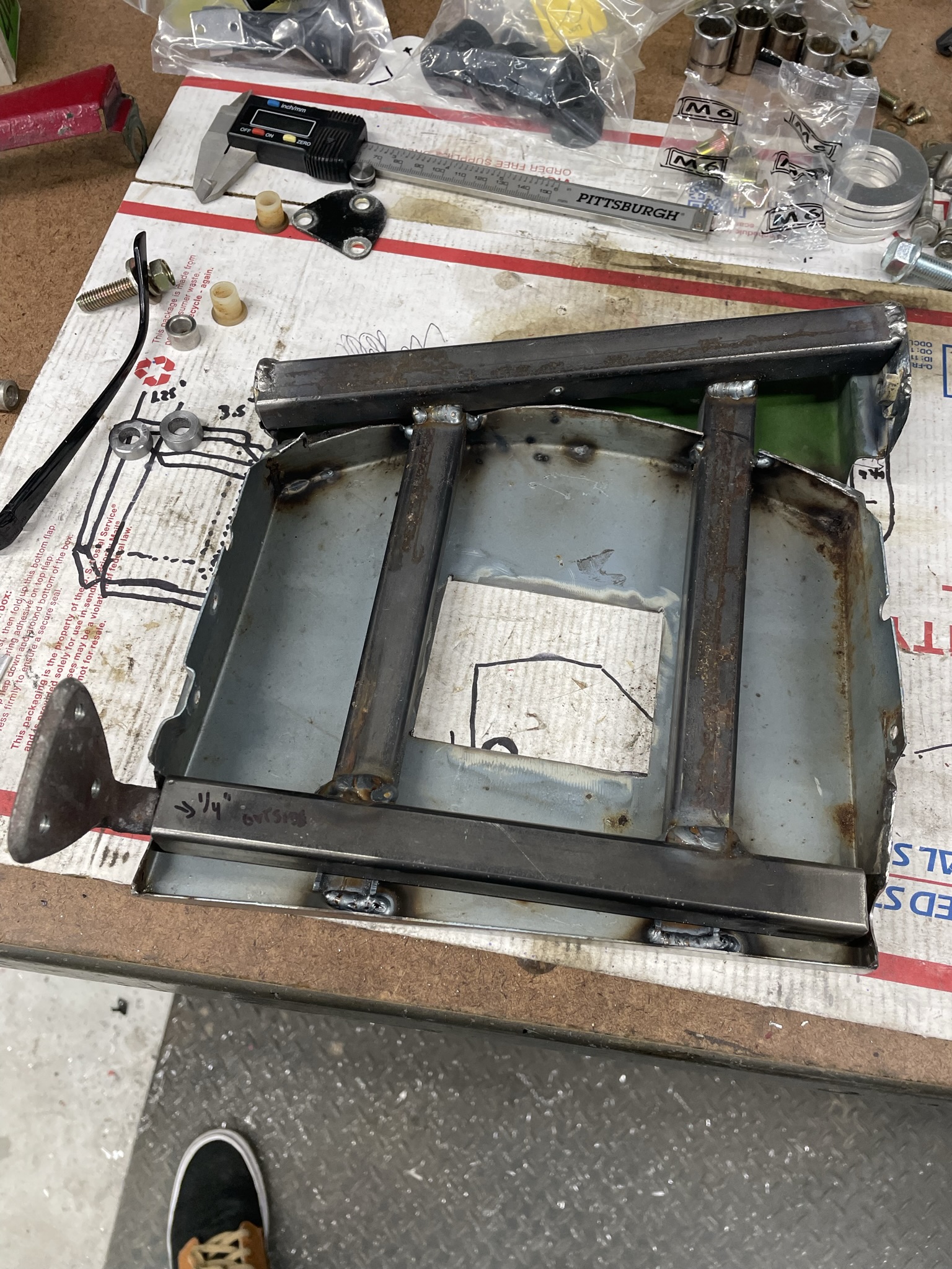

East coaster   Tackled the battery tray next. Although I’m doin...   Mar 24 2023, 05:28 AM
