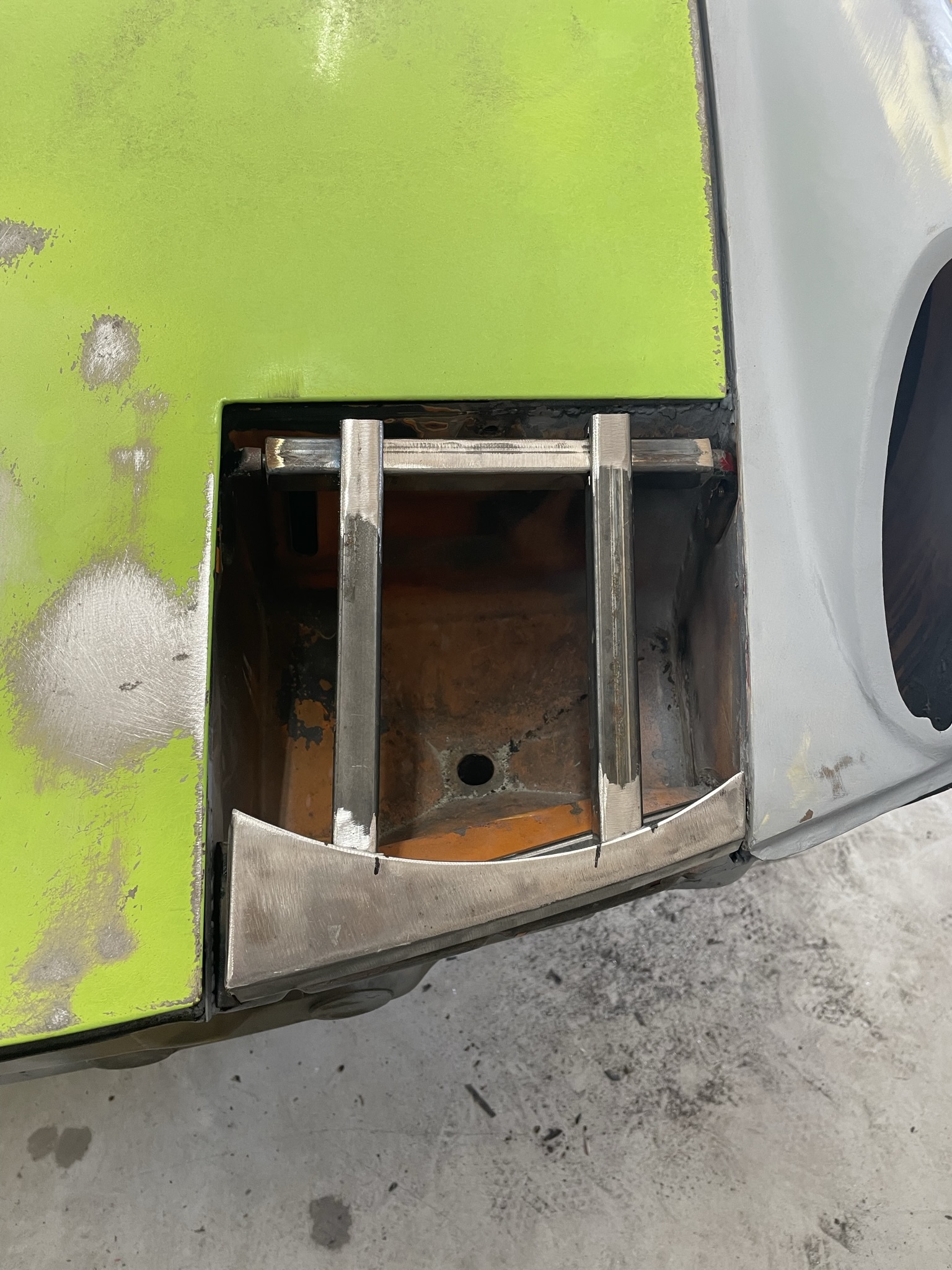

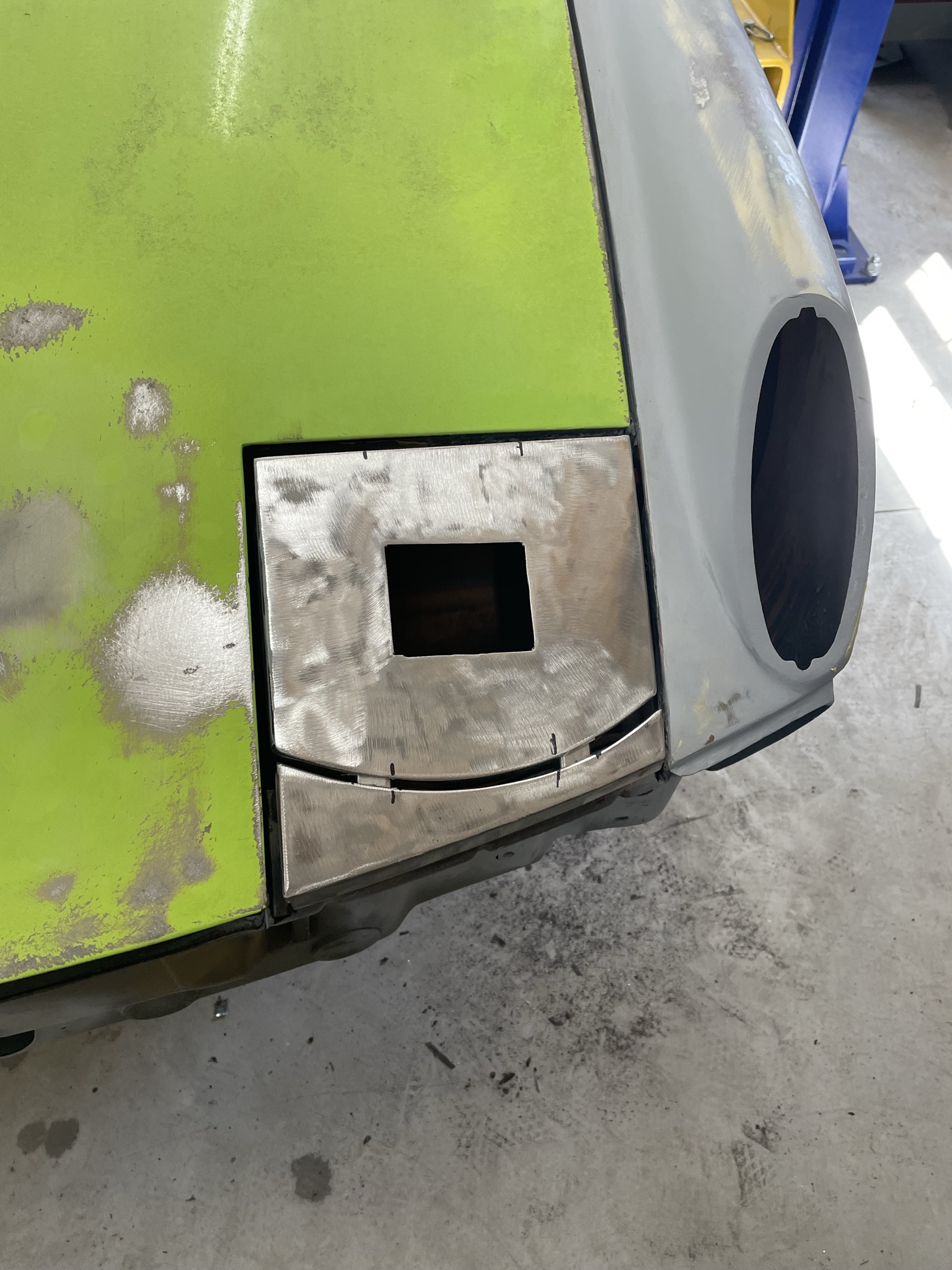

East coaster   Decided to go with something different for my head...   Apr 10 2023, 07:41 PM
brubou   Forget Cibie's!!! Mount a couple 9...   Apr 10 2023, 08:30 PM
Retroracer   Cool idea with the fixed 928 headlight buckets. C...   Apr 11 2023, 08:43 AM
East coaster   A few detail pics of headlight framing…..   Apr 11 2023, 08:07 PM
East coaster   More….   Apr 11 2023, 08:08 PM
