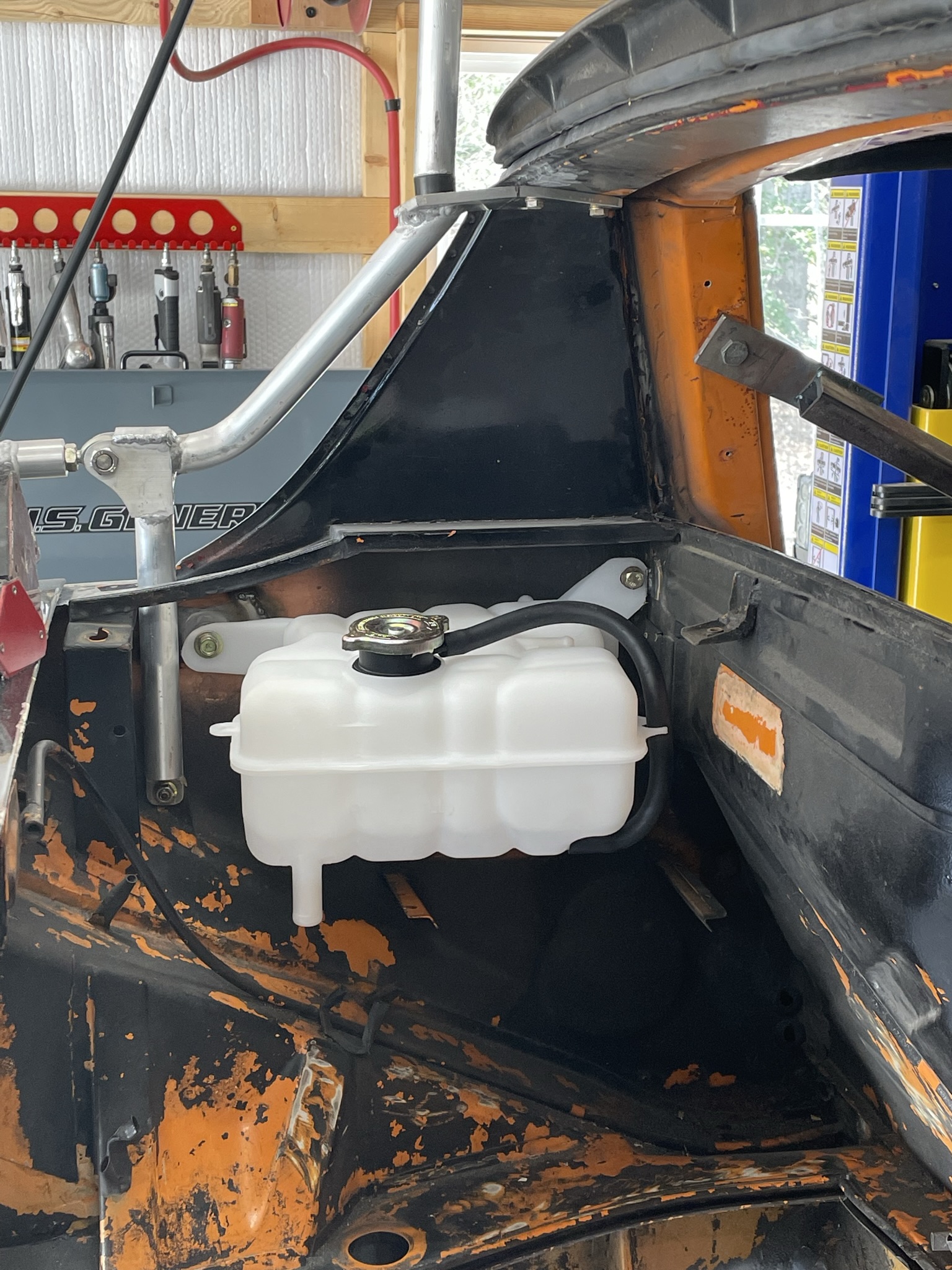

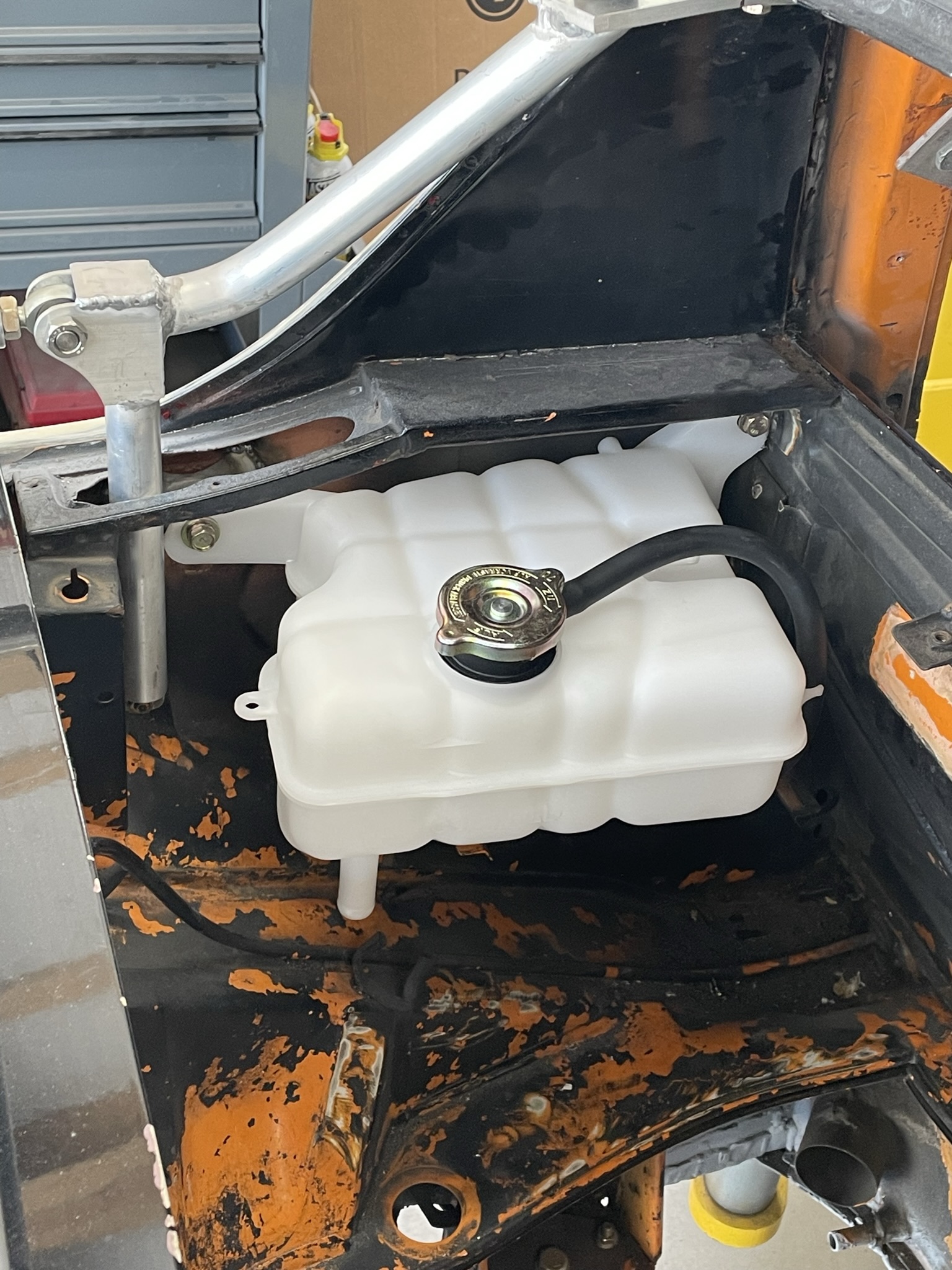

Got the mounts figured out for my coolant expansion/reservoir and test fit the tank…..looks like it belongs there. Unseen in the pics is a 3/8” post the tank slides onto at the bottom.
