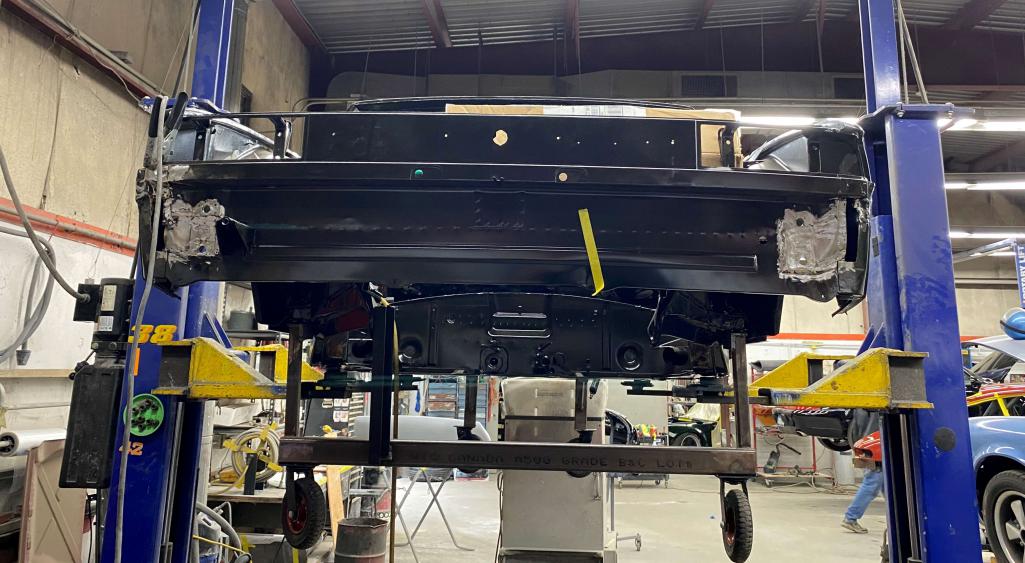

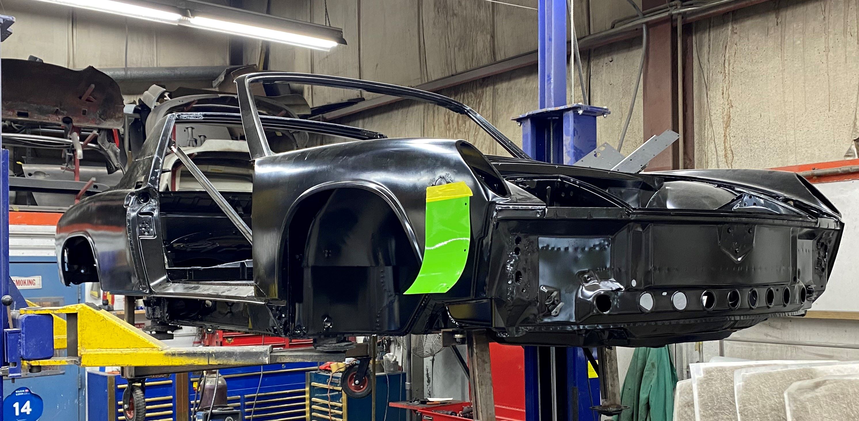

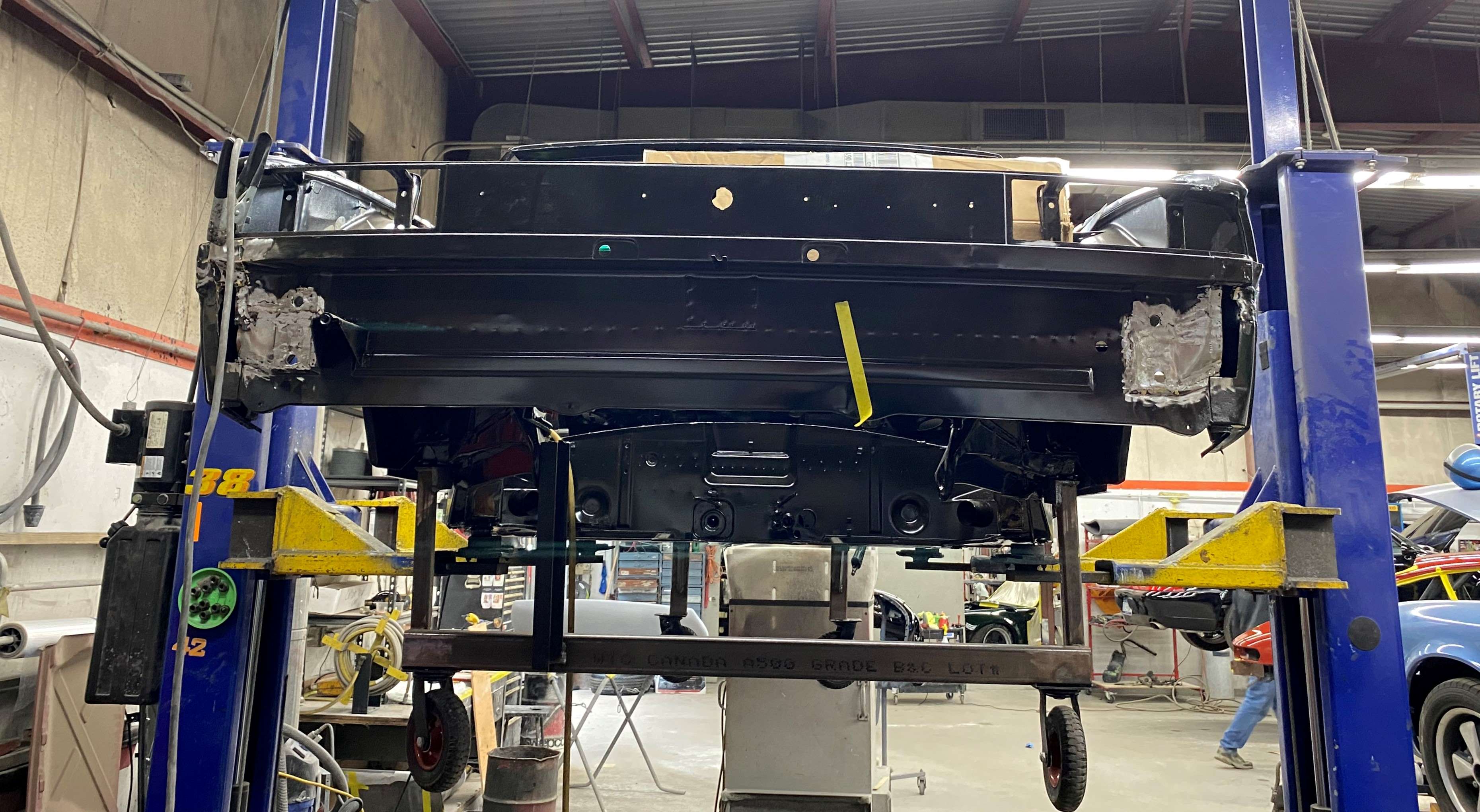

Update - The car was delivered to Auto Associates last week along with the chassis stiffening kits and bulkhead motor mount from Mad Dog. First up will be rust repair. This will be followed the GT chassis stiffening and GT mods with the exception of body panels and flares. The plan is for the car to come back to me for mechanical and electrical reassembly before installation of the doors and flares and final paint. Ken (co-owner and Body Shop Manager) would prefer to have wheels and tires mounted to properly install the flares. He also prefers to have the chassis weighted with gearbox and engine to set the door gaps.

Tom1394racing   Update - The car was delivered to Auto Associates ...   Apr 18 2023, 12:54 PM
Tom1394racing   The rust repair has started with removal of the ru...   Apr 18 2023, 01:07 PM
