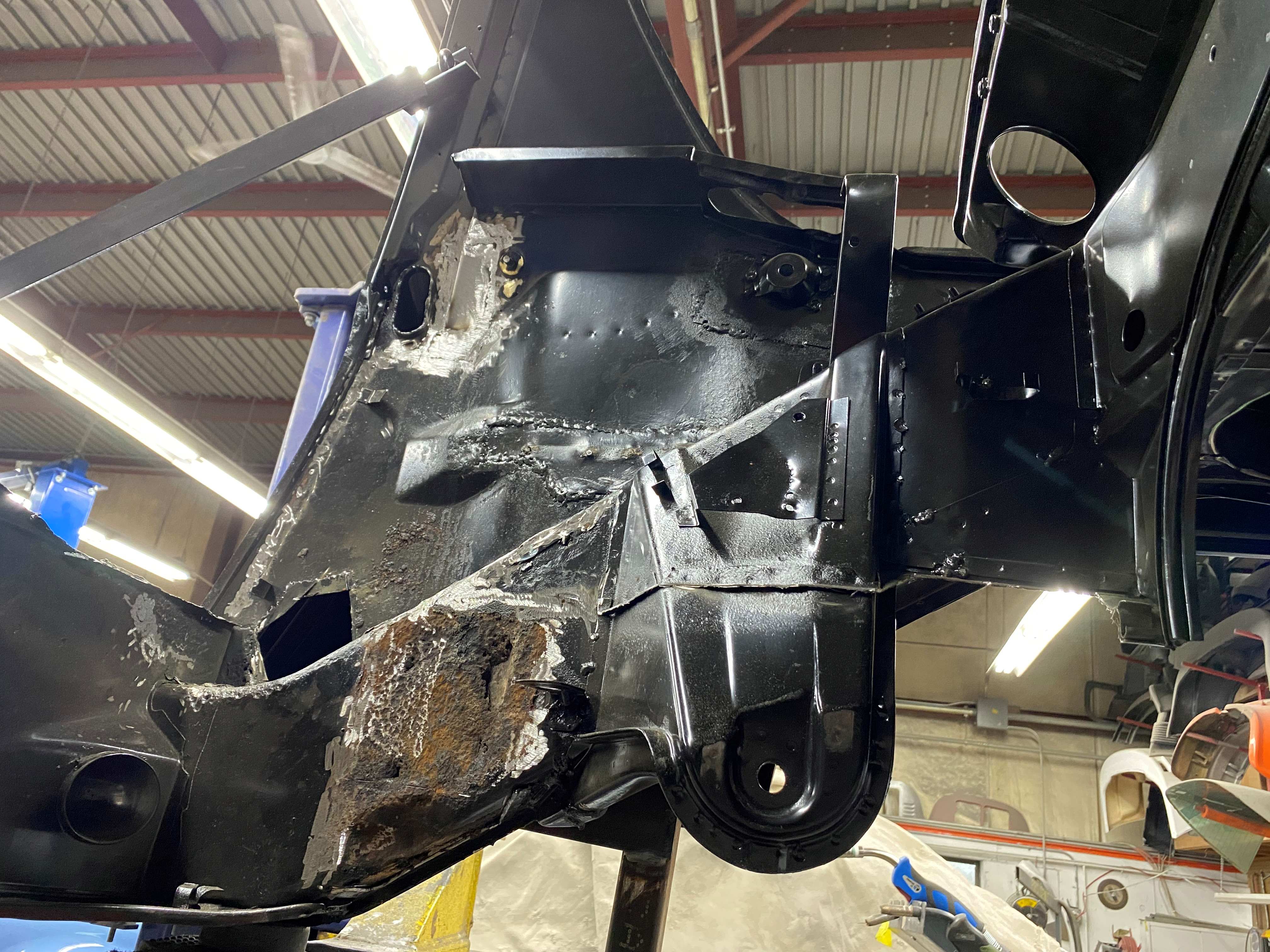

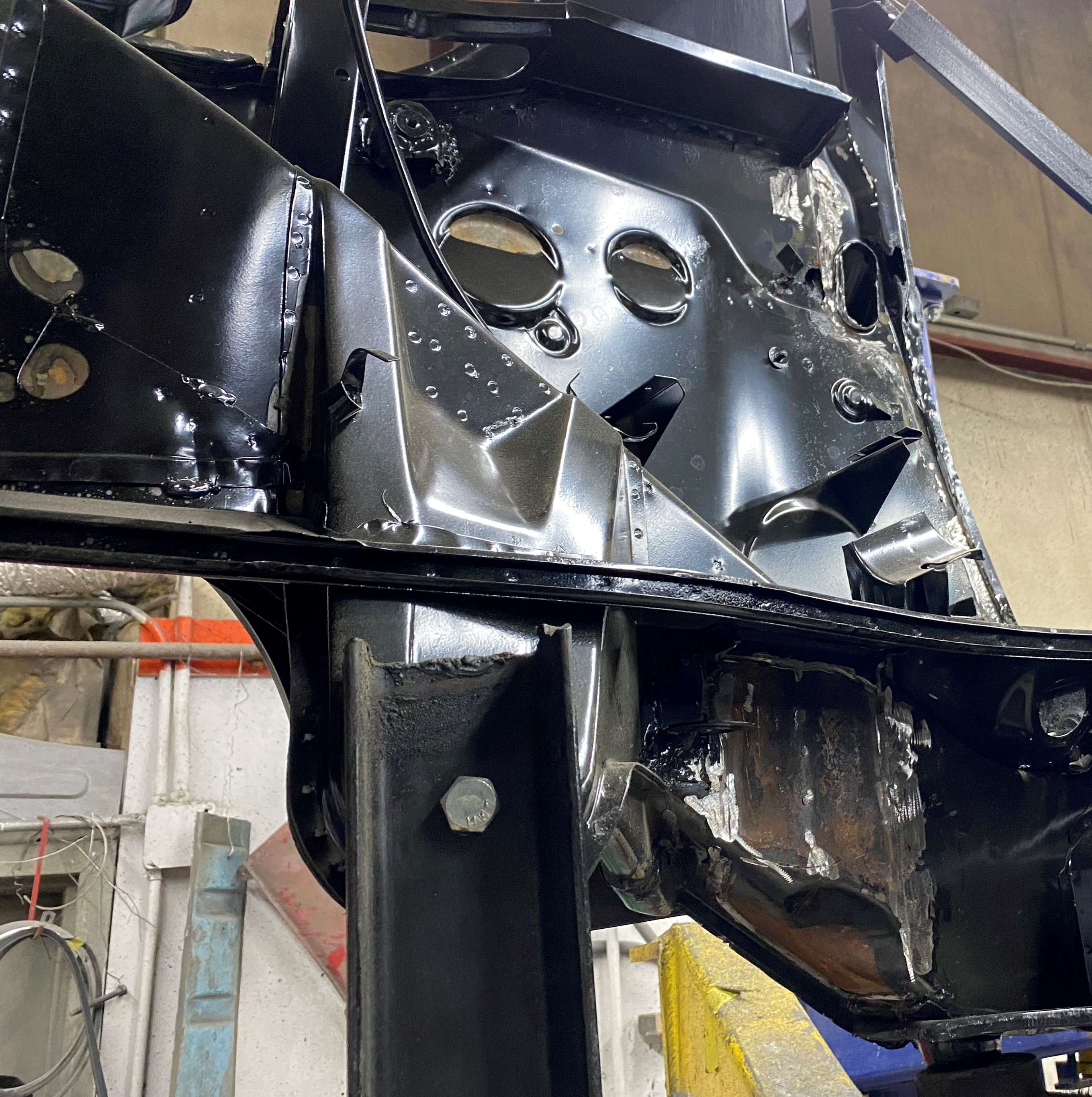

Tom1394racing   Here are some examples of the nasty hidden sins th...   Feb 28 2023, 04:02 PM

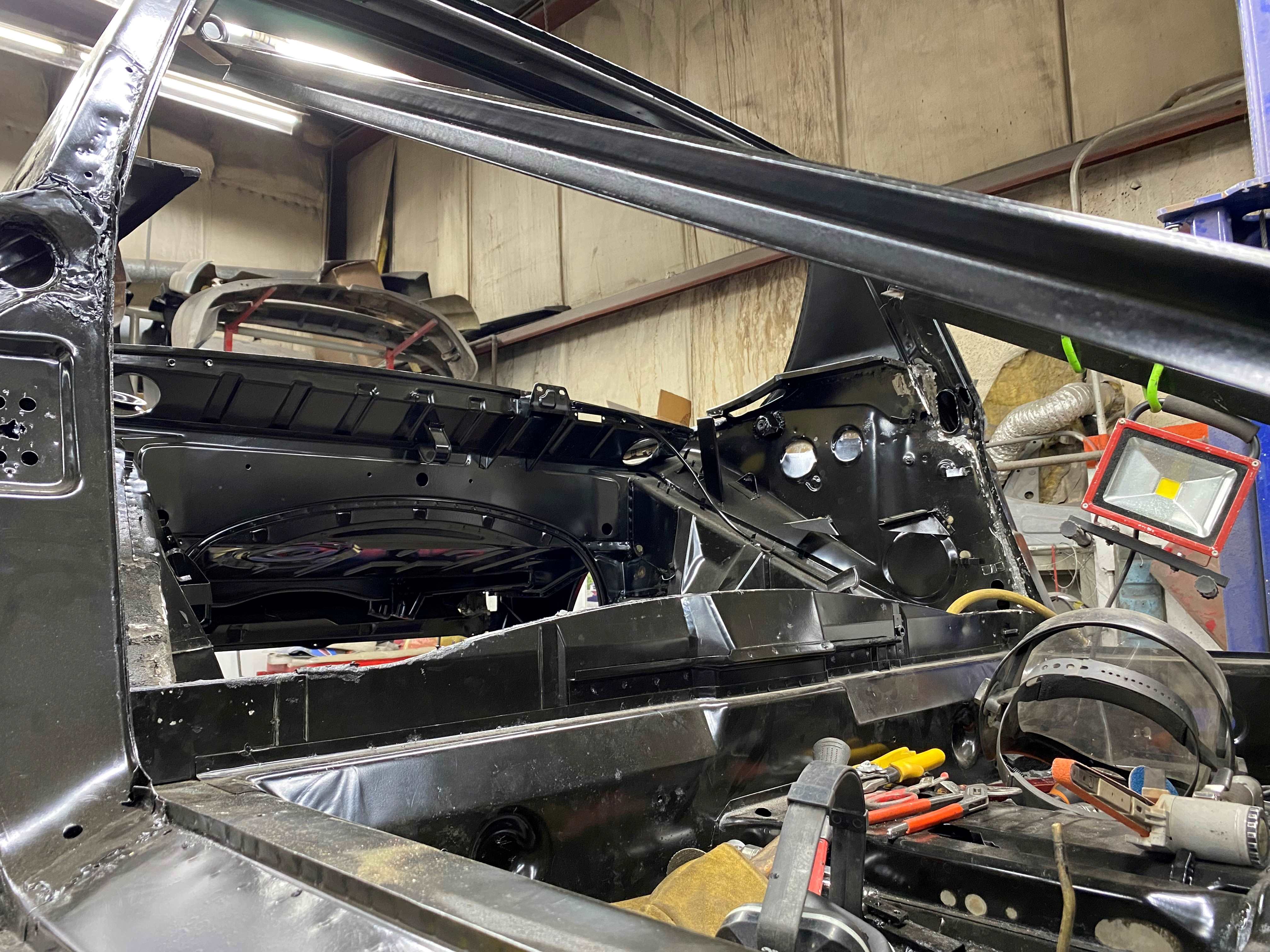

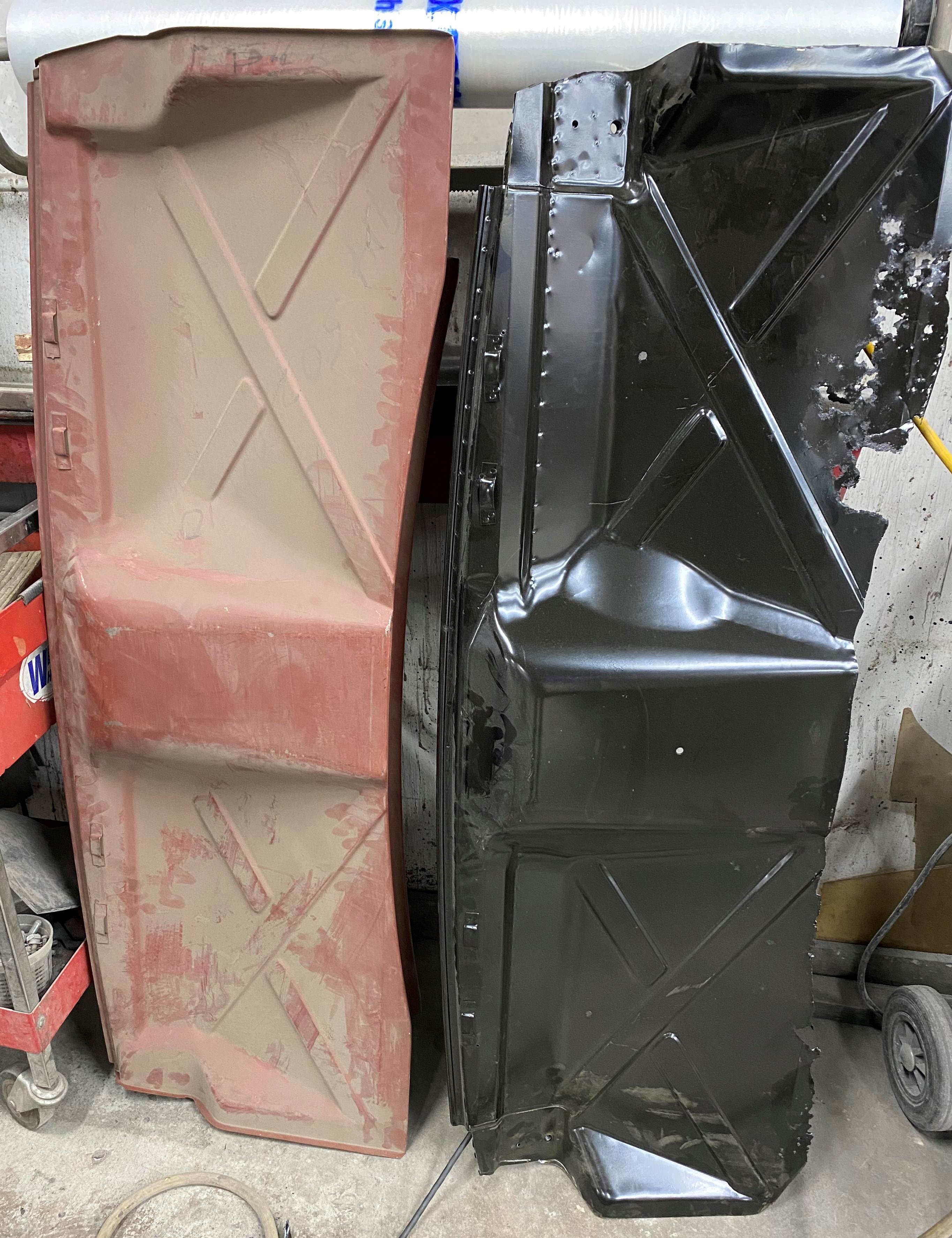

Tom1394racing   Update - The car was delivered to Auto Associates ...   Apr 18 2023, 12:54 PM
Tom1394racing   The rust repair has started with removal of the ru...   Apr 18 2023, 01:07 PM
