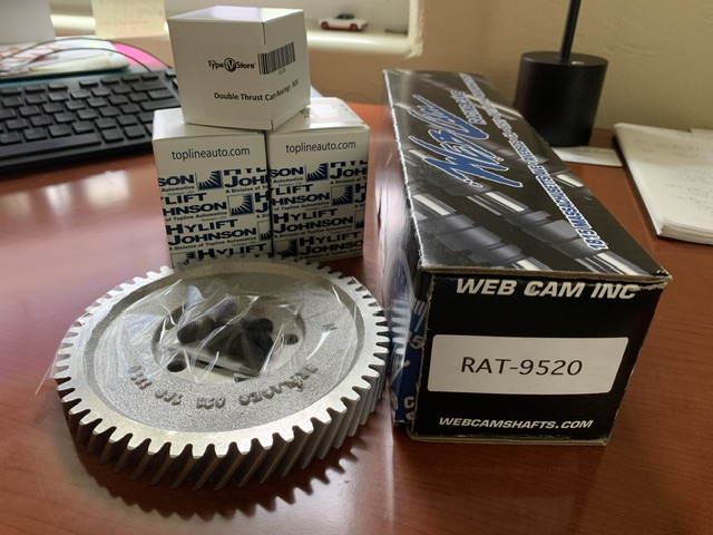

seanpaulmc
post Apr 26 2023, 04:14 PM
Posts: 470
Joined: 6-December 16
From: Orlando, FL
Member No.: 20,649
Mmmmmm parts!
Had to share my excitement.
