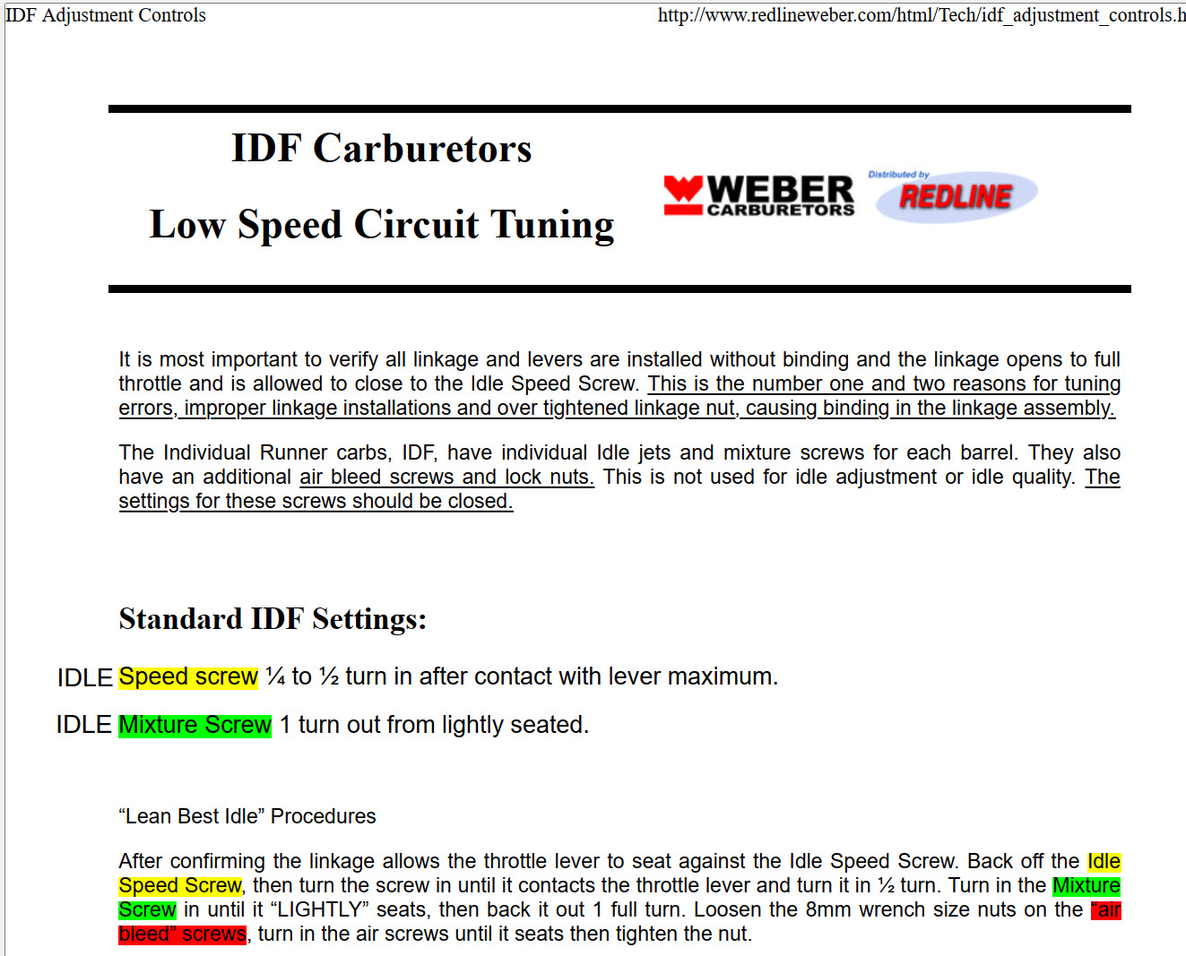

Found some time last nite and I re-assembled the carbs and set the screws as recommended in the Weber set up document. One thing I did notice is that the AIR BLEED SCREWS, marked red below, were NOT SEATED.
They were 2 maybe 3 turns OUT. all 4 were that way. I don't remember doing that, but I am sure I did.
Wouldn't more air call for more fuel? So maybe this had something to do with my Super Rich situation?

Superhawk996   Good find. Usually you’ll only have 1 air bleed...   May 3 2023, 08:19 AM

rhodyguy   Tomlinsons Weber book p.22 ….’pre-set your air...   May 3 2023, 02:38 PM
malcolm2   Tomlinsons Weber book p.22 ….’pre-set your ai...   May 4 2023, 12:14 PM
nditiz1   Tomlinsons Weber book p.22 ….’pre-set your a...   May 4 2023, 04:44 PM
malcolm2   [quote name='malcolm2' post='3075791' date='May 4...   May 4 2023, 07:35 PM
